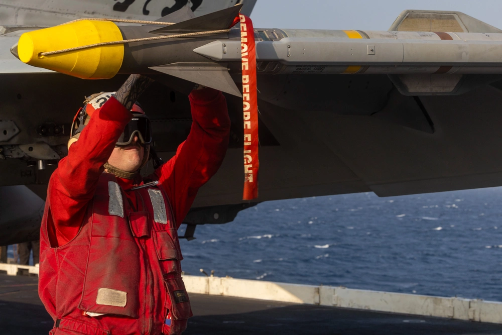

USS Carl Vinson, December 2024
Some red streamers can be noticed as well…

Thanks for the pics
The first one I haven’t seen but it looks like one I have for the Eisenhower where the planes are parked like this on a “no fly” day. I would guess that on normal flight operation days they are left off since the planes on deck are basically on alert.
