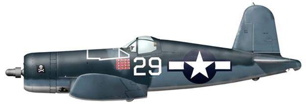

Start with time period. The standard paint scheme changed over time.
Then like tank stated, look at squadron.

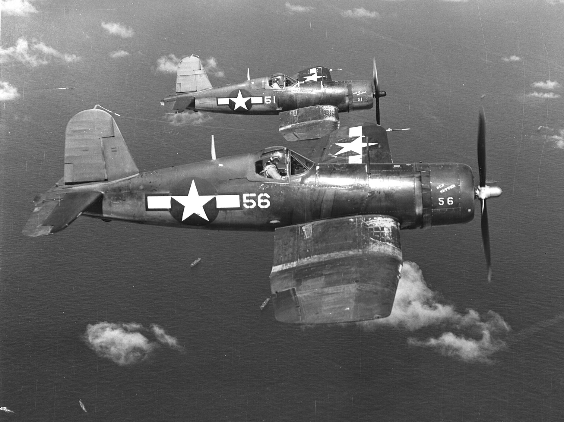

This is an early “bird cage” version. Notice the two tone color and type of national insignia.

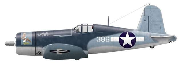

Later 3 tone color scheme and national insignia.

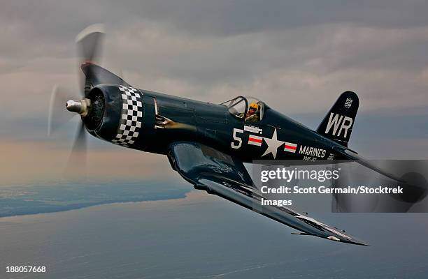

Still later.

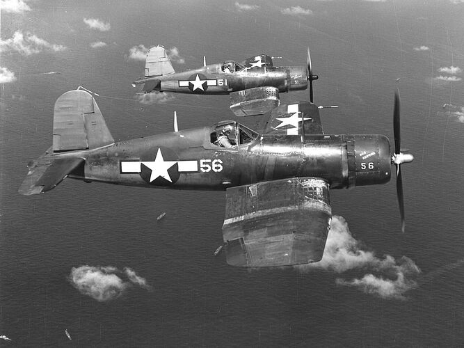

Late war

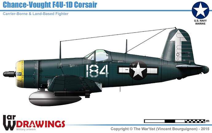

And in the Korean war.
