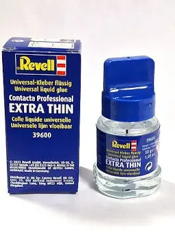

This is a different Revell liquid cement very similar to Tamiya Extra Thin. It comes with a brush not with a needle.
Different picture, there’s a couple pictures of Revell Extra Thin.
Saw a review of this on YouTube, it said it works just as well as Tamiya but has a bigger brush so not so easy to apply in small quantities.
