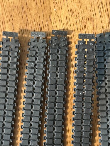

I recall seeing that the M109A7, AMPV, and Bradley share a track set. So, check for someone with rubber bands and do a test fit, or see if AFV Club or whomever has a test package of “some assembly required.”
The korean K9 uses thesame tracks and academys K9 has one piece tracks
Are we sure the Korean K9 uses T161 tracks and not something really familiar? It would be great, but it seems like it would be too coincidental.
Im sure
The Korean K9 uses a similar track, but they are not T161 tracks. The pads are different as are the center guide teeth. They look close and will do if you have to have rubber band tracks, but they are not actual T161 tracks.
Here’s a thought:
Jacques’ track compared to K9 track. The guidee horns are indeed different. There were two solutions - cut one off of each pair, or bend them together and glue them together. The looked very close to the open guide horns - even had a little divot at the top
Back when I first suggested using the K9 track I was going to Korea regularly and picked up a bunch of extra. I still have several lying about.
