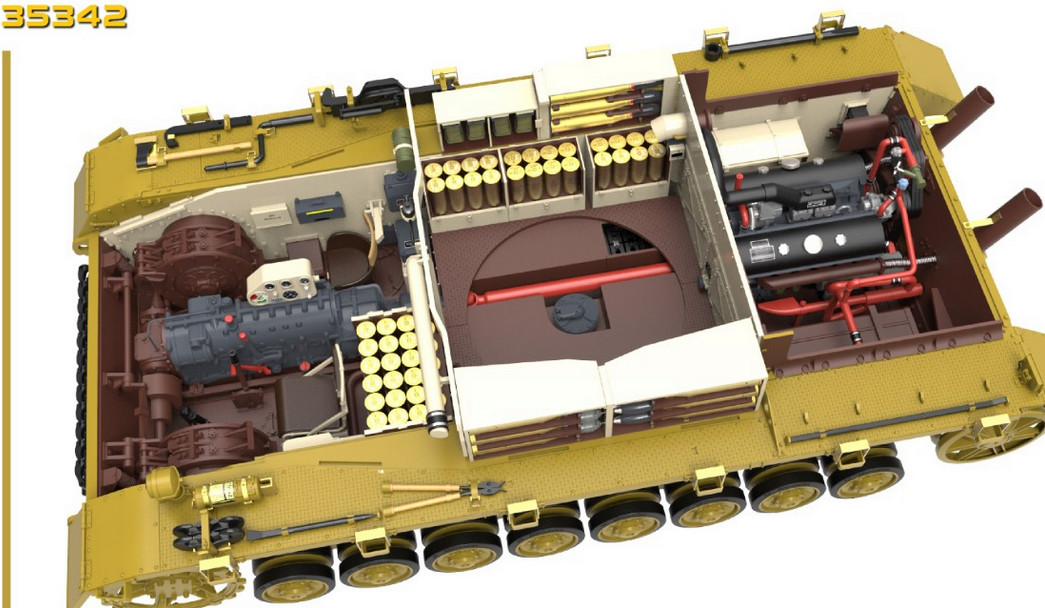

I’m working on the RFM Panzer. A question about the ‘boxes’ they keep the shells in. Along one side are 3 boxes. I can either make them open or closed. Open of coarse because I want to see/display the shells. So my question is. Where do the lids for these boxes go? Are they simply swung up and open? Or are they stored somewhere? I see pictures with them closed and pictures with them open. But all the open pictures show now lids.
The pictures are of the Miniart version but same issue.
The ammunition locker lids are hinged with piano style hinges between the flat panels and fold flat. I guess the crew stashed them somewhere as out of the way as possible.

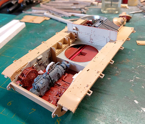

A couple of where I’m at !! I’m working my way forward and skipping around the instructions a bit.
Nice to see, the detail in the kit is far superior to the Trumpeter 1/16th offerings

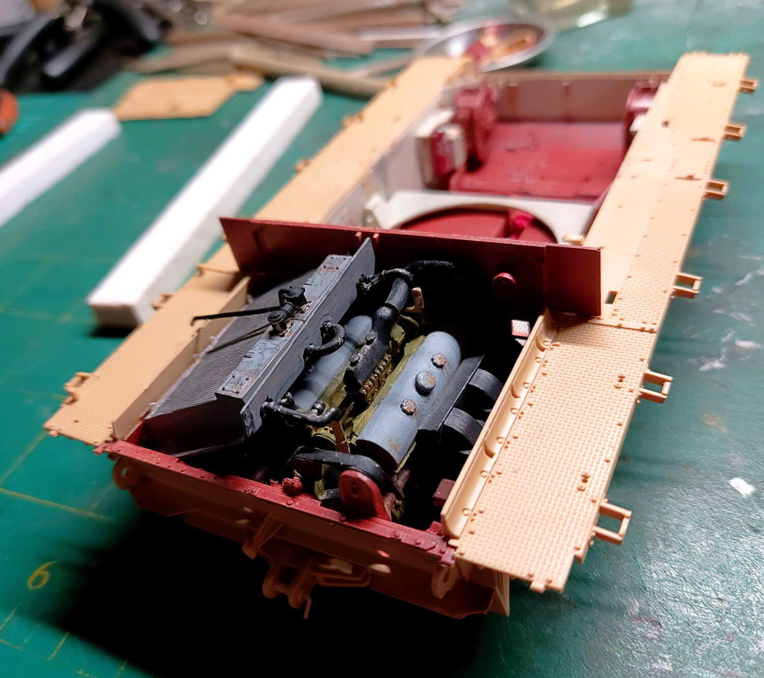

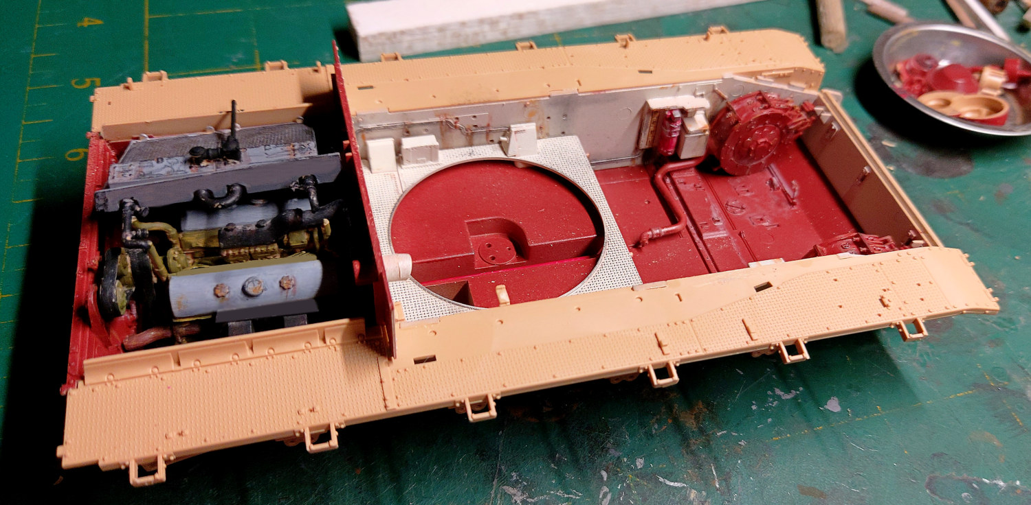

A few progress shots.
Colour has been an issue as I’ve seen several variations. So here’s my version.
It’s been a great build so far. A couple of ‘ooops’ moments when the instructions weren’t that clear and I choose the wrong guess.
Parts are a tight fit which is good and bad. Every thing is loose fitted so I can take it all out to spray the outside.
