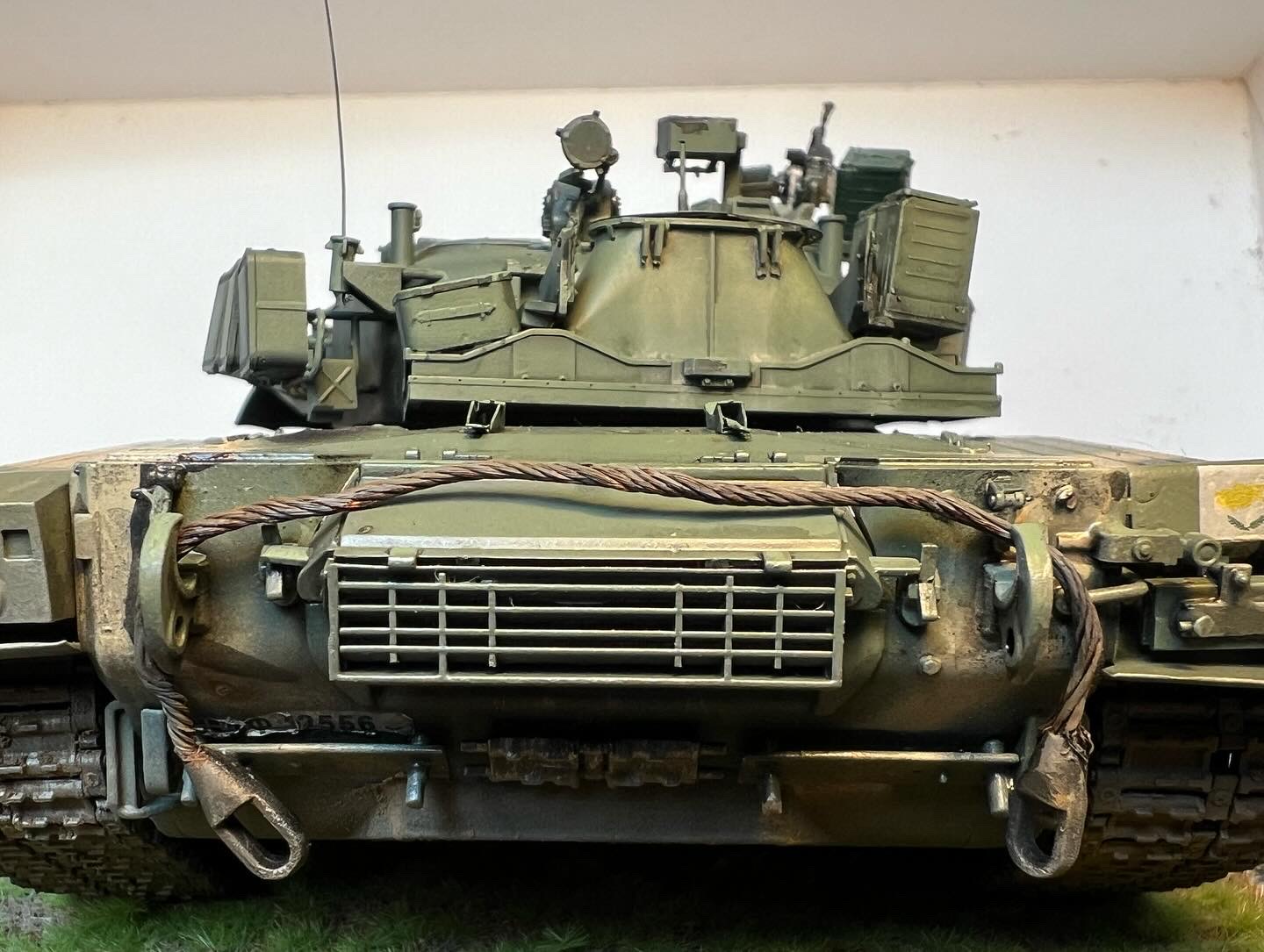

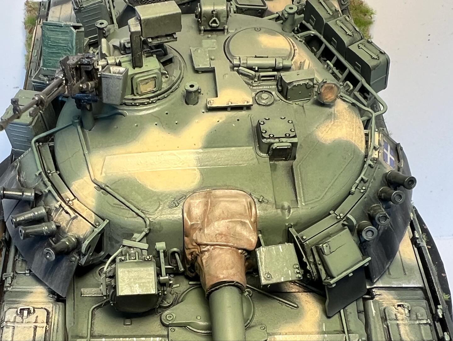

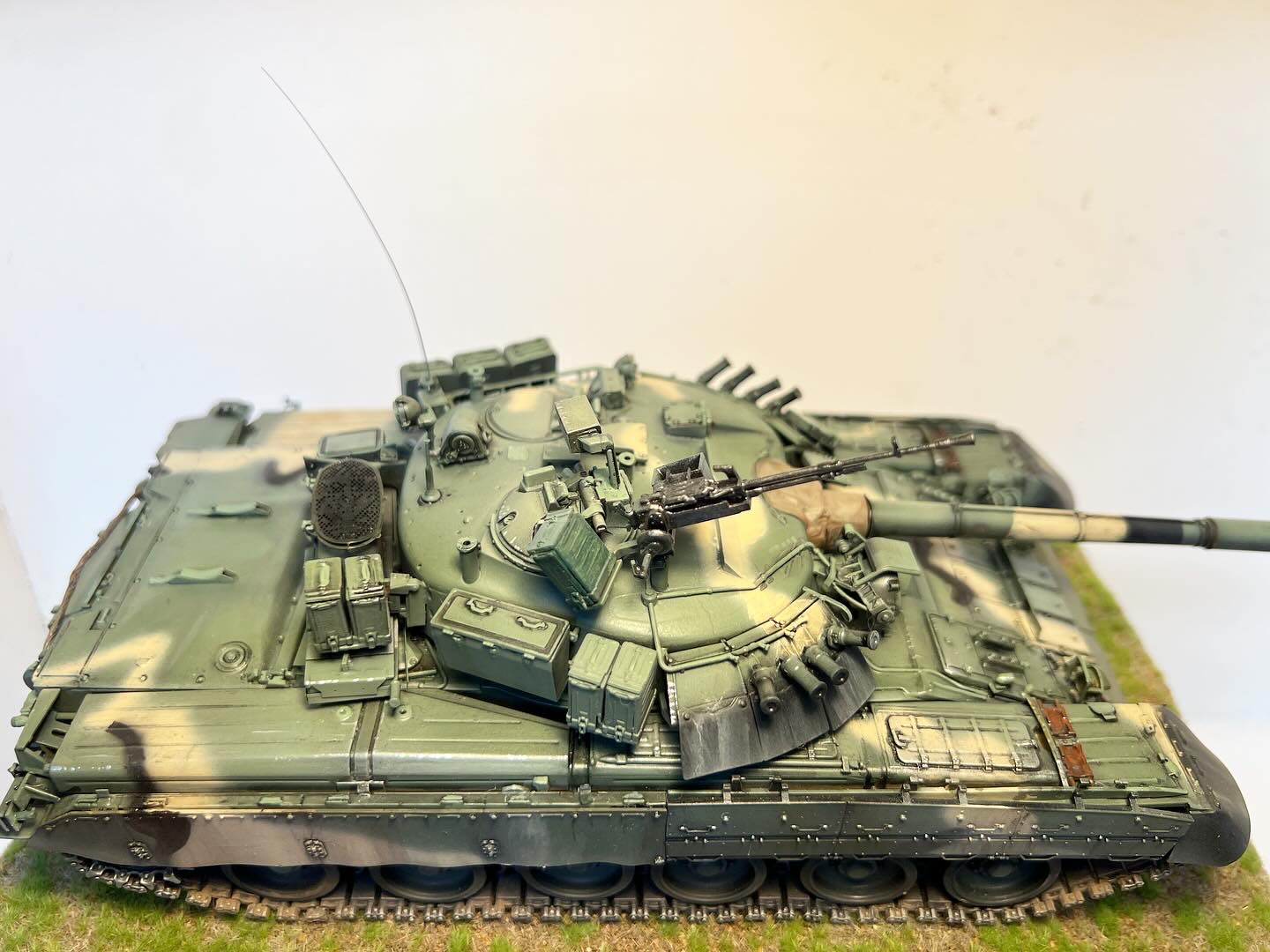

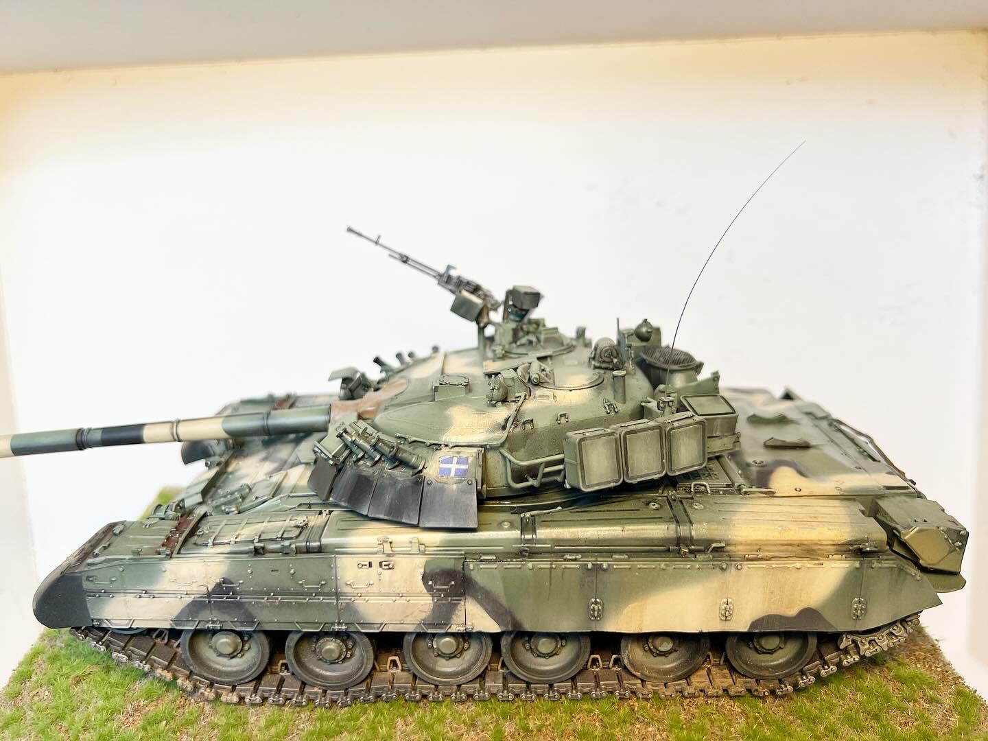

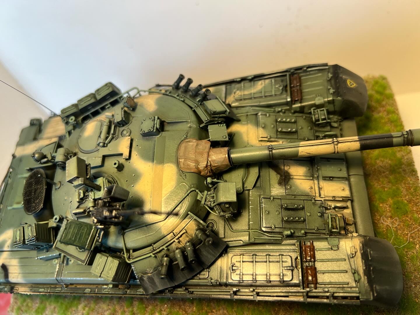

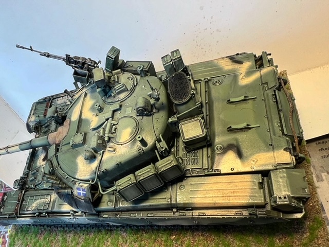

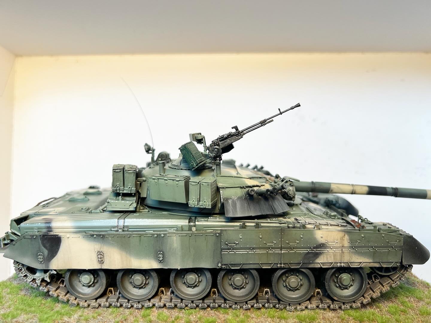

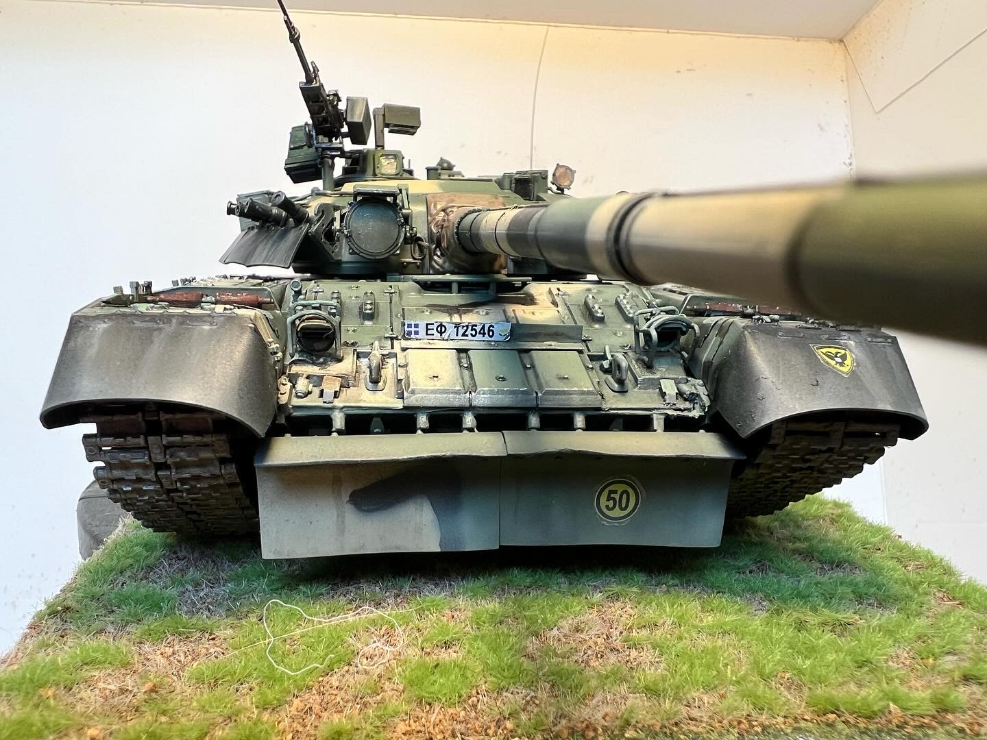

Calling finished on the nice new Rye Field T-80U. I bought some aftermarket Cypriot decals and recreated a Cypriot vehicle. It’s a bit different to what you see every day and I like that. The snorkel, ERA boxes and auxiliary fuel tanks are not fitted to the Cyprus tanks and the camo is a different pattern, and the effect is a cleaner, less cluttered build that is quite interesting to look at. They are the only NATO member to operate the T-80U and are actively pushing a programme to send these tanks to Ukraine and buying up surplus Israeli Merk IIIs instead.
Build time was around 60 hours. The kit was your classic RFM tank - a lot of parts and most certainly not a weekend build but the fit, molding and engineering is second to none. Its just such a nice kit to build, it challenges you in a nice way, not in ways that make you want to shelve it and use lots of cursing vernacular!
The tracks in particular were just awesome. Two piece, no glue, just held on with rubber/vinyl track enders - they are workable and really look the part. It took less than three hours to assemble both runs. Genuinely superb! The build required a lot of studying reference photos and this was an interesting process, not least because the camo on each vehicle was broadly similar patterns but painted by hand so different from vehicle to vehicle. The photos also showed a lot of dust and mud as befitting Cyprus and its dusty, hot climate.

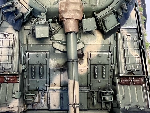

There are four highlight layers on the base coat of green, four different washes/panel liner colours on there, three dust passes in different shades and some of the best chipping effects I’ve done. If you follow my builds you’ll know I really struggle with this so was quite happy with the effects on this one.
Acknowledging that modern tanks don’t really rust because they are well taken care of, I still think a tank that was delivered in 1996 (making it almost thirty years old) will have some scratches and worn effects, light chips and so on which I’ve tried to recreate here. The toughest thing in armour modelling is knowing when to stop weathering and I hope I stopped in time here. Just!
Is it my best work? It’s certainly up there, I think. I’ve stated to realize Meng, Tiger and RFM tend to bring out the best in me. My goal of making a show-worthy model is still some way off yet but the progress I’m making is very pleasing and this is a meaningful step forward to my eye.
Do you like it?
Let me know in the comments.

Very nice!
Maybe a little heavy on the dark washes/shadows in panel lines and corners but this is just my personal taste in the matter.
Getting Merkava III would certainly be an upgrade compared to the T-80…
Looks really nice. I agree with Uncle above about the dark wash, a brown wash might have looked better due to the lower contrast with the green.
The tracks and wheels look really nice with the shiny metal areas. And the mantlet cover canvas is also well painted.

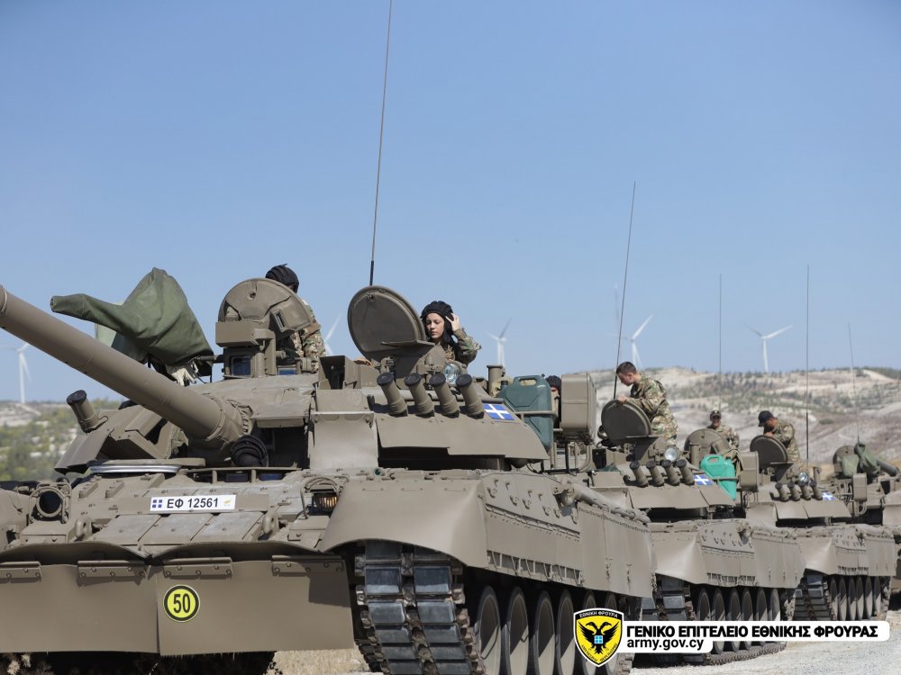

If I recall correctly Cyprus operates two types of T-80 tanks with minor differencies. You could have added the snorkel, since the first ones delivered were Russian in service tanks I think. I used to remember all those details but now I need to do my homework again.

Cyprus is only an EU member, not a NATO member. There was an arms embargo on them until recently, that is why they operate a mix of Soviet, French and even Serbian made weapons.
Agree with you it looks a bit heavy on the black liner in some places!
Yeah, there’s a story there. I’m used to using Mig washes and as you probably know these can go on for 24 hours and come off fine with enamel thinner, no dramas.
I tried Tamiya black panel liner for this one as its a bit darker and I wanted to really try to make it pop. Put the liner down, left it for four hours, put the baby to bed and went back to find it was almost impossible to get off. Humbrol, 501 Abteilung and AK thinners wouldnt touch it, I ended up panicking and pulling out the hottest thinner I have - Mr Levelling Thinner. It only just got most of it off, but you can see where it has dried fully, and rubbing too hard will remove the clear coat and then you’ll be down to bare plastic before you know it so I had to be a bit careful. Suffice to say, lesson learned!

Chris, I just spent four hours judging at the AMPS Internationals and I can confidently say that this model is certainly “show worthy”. You’ve got a good solid build there and an excellent finish. The tracks look great and the camo pattern is outstanding. If the wash\panel liner is too heavy in places, that would only be a .5 point reduction. Don’t sell yourself short, you’ve done a great job here.
Chris, your T-80U is T-80U eye candy!
I didn’t know Cyprus had them, much less with an interesting camo pattern. I like your camo pattern and application. Makes me want to build the RFM kit as your T-80U is inspiring!

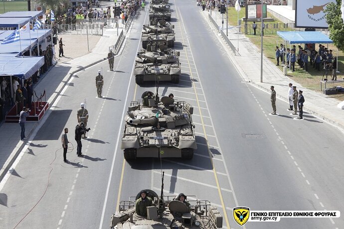

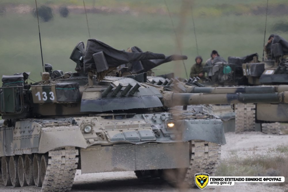

In case anyone is interested in doing one, Cyprus has changed to a single color camo recently
Nice model but the Cypriot National Guard operate both the T 80U and T 80UK and do have all the ERA tiles normally fitted along with a large turret basket, I have not seen a photo without ERA, the national guard have also adopted a single colour for some of their T 80s
Best me by seconds :joy:
I have seen photos of tanks when Cyprus first got them without the ERA on the turret front for some reason
Not saying it never happens, just most show them with
Chris this model looks excellent! The finish is beautiful overall, the camo pattern is especially nice and the weathering is great.As far as your washes go, imho I don’t see anything wrong with it. I like to see a model that pops with shadows and highlights. It’s pretty much my style. And your model is definitely show worthy, no doubt. You’d definitely medal at AMPS or the local and regional shows that I attend I can tell you for sure.
