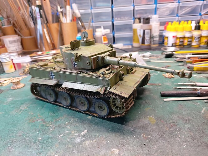

I’ve been away from the work bench and just got back to finishing the build off. So here’s an update and a few comments re the RFM kit #5003. See my comments below the images.
Great kit. But like most kits I found a few issues. Some of my own doing and others oops from the Rye Field team.

I’ll do some better images rather than using the phone camera.
My finish is a bit glossy so I have some more weathering to do. I also tried to copy 321’s bent fenders. I sanded them as thin as possible before attacking them.

A few more image. I’m yet to paint the shells.
