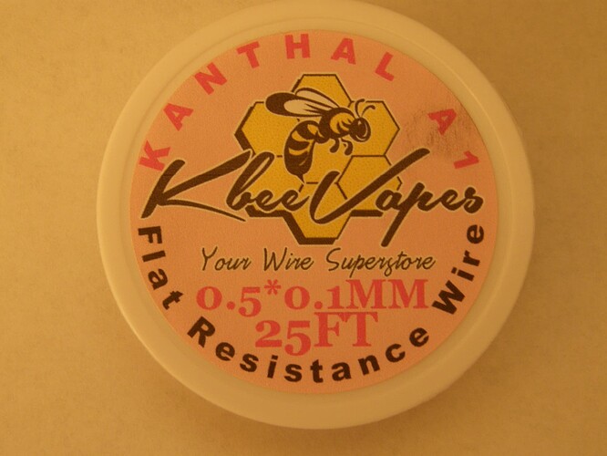

If your subject aircraft has flat “streamlined” wires, I’ve found this product (available on e-bay) works well. It is available in numerous different widths. I’m currently working in 1/48 with some 0.2 X 0.1 and it looks fantastic!
John
John
John, that looks pretty interesting. Thanks.

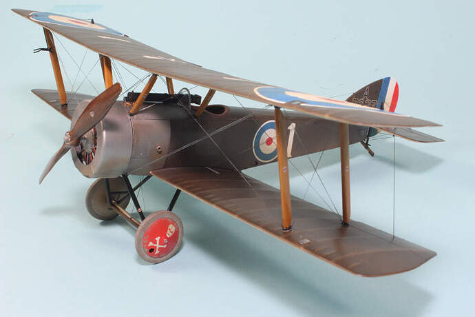

I used similar stuff to D1GG3r321, EZ-Line (which I reckon is exactly the same thing?) to rig my Sopwith Pup. But my Gladiator has stalled, the silver paint is pulling off when I mask it. I had a second go after re-painting it but no joy. It now needs stripping so that I can try again but I have no clue how I can do that! ![]()

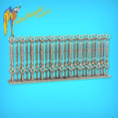

Ultracast in Canada carry EZ-Line and Uschi fine rubber line. Also, they have five types of turnbuckles in 1/32. Details Parts - American
Those turnbuckles are beautiful. I really hope I can start building one of my canvas Falcons soon. Thank you for the information.
