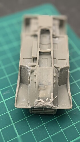

Not much progress this evening; the Elite MUNGA has fought me all the way. Brittle resin and poor fit. Some parts shattered when removed from the casting plug, let alone me trying to understand what goes where - not necessarily the instructions - more down to me!

And so it begins: the MUNGA. It’s all here plus a bit of reference material:
However, some breakages and the underside of the chassis was shattered when removed, so a fair bit of filling, ongoing:
I might have my work cut out here!
That looks gruesome Brian. Sharpen your hobby knife!
The ways things are going at the moment it might just be for my wrists!
