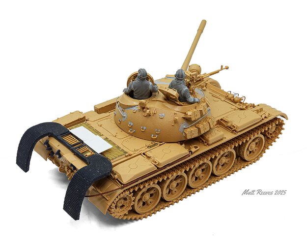

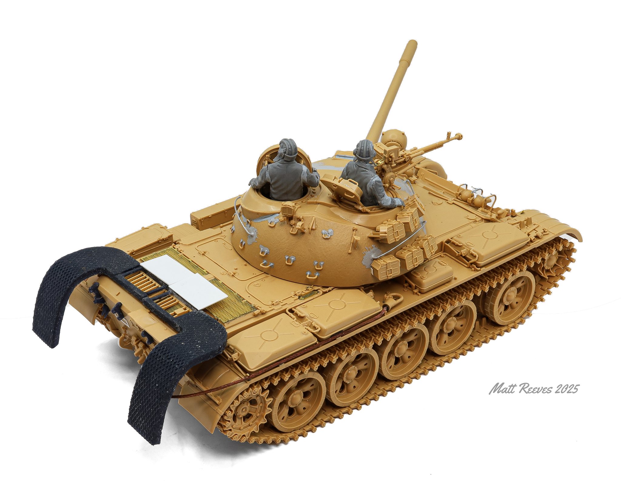

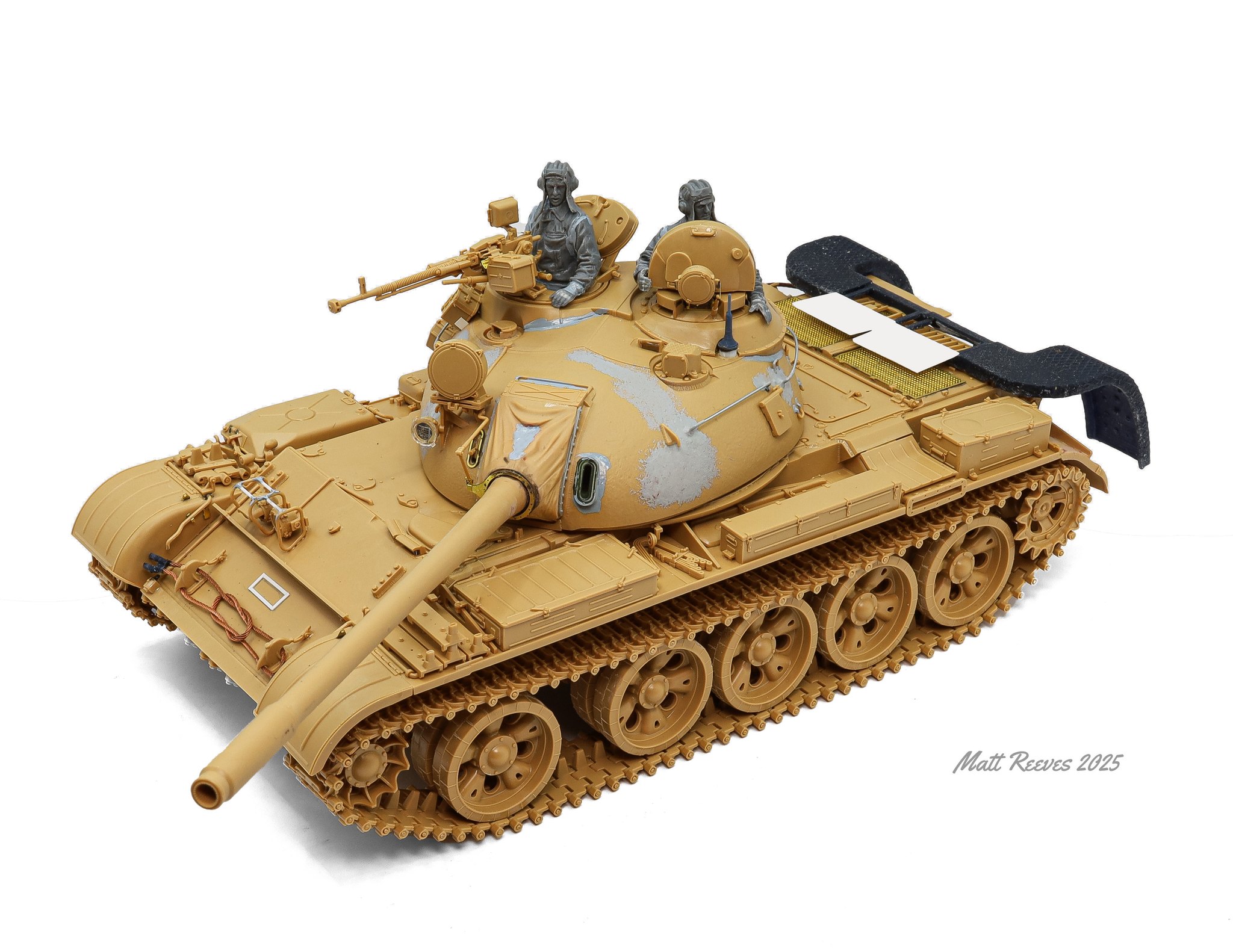

Rye Field’s 1/35 T-55A obr.1981, converted to an Iraqi T-55A obr.1970. I’m writing a build article for MMI on this one. I designed the Iraqi dust deflectors in Shapr3D and printed them on my resin printer, and the figures are slightly modified MiniArt Soviet Cold War crew.

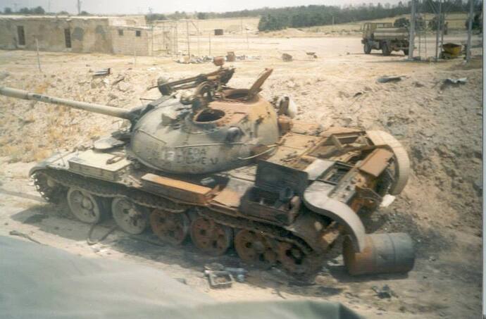

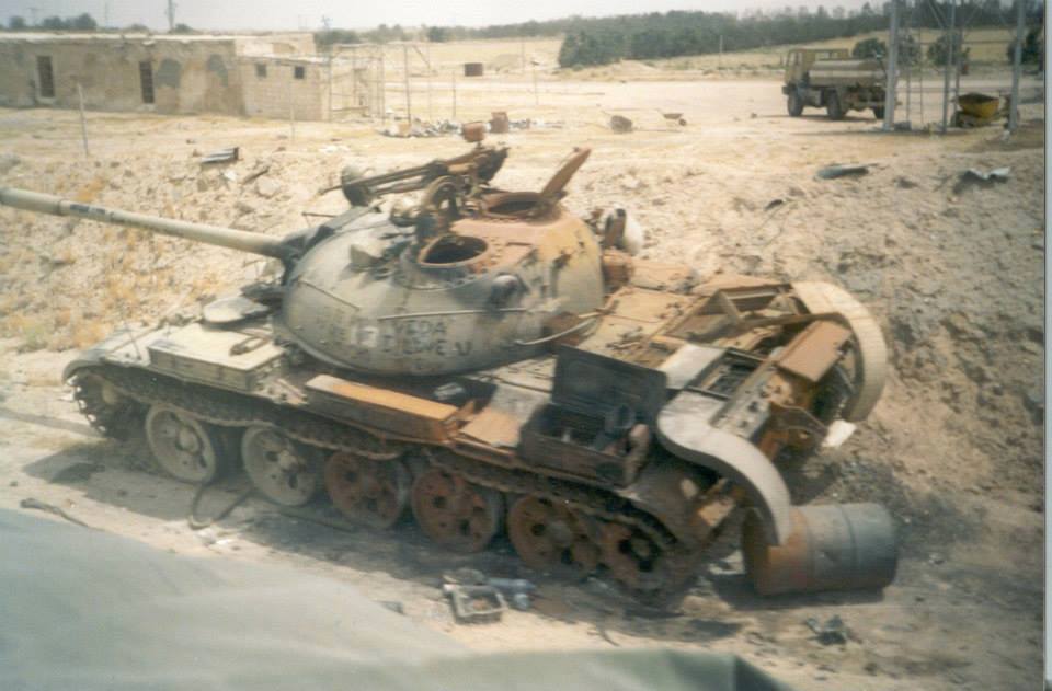

After a bit of research, I figured out the function of these things. Though I had been calling them ‘heat deflectors’ like everyone else, the placement of these things didn’t quite make sense as a means of reducing IR signature. They’re placed in a spot behind the engine and radiator, and directly over the intake (port) and outlet (starboard) for the cooling fan. Since much more heat would seem to be generated by the exhaust, for example, why place it here?
The answer has to do with Kuwaiti sand and dust being sucked in by the cooling system. This is a problem with the T-54/55/Type 69 series, as the plume of dust kicked up by the tracks as the tank moves forward tends to be sucked in by the cooling system, which obviously would cause plenty of problems. As it was also seen on at least one T-72, it seems to have been a problem for that type as well.
So, this was an Iraqi attempt, and a simple and quite practical one, to improve the efficiency of their combat systems in a different battlefield environment than the one in which they had previously been operating for nearly a decade.

Nice Matt and snippets of info like this are super important to getting a particular kit just right. Thanks for sharing!
Great kit and info!
Those deflectors look great ! What sort of reference did you have on them , just a few photos or anything more extensive ?
Nice job.
Well-said, Sam! The details really add to the history!
Thanks Sean! As far as references, I had a good bit of them, but as far as function, I had to infer that much.. Lord help us, right? :laughing:

I think Miniart has the T-55A mod 1970, they also have some Tiran tanks sharing similar features.
They do indeed, and I have two in my stash. I got the RFM kit as a Christmas present from my wife, so I had to do this conversion :grinning_face_with_smiling_eyes: Also it was a much quicker build than MiniArt.
