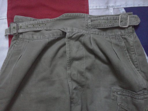

For the record, the SAS that I recall often used cut-down British Army OG trousers for shorts. These were a very well made item and fastened with a very comfortable cross-over buckle arrangement, as you can see here:
OG 1
With the buckles on the side there was nothing digging in at the front when one was being active.
If you are modelling these there were 2 x flapped pockets on the rear.

Those pants are genius! I wish I could get a setup like that for work.

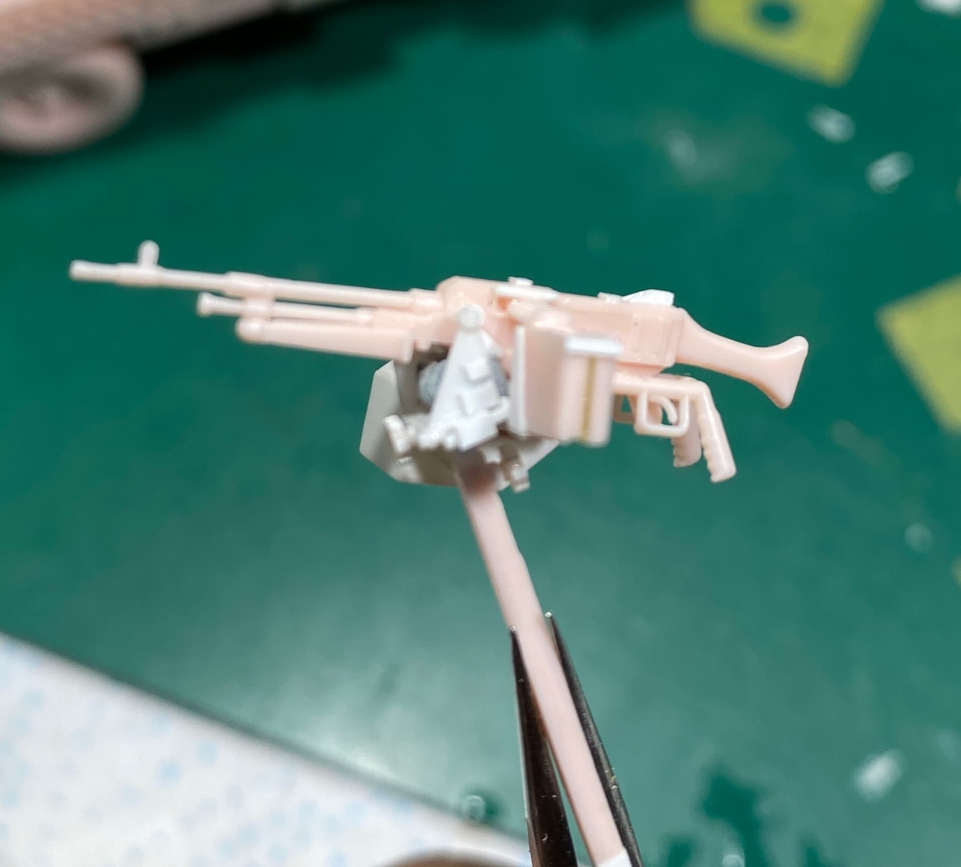

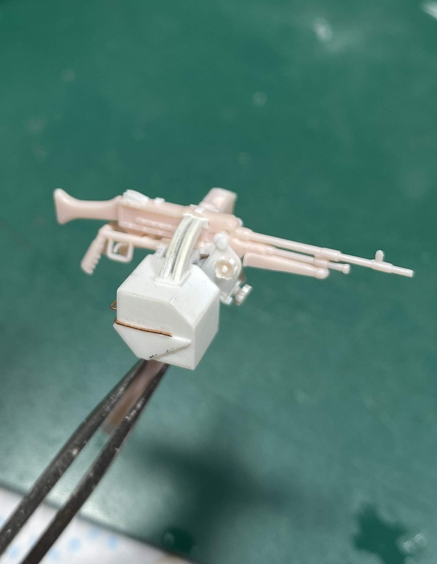

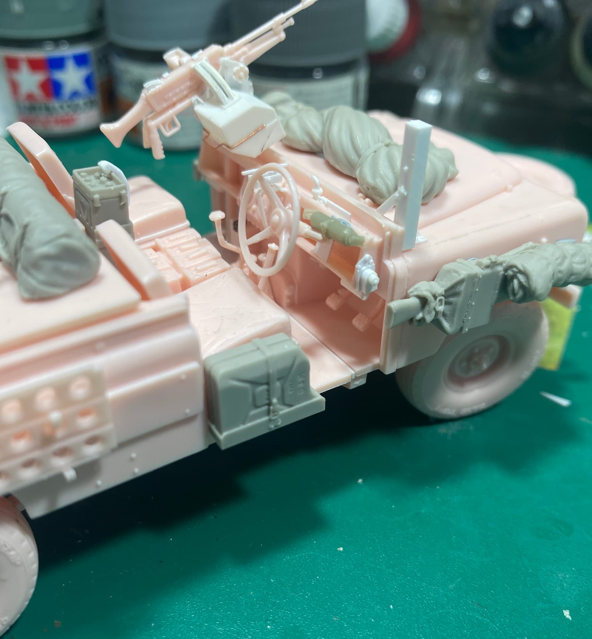

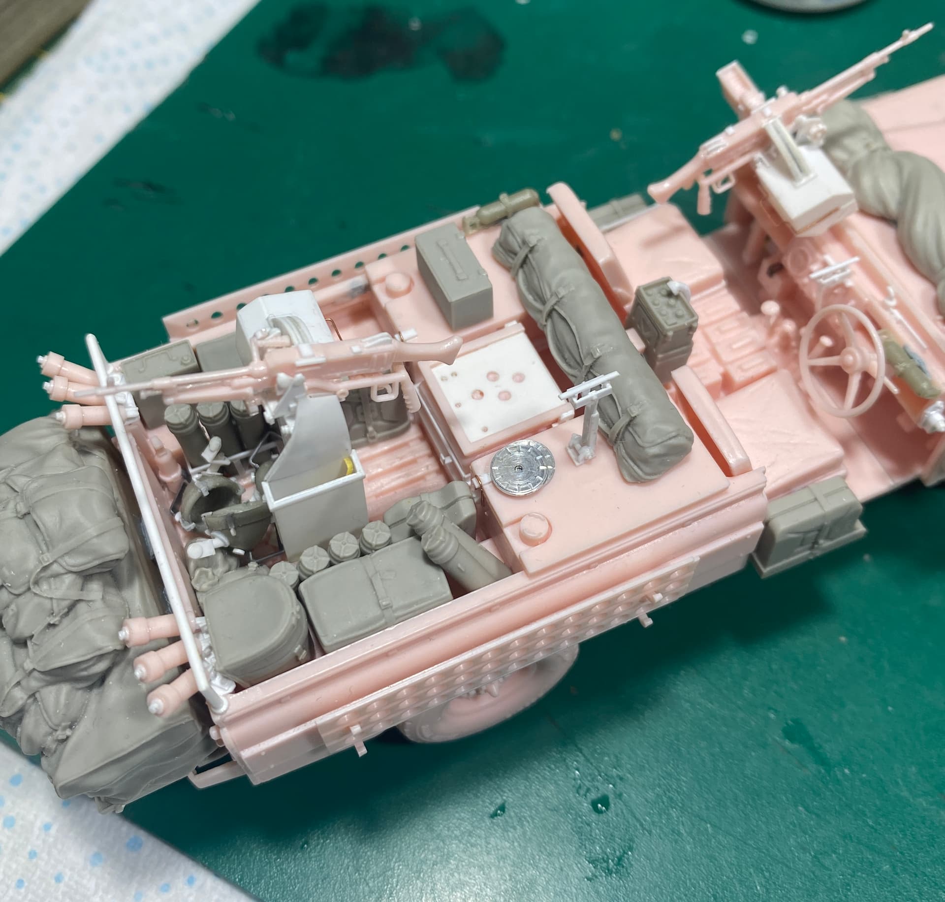

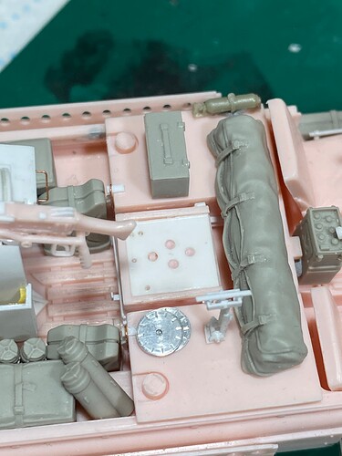

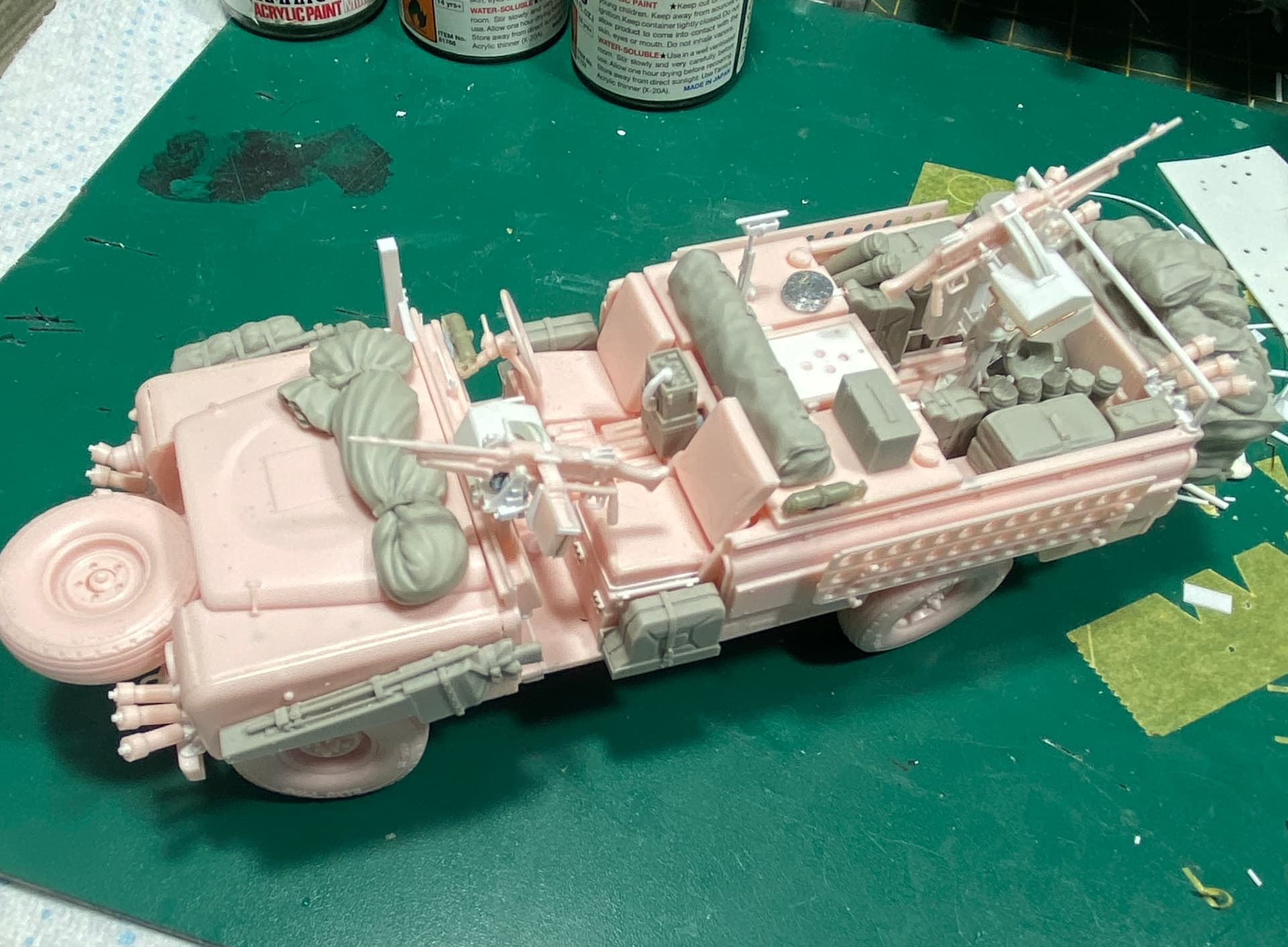

Here are some updates of the progress. I’m getting there and the finish line is in sight. After which I will proceed to priming and painting.

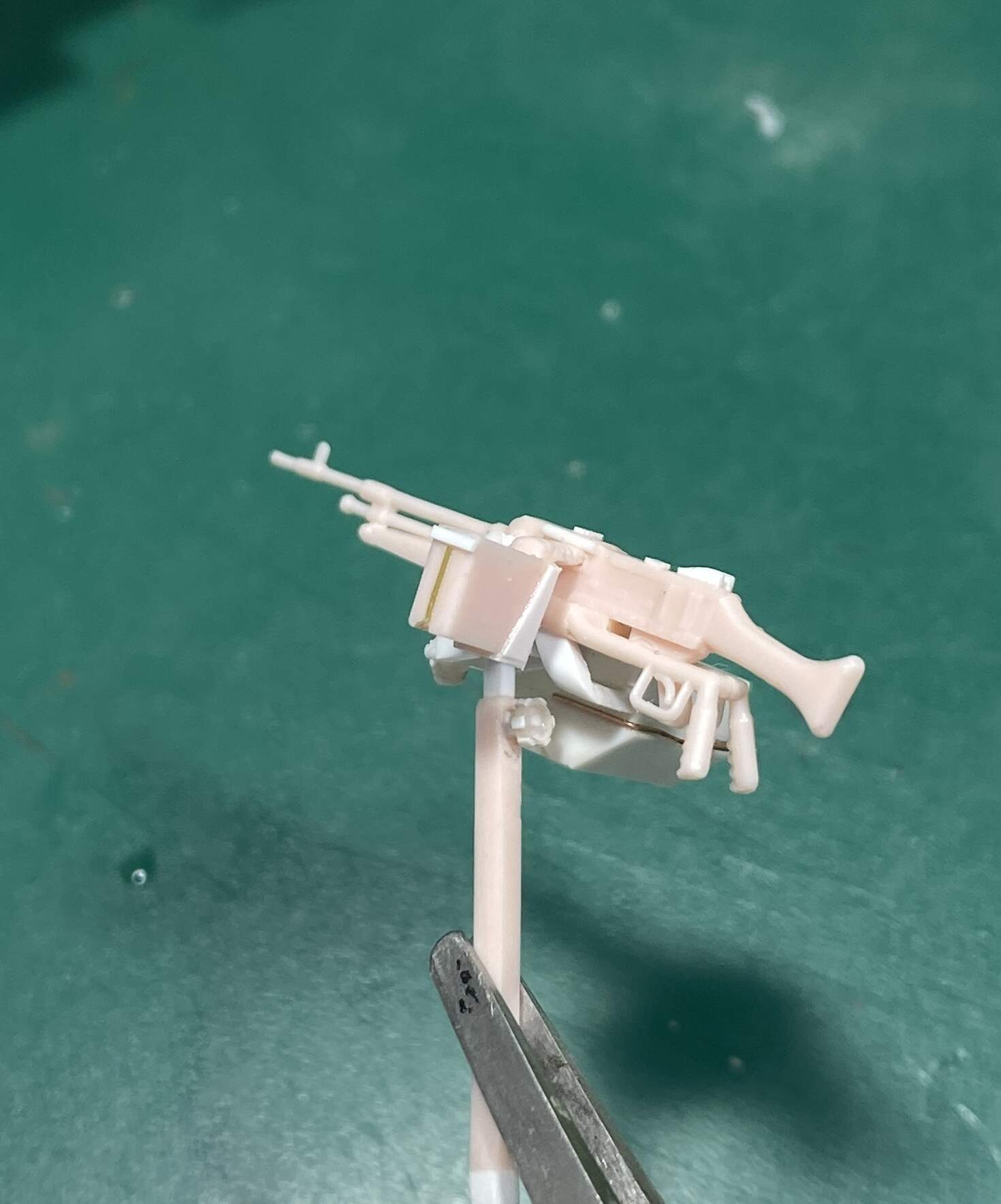

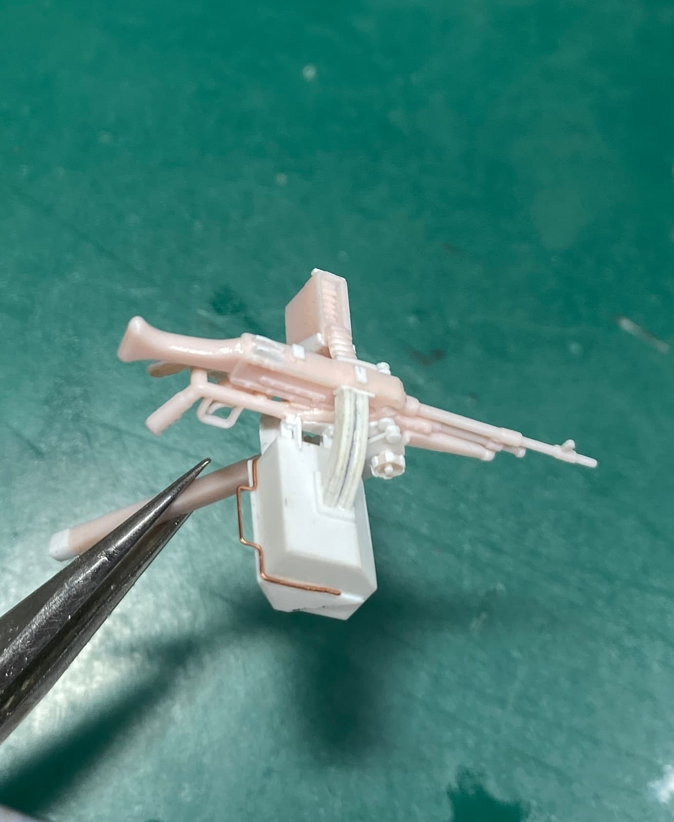

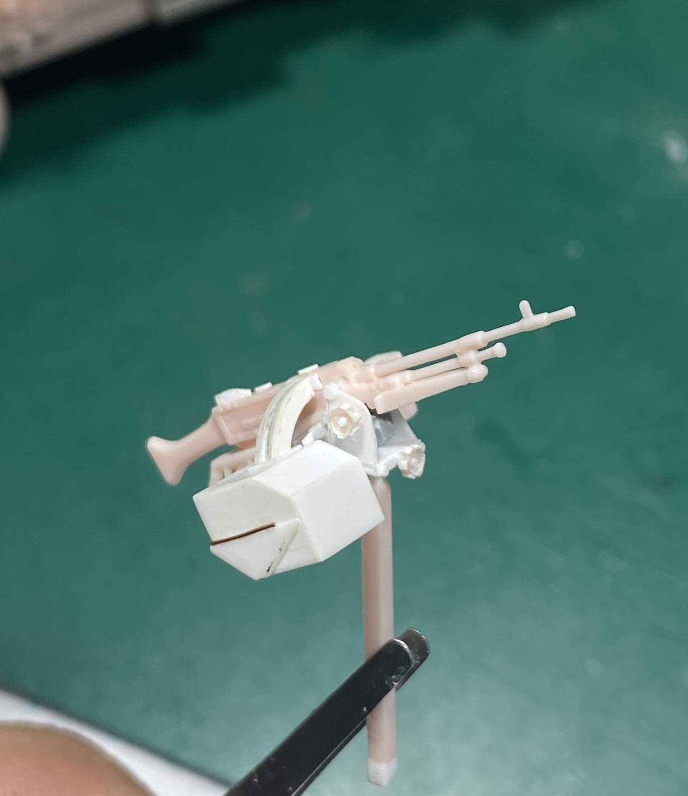

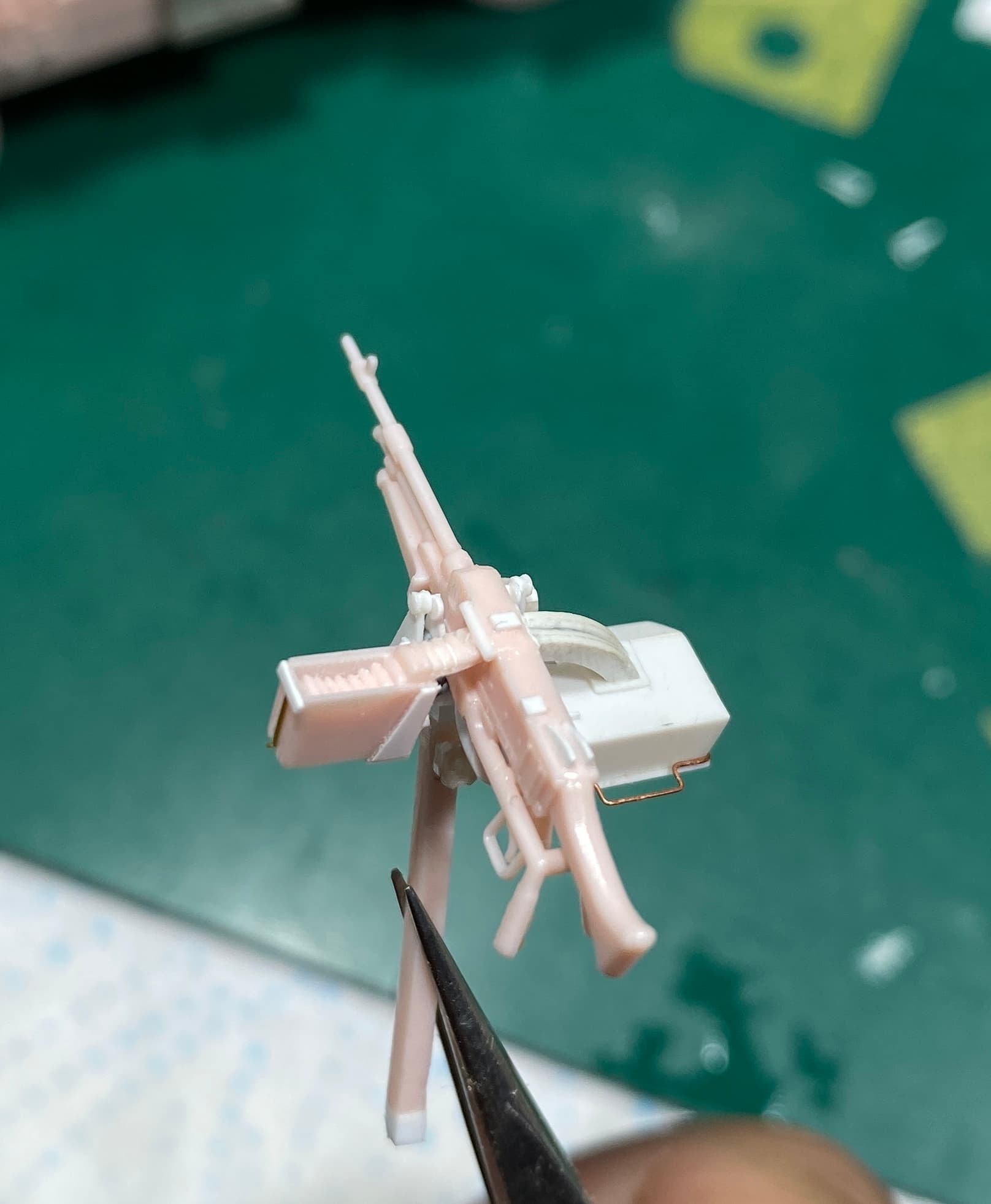

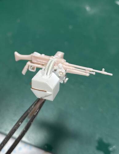

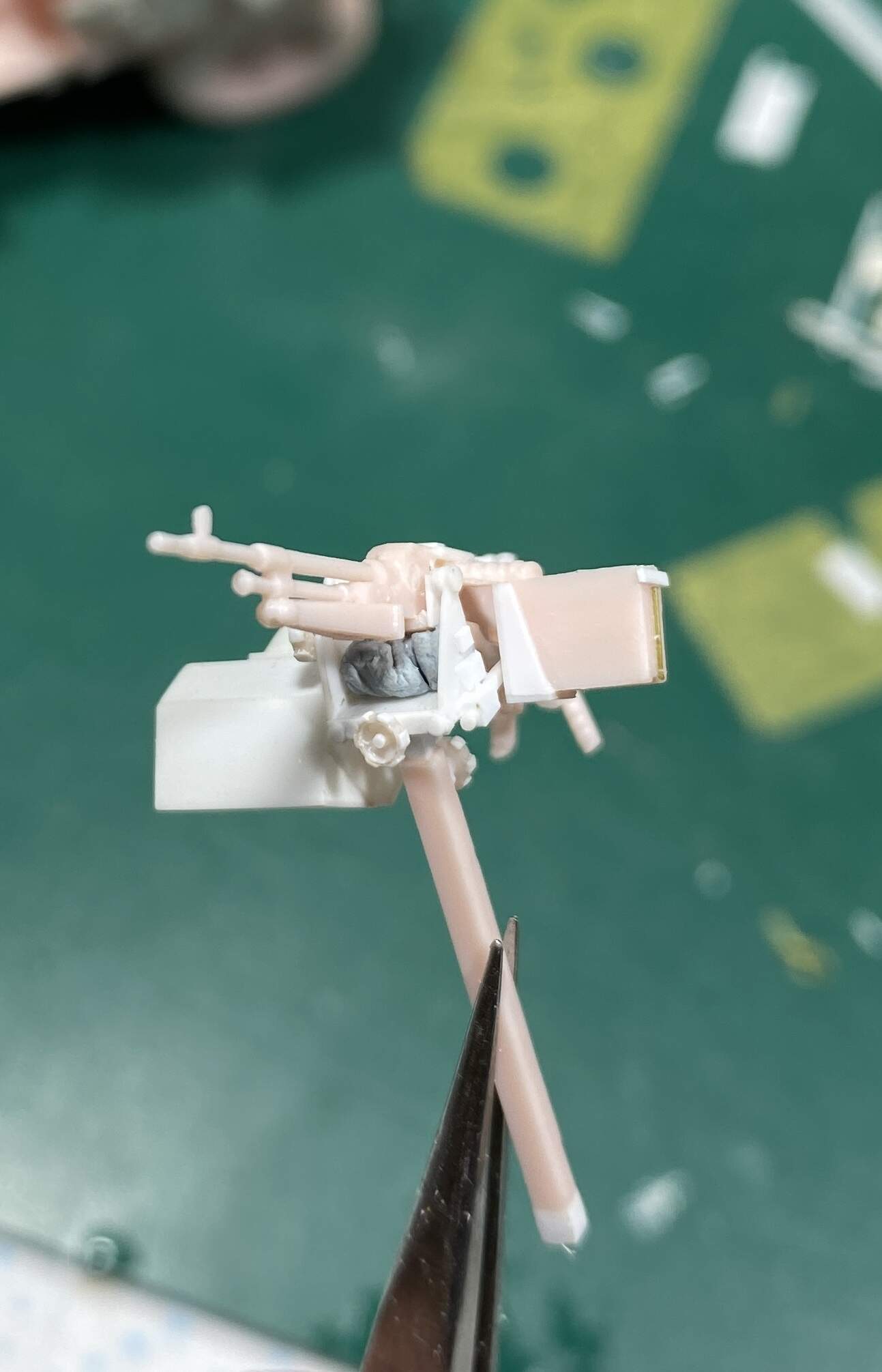

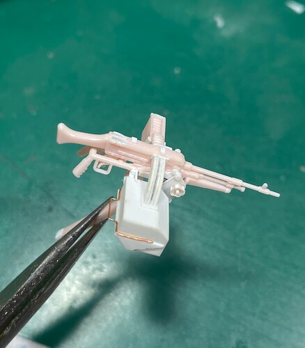

Front GPMG completed.

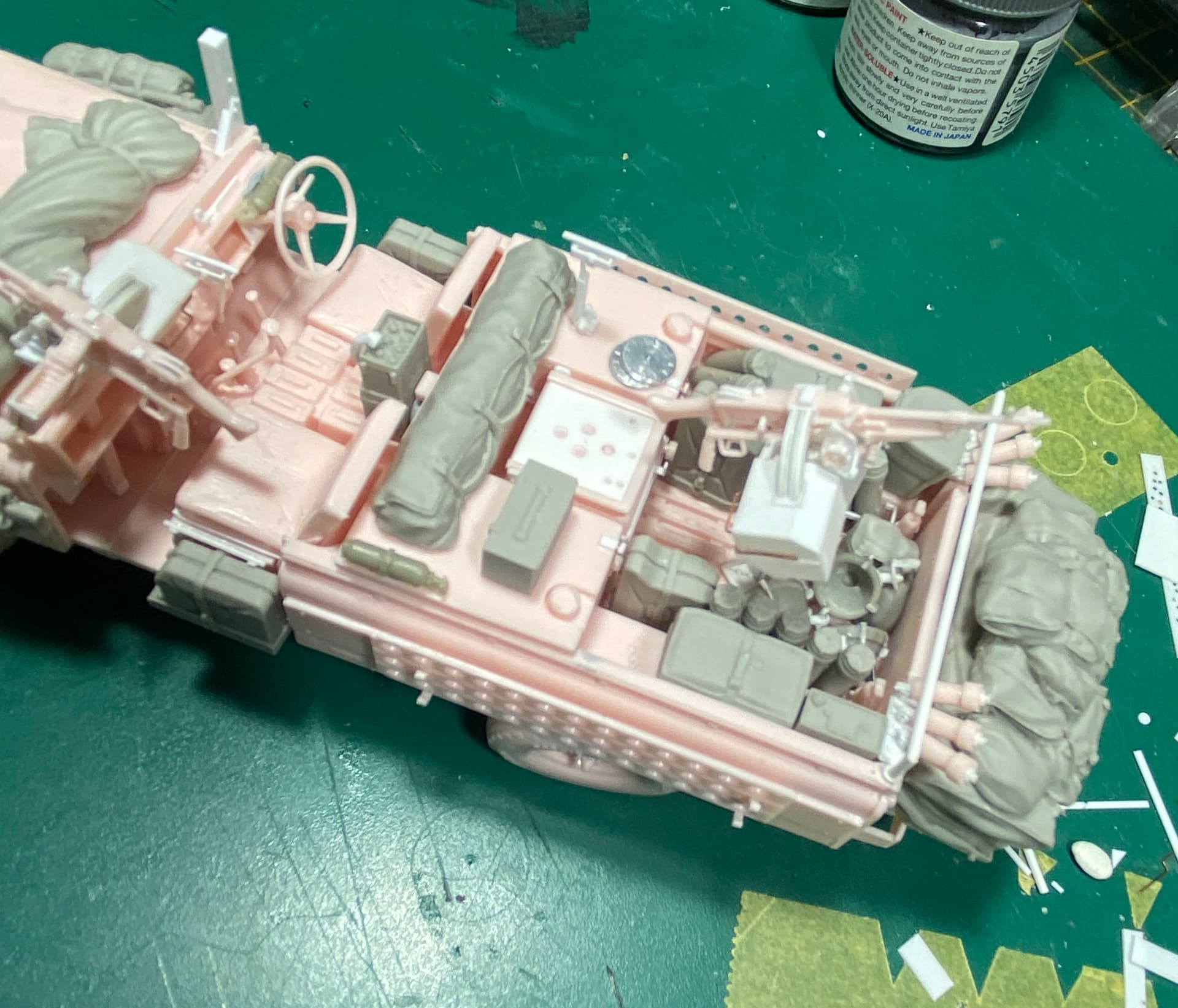

Are those fuel tanks behind the seats? If so, that’s alot of fuel. Does the truck have a diesel?
Thanks
Looks outstanding Raphael. Great job so far! Love the detailed scratch building. I have this kit with lots of extras so I’ve been watching.
Impressive detailing work, congrats.
I’m no expert on SAS Land Rovers but I think they must be. It might not be generally known but the normal fuel tanks on this type of Land Rover (petrol) are underneath the driver and passenger seats. When refilling you move the seat out of the way, followed by a protective piece of metal, unscrew the caps and tilt your jerrican/engage fuel pump nozzle accordingly. I kid you not, I’ve seen soldiers do all of this whilst smoking!
Yes they are fuel cells (100 gal in total across four cells on the vehicle). The engine was a petrol rather than a diesel.
Thanks gents!

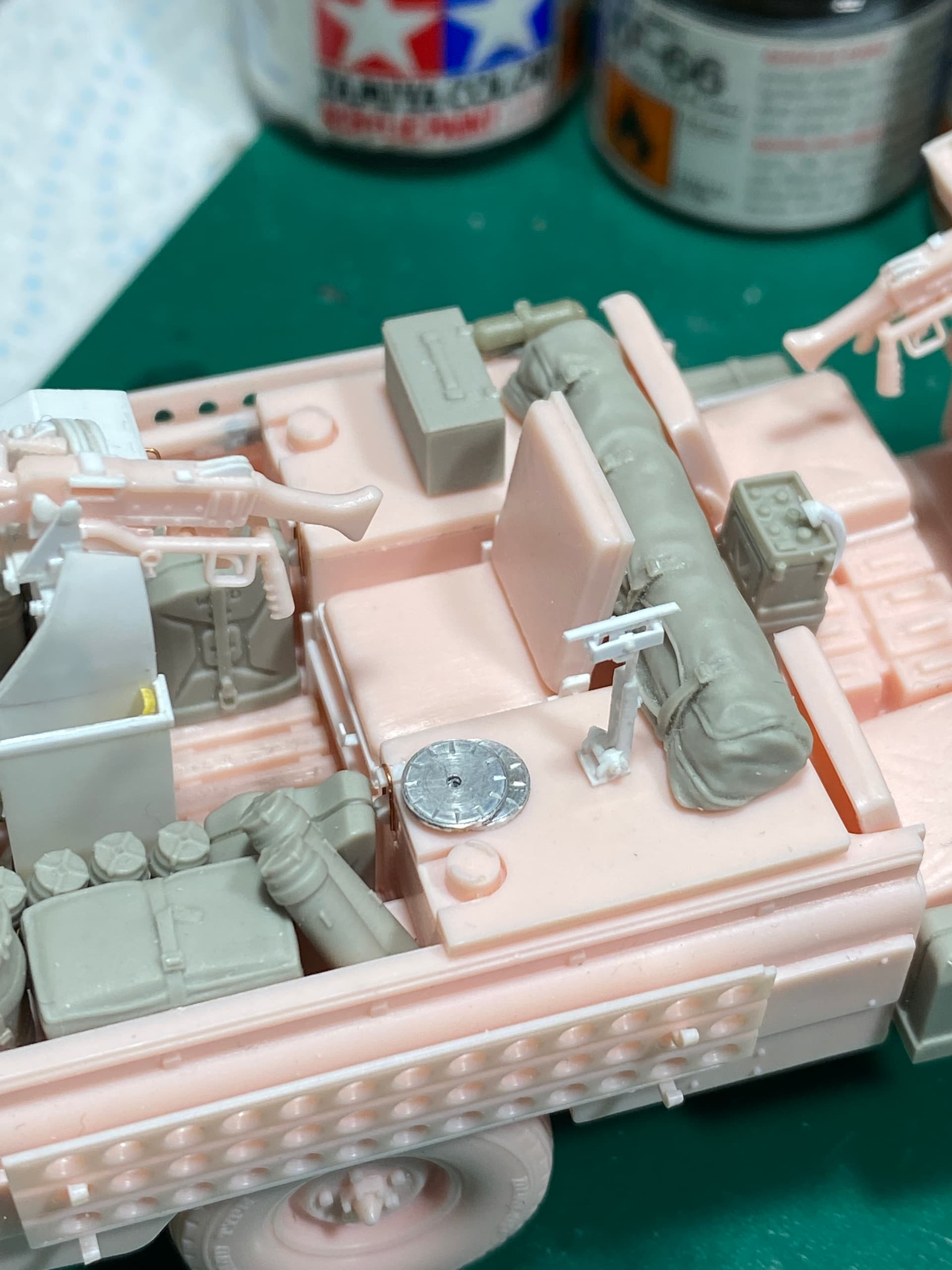

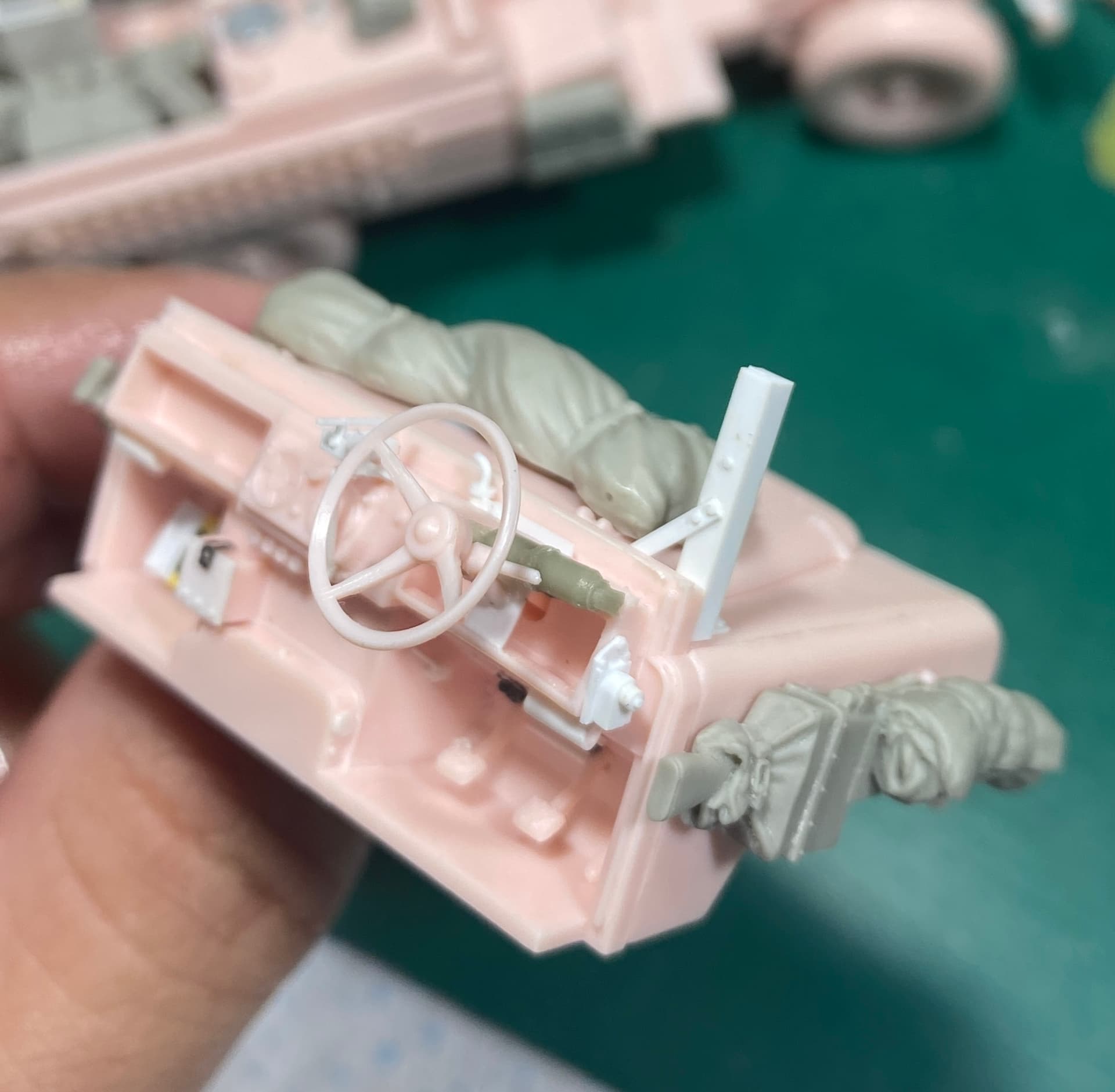

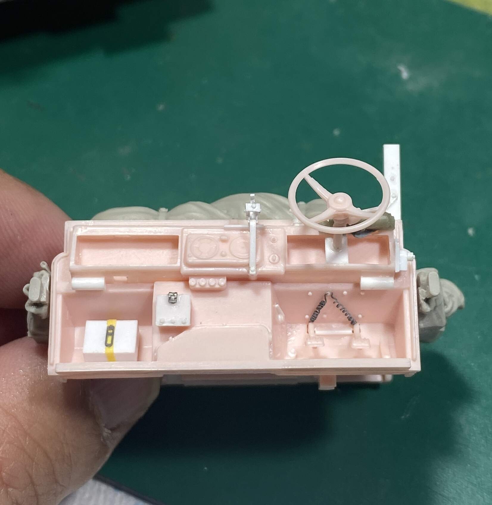

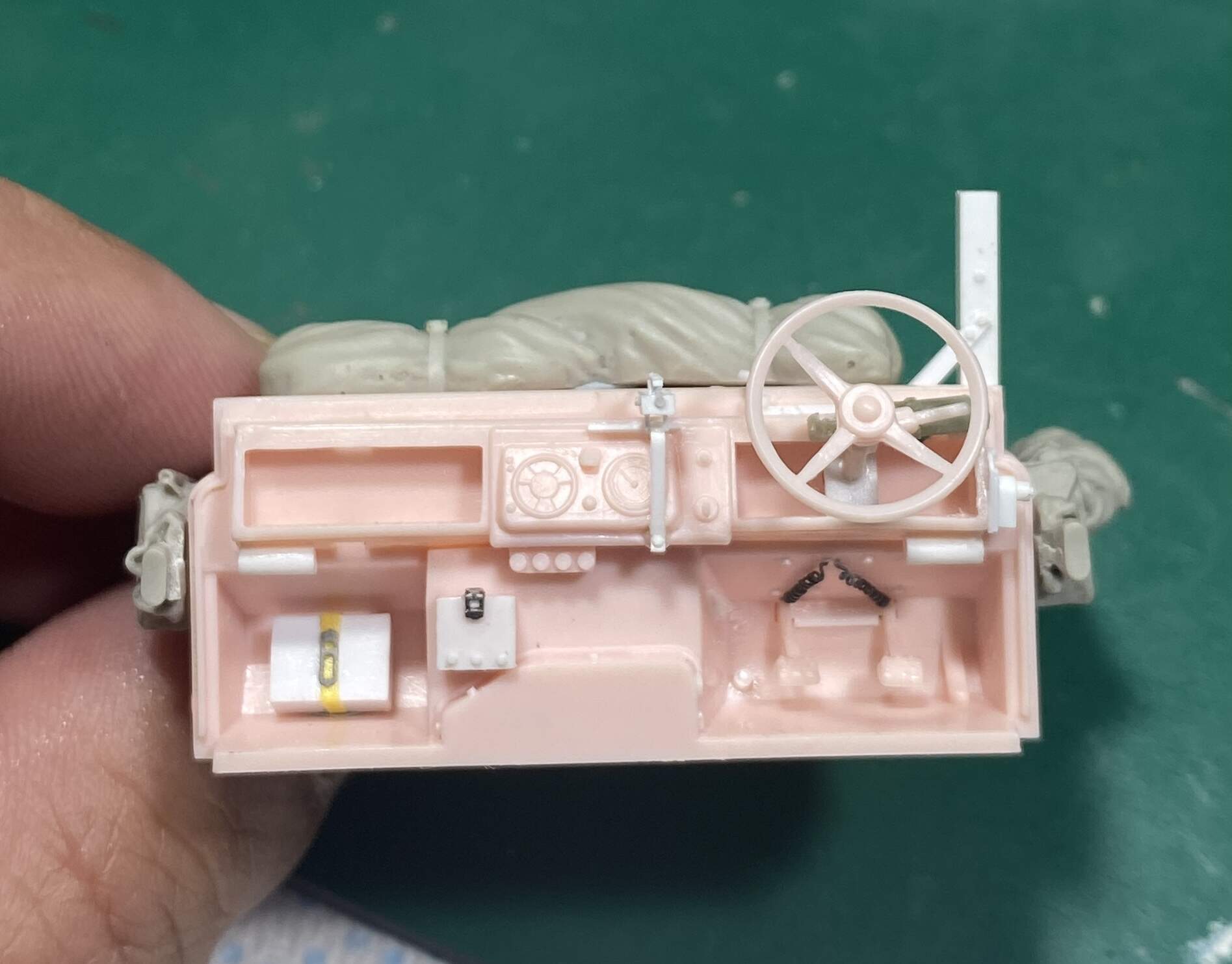

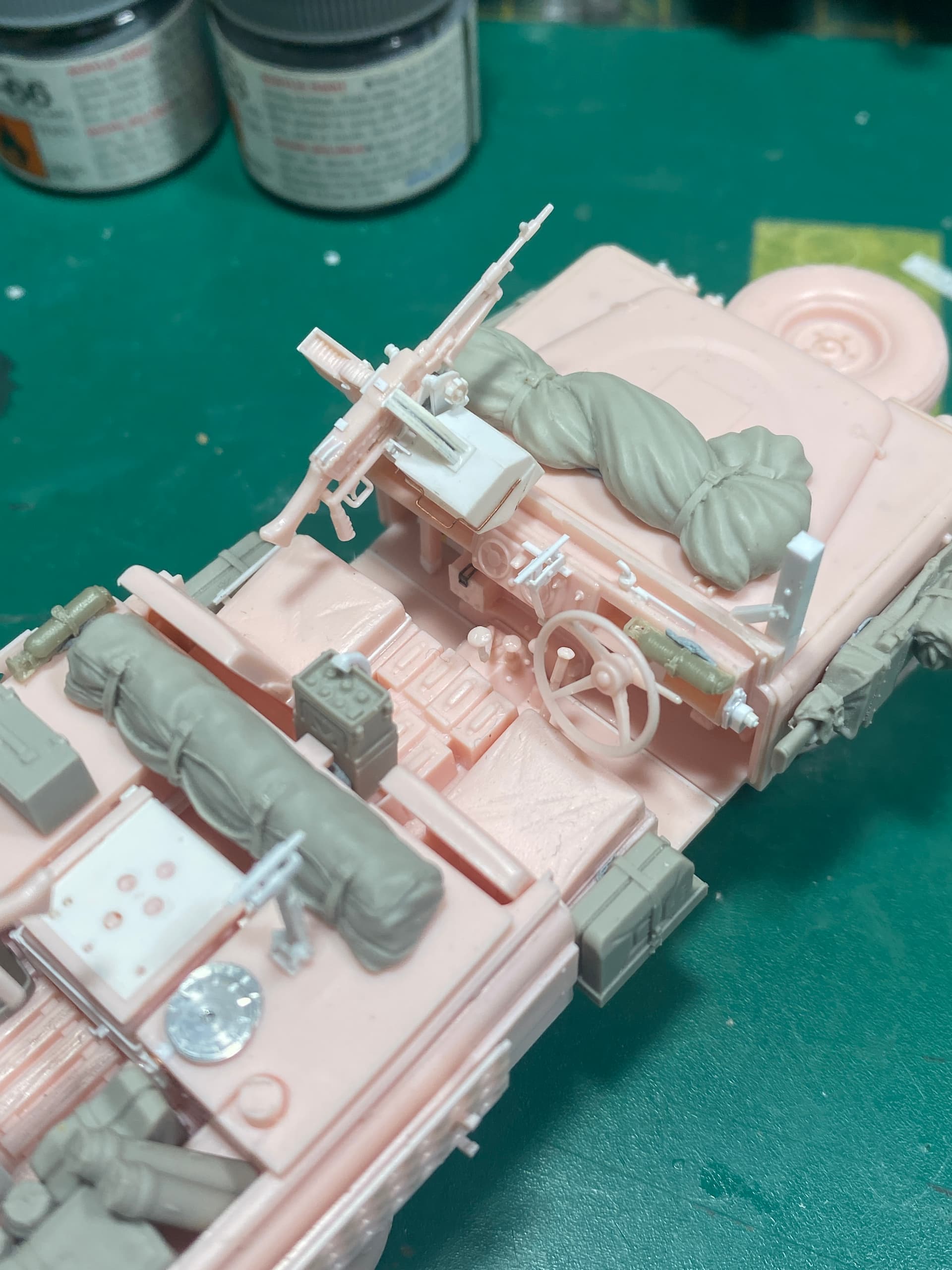

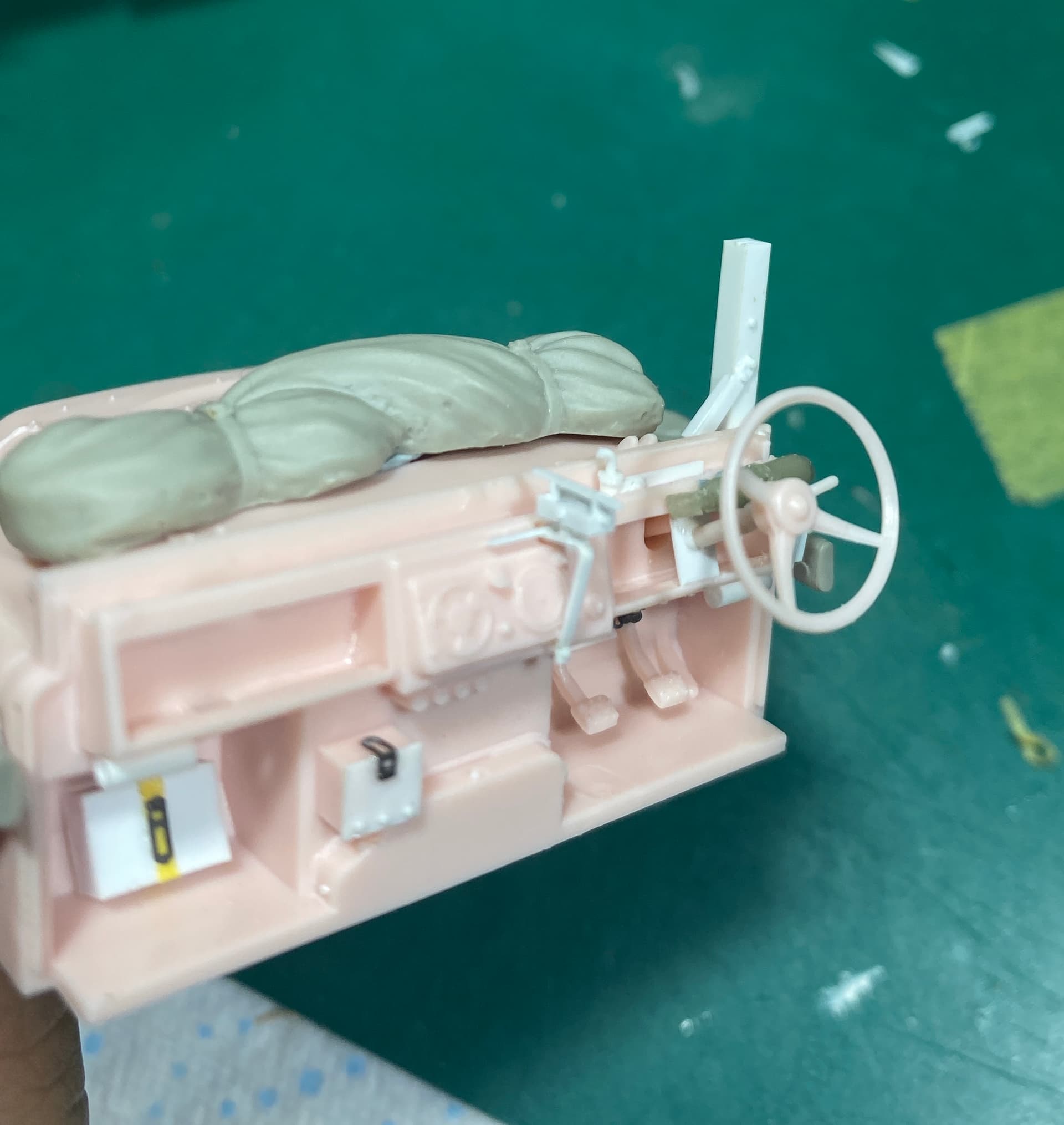

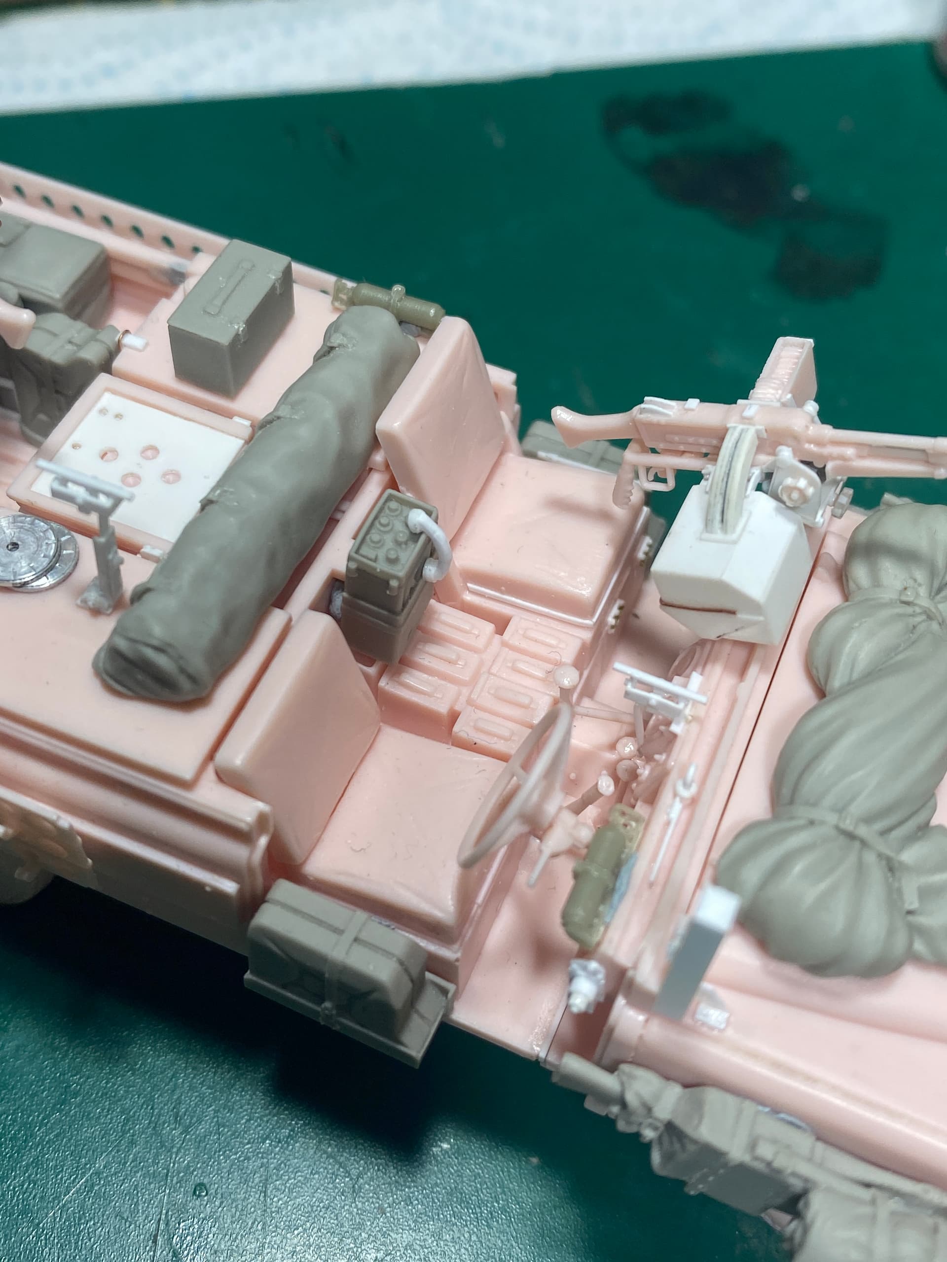

More updates: Now this is the details for the driver and left front seat

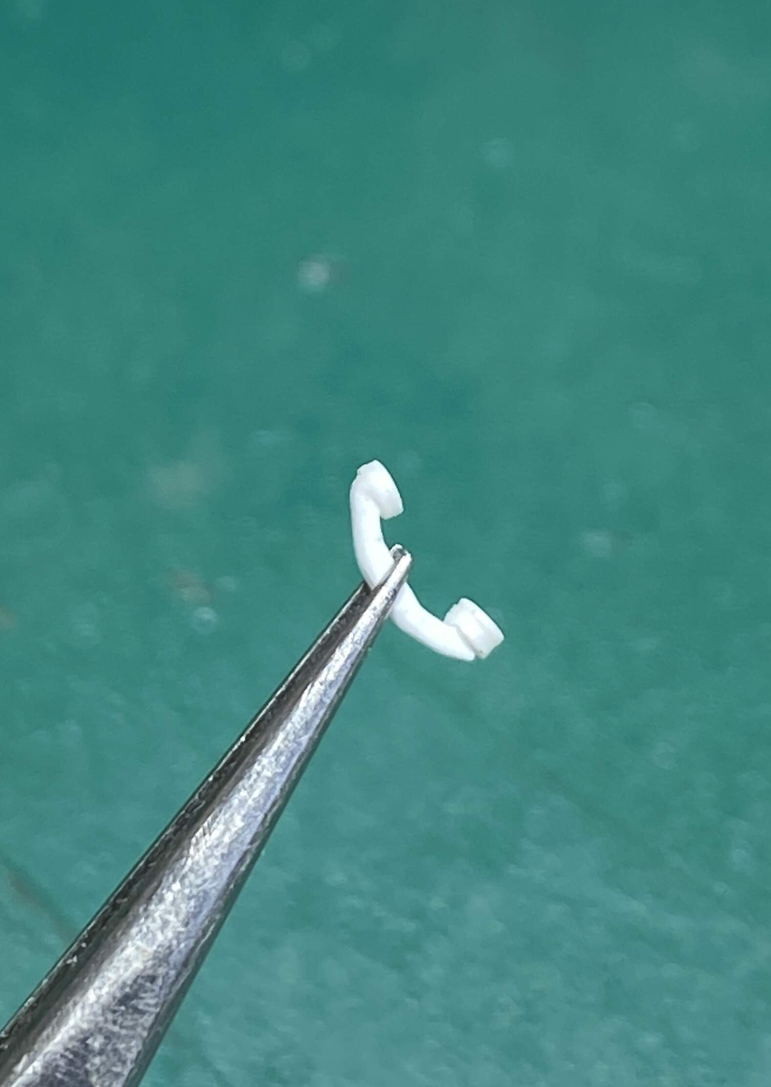

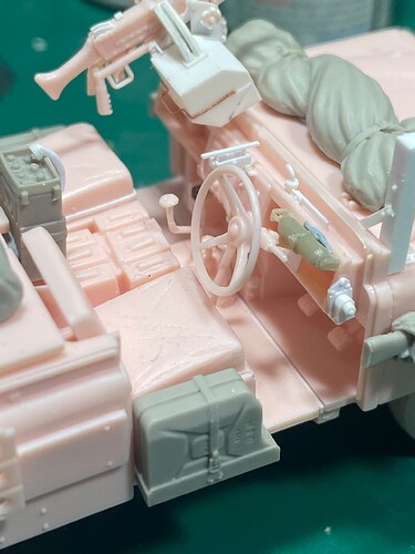

Rear seat details. Note I have made the rear seat foldable as per reference. Also scratch built the hand set for the radio.
Area in between the two extended fuel tanks.
Seat folded
Seat back rest deployed

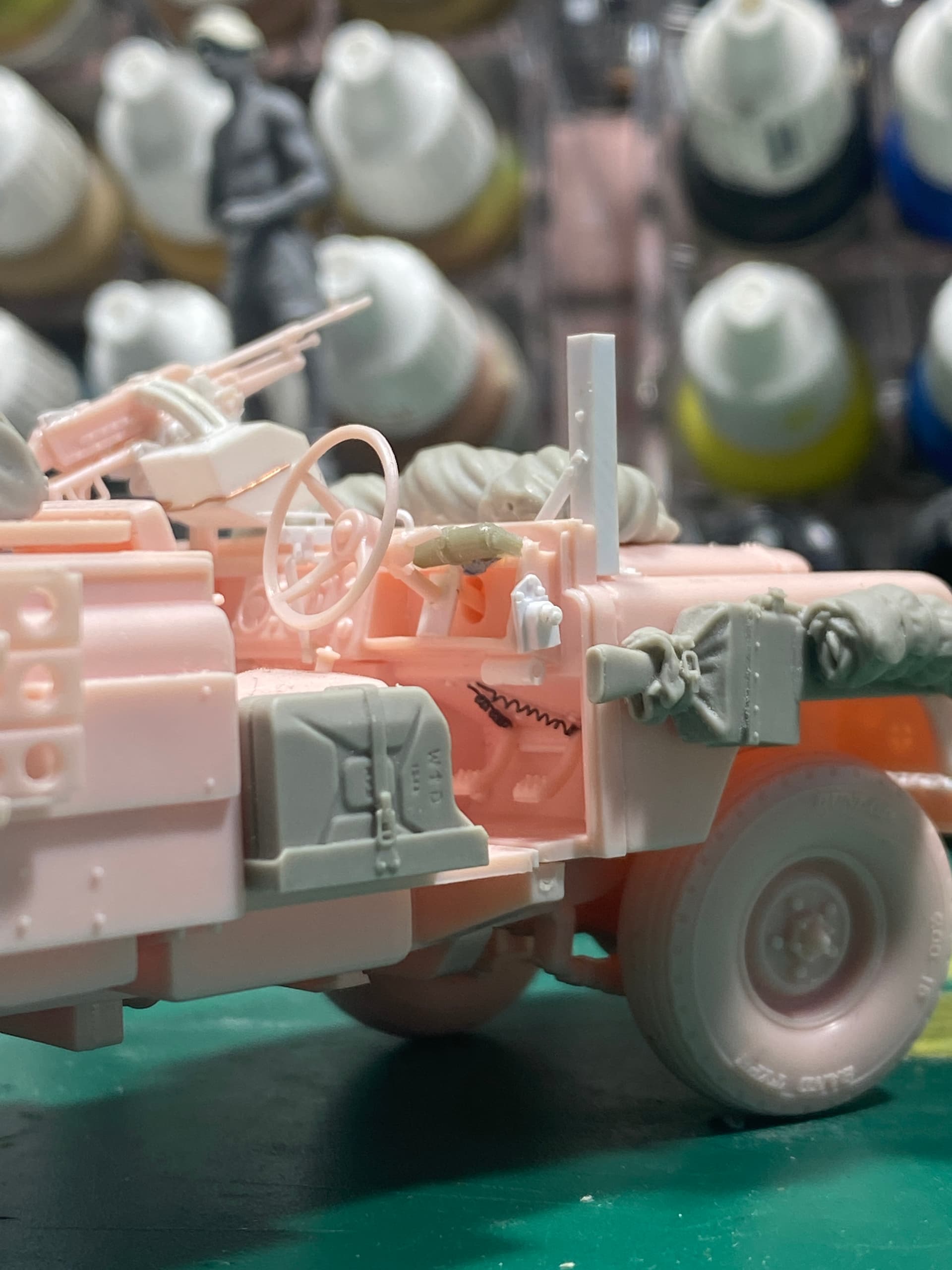

Scratch built handset for the comms.

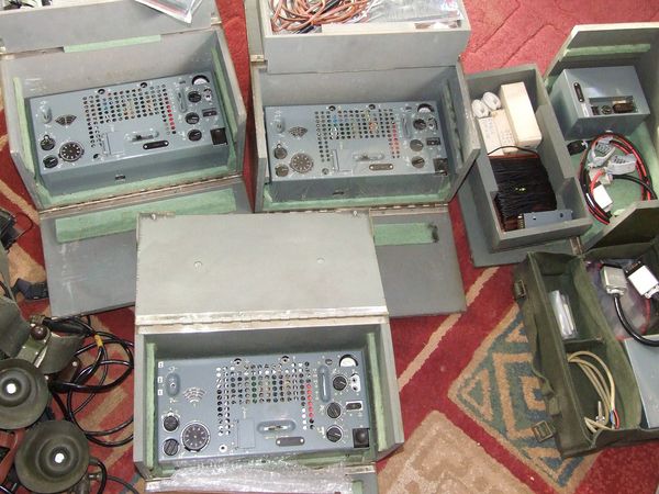

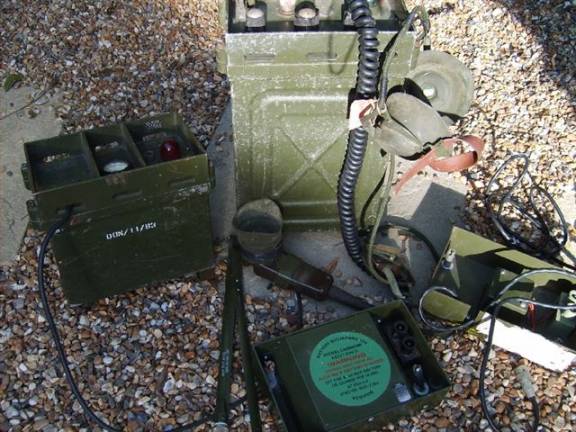

In terms of radios, the Tamiya kit includes an A43 radio, part of the Larkspur comms system, between the front seats (the resin radio you have used is also an A43). It comes in two parts - the ‘manpack’ unit which is obvious and a second unit which sits below it - on the Tamiya kit it is the extra piece moulded to the rear of the ammo boxes. That will date your vehicle to the 1970s - later vehicles were fitted with Clansman units which are different.
A second radio is the extra box on top of the fuel tank (you have this already as a resin item). The Mk 123 radio lived in a wooden box. It was a specialist ‘spy’ type issued to the Diplomatic Corps, intelligence organisations and special forces teams. Lastly, SAS Troopers often carried a personal SARBE (Search And Rescue BEacon) radio - a device commonly carried by pilots in case they had to eject and needed rescuing. It wasn’t unknown for troopers to use them as ersatz ground to air radios to direct ground attack aircraft (eg, the Mirbat fort battle).
Thanks John. So this is the Lakspur system instead of the Clansman, thanks for the correction. Do you have a picture of the radio connected to the second unit below? and do you have a clear picture of both the Lakspur antenna mount and the Mk 123 radio antenna mount also. Thanks so much!
I don’t know if the Mk123 was wired into an aerial except when it was in use. My guess is that it was plugged into the HF aerial only when being used and then everything was stored back into the box.

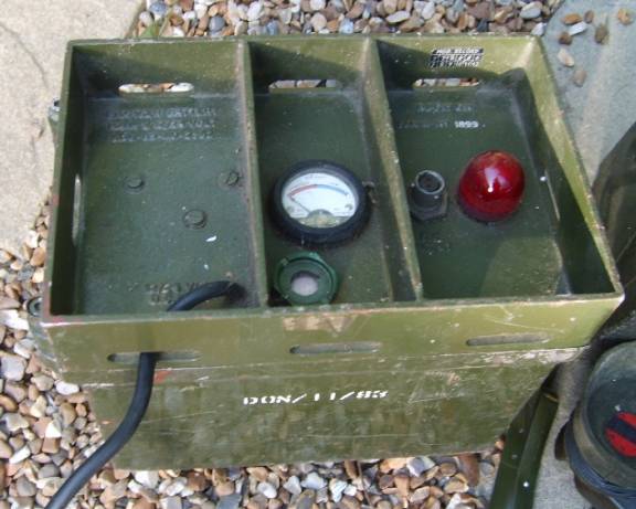

mk123-01
A43R Radio units
Redifon A43R MKII accessory 3
Redifon A43R MKII with accessories
Redifon A43R MKII-top view
