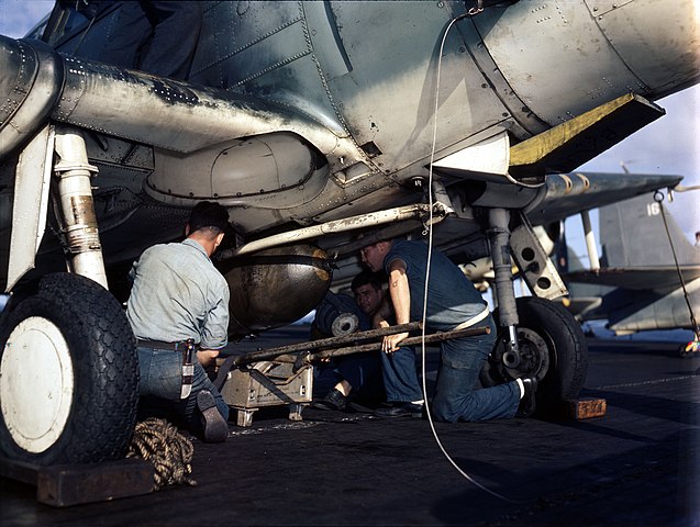

On USN/USMC SBDs, the wheel wells were painted in the same color as the aircraft undersides.
Army A-24s may have been different.
