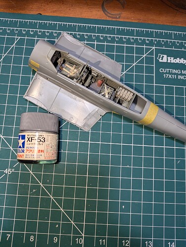

I am trying to decide if I should prime my 1:32 Stuka with a Alclad II lacquer primer or Tamiya acrylic paint thinned with Tamiya lacquer thinner. I am leaning more towards Tamiya lacquer since it seems to airbrush on smoother. I inherited a bunch of 23ml paint and have a few bottles of XF-53 neutral grey that would seem to be ok with a coat of RLM 78 and RLM 79 over it. What would you use? used alcald in the past but it seems a bit grainy, could be operator Error :monkey:

I would go with what I was more comfortable with, which seems to be Tamiya in this case.
I would do few tests on plastic spoons or something else to see which “primer” color (white, grey or black) works best for the look you want. Depending on the top coat color thinning and number of coats, the base primer can and probably will have an impact to the look. Only you can decide which one/s works for you and what you want out of the project.

Thanks for the reply, going with a darker grey would probably give my light colors more depth.
Yeah that’s a good move because likely or not, most of these birds had a two-tone green splinter underneath the desert colors, so you’d be doing something very close to what they did in the field.

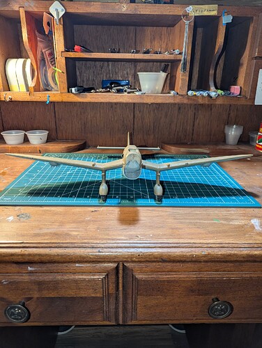

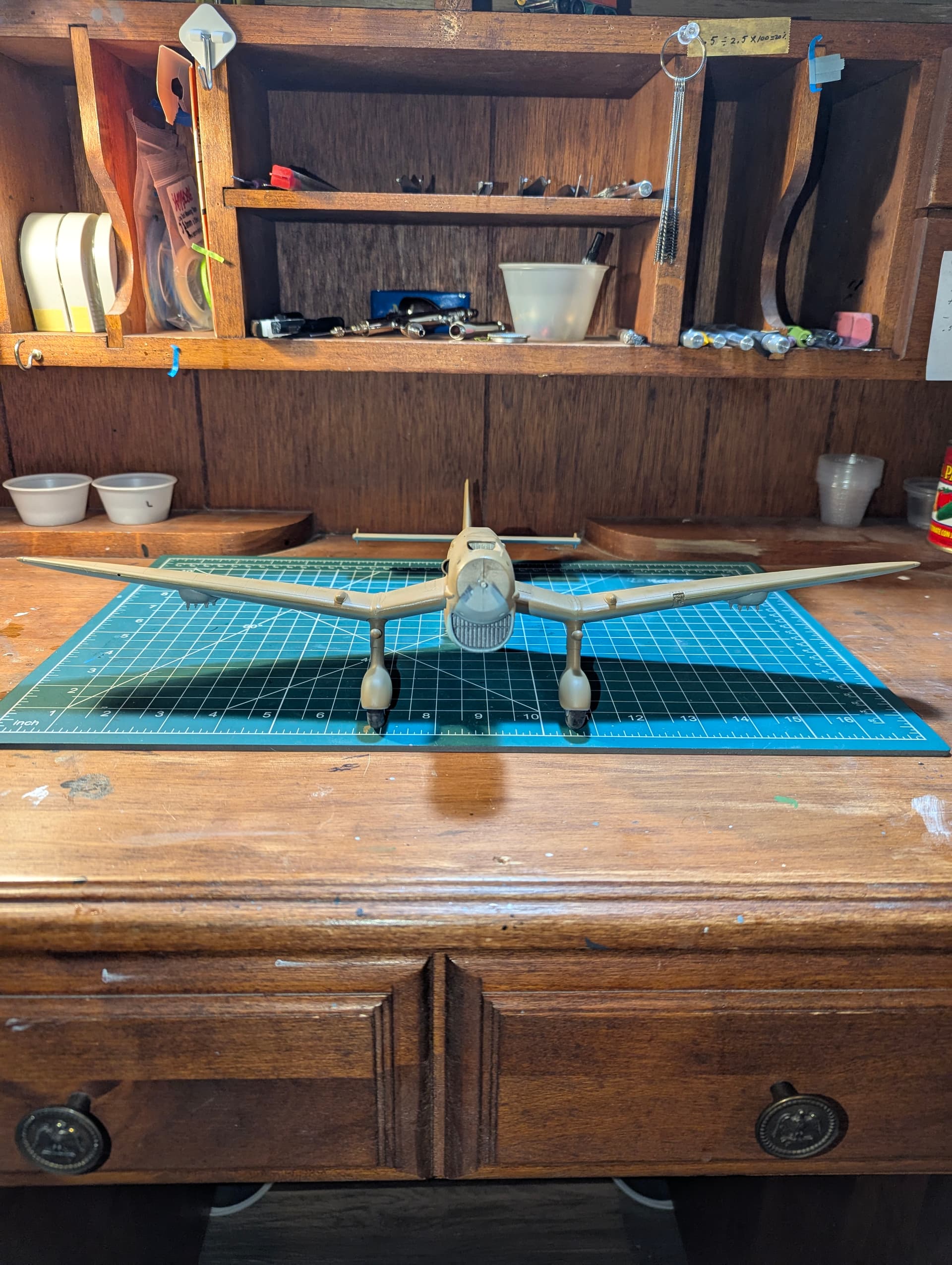

well…9 months later I have returned to this fine model.first time working in 1:32 scale, easy build very impressed with the quality of this iconic plane.Had to lay off during the winter my hobby room paint booth was to small for this enormous beast.
