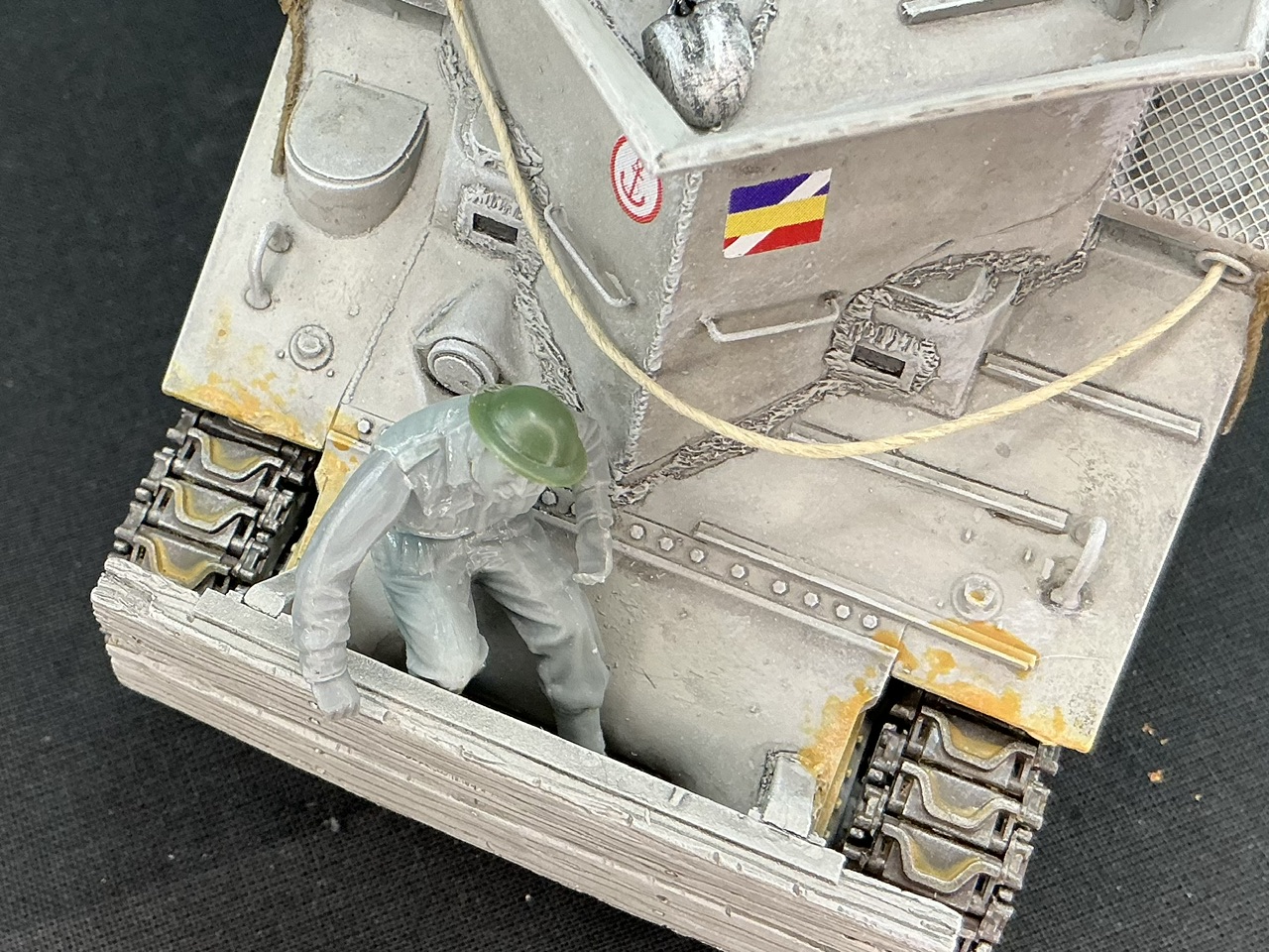

It took me a while, but I put together a figure from a Bronco war reporter, Tamiya British infantry arms, and an Italeri helmet (because the shape of the Bronco one looked off, and turned out to be off when I measured up a real one I own):
I still need to fill his armpits, as his new arms are spread much wider than the parts were designed for. I’ll put a D-clasp on the end of the rope and put that in his left hand, so he looks ready to jump off the BARV and hook it up to something.
Very nice. He looks just right.
From this angle, yes :wink:
I wasn’t happy with the sand effects I had achieved on the suspension, hull front and tracks, as it just wasn’t heavy enough to represent built-up sand despite mixing thick acrylic gel into the paint. So, I added some more gel, but now a type that has a grainy texture in it:
Of course, once it’s dry it still needs to be painted the colour of wet sand.

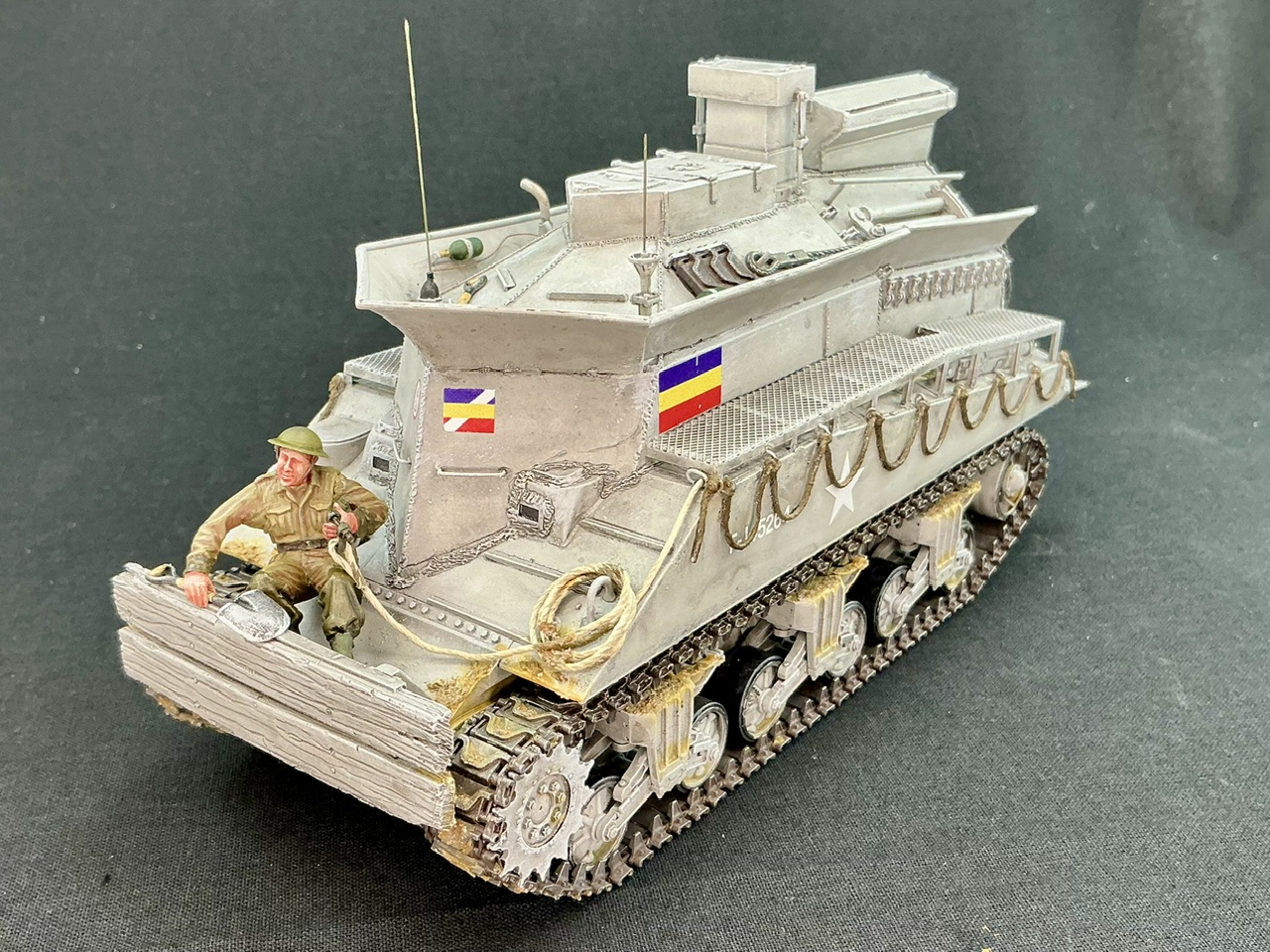

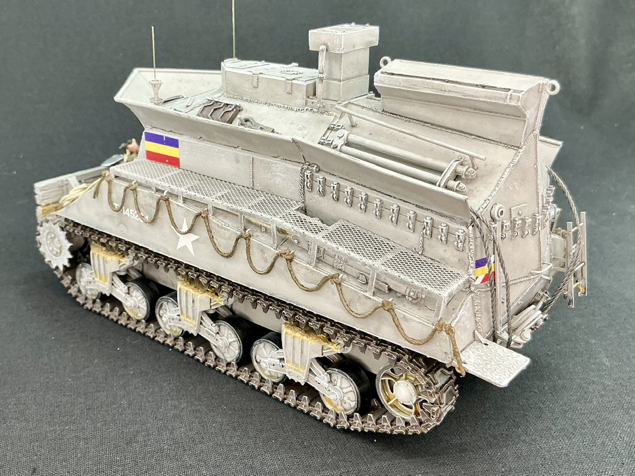

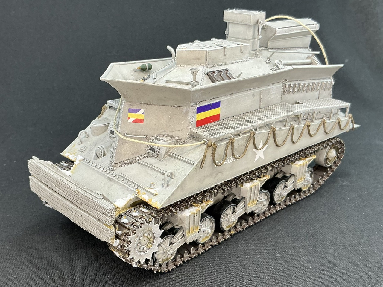

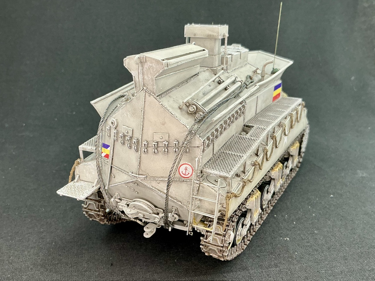

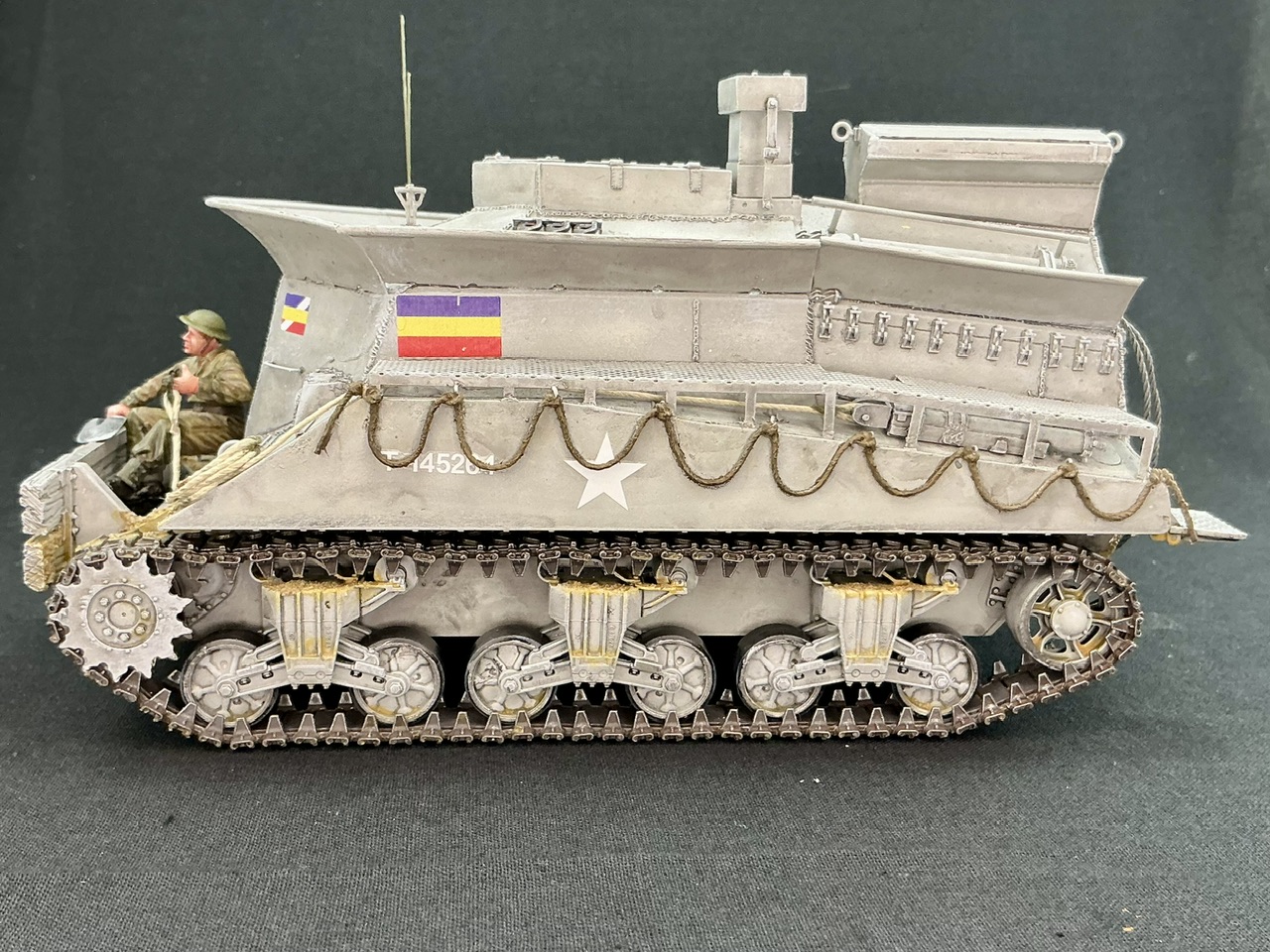

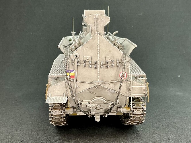

It’s now finished!
