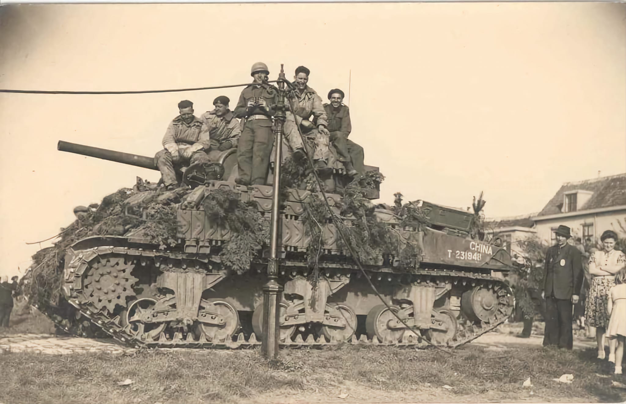

For the Lord Strathcona’s Horse (Royal Canadians), they were issued with M4A4’s Sherman on arrival in Italy, and most continued to serve in NWE. Here is a C Squadron Tank of the Strathcona’s in Holland 45, for reference…

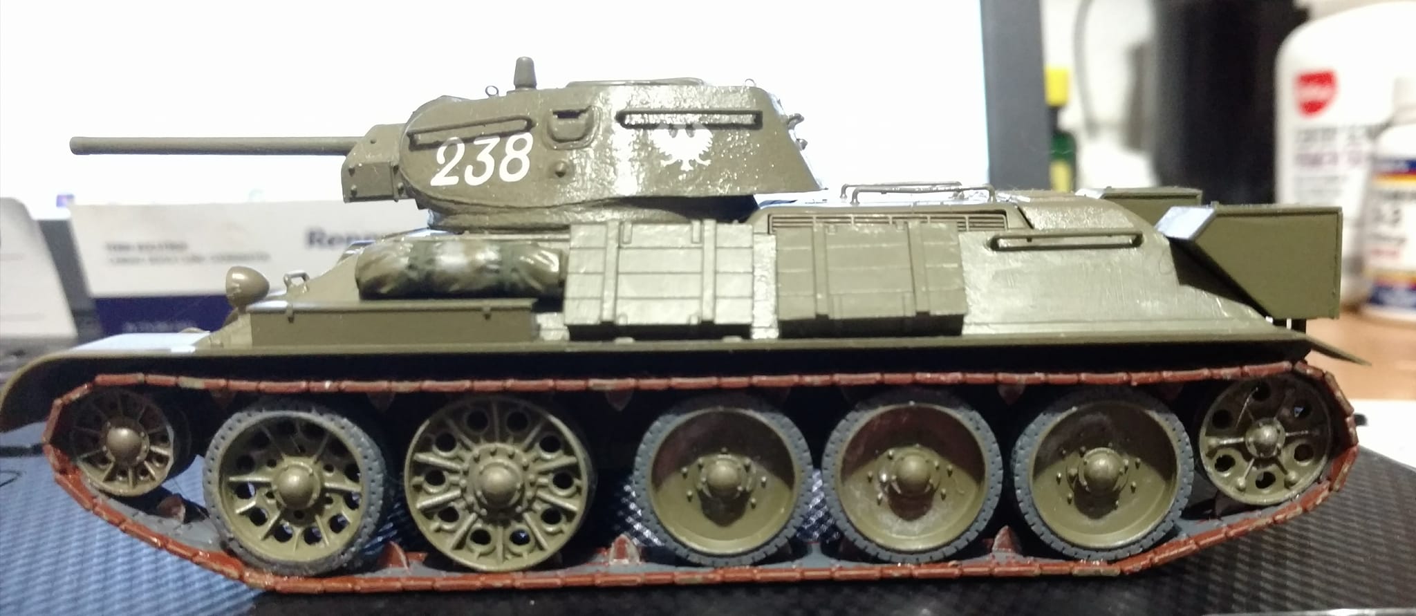

Besides what the factory used at the time there was always the field depot factor. If road wheels needed replacing (damage, wear & tear) the depot would use what they had. If there was an oldr version in the heap and it was useable … They were all interchangeable. (Soviet T-34 was the same. Late war could have a mix of all types. WIP: T-34 Obr. 1942. 3d Co.,2nd Regt. 1st Tank Brigade. 1st Polish Army. , Magnuszew , Poland. Aug. 1944. with early, mid war road wheels ) Here’s some info on VVSS suspension/ rod wheels. Also, go to the home page and search the M4A2 section for the Sherman III info. Sherman VVSS suspension (free.fr)
