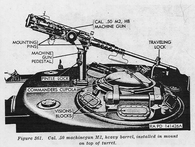

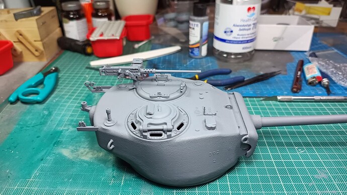

Don’t want to rain on your parade, but you might want to remove that handle on the M2 Browning. That represents a modern M2A2 with the QD barrel.
Older versions (M2/M2A1) lacked that handle.
That is is easy, never bothered to look into it. The only detail I checked for the .50 cal was the ammo box and its carrier.
Thanks for pointing it out, will do it asap.
I used these two illustrations as the basis for correcting the .50 cal and I also downloaded some manuals.
And ended up with this configuration (I had to add a block of styrene between the ammo box holder and the gun in order to make the assembly sturdier.
I think the second one is the one supposedly supplied with the kit.
That’s an M23 “Equilibrator” Cradle Mount.; the big cylinder part has a spring that balances the weapon while the vehicle is running through rough terrain. This mount is the most common cradle mount used for the .50 cal on American/Allied vehicles during the war. It is still in use today, next to the current issue Mk64 mount.
