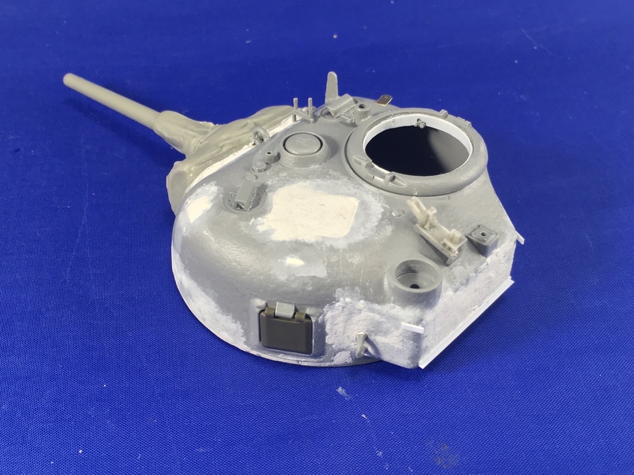

  • Remove all traces of the loader’s hatch
  • Remove the radio compartment on the back of the turret
  • Replace the gun barrel and its shield by a regular 75 mm one (if you don’t have a spare shield, you could modify the 17-pounder one: raise the lower edge on the right only and add the protectors alongside the barrel)
  • Remove the cover over the bow machine gun and reinstate that
  • Remove the gun crutch on the engine deck
  • If the model has Houseboat fittings, delete those
I think that’s it, off the top of my head. It’s not a difficult conversion, certainly not if you have a spare gun and shield, and should be easier in 1:72 or 1:76 than in 1:35:

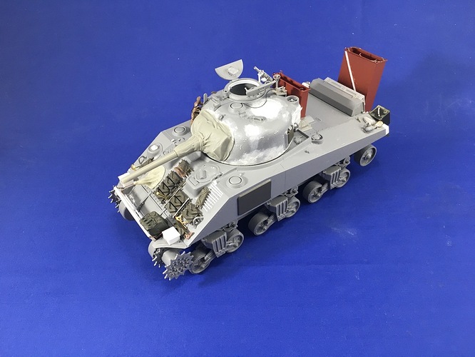

This is RFM’s VC kit backdated to a regular V (with deep-wading gear and some modifications specific to a particular, real tank) which I did some years ago because Asuka’s Sherman V kit was impossible to get and RFM hadn’t released their basic Mk. V kit yet.
The 17-pounder Sherman was built on three versions: first the Sherman V, then also on the I and I Hybrid. All got the letter C added after the mark number once converted, so VC, IC and IC Hybrid. “Regular” ICs appear to have been the rarest, though.
