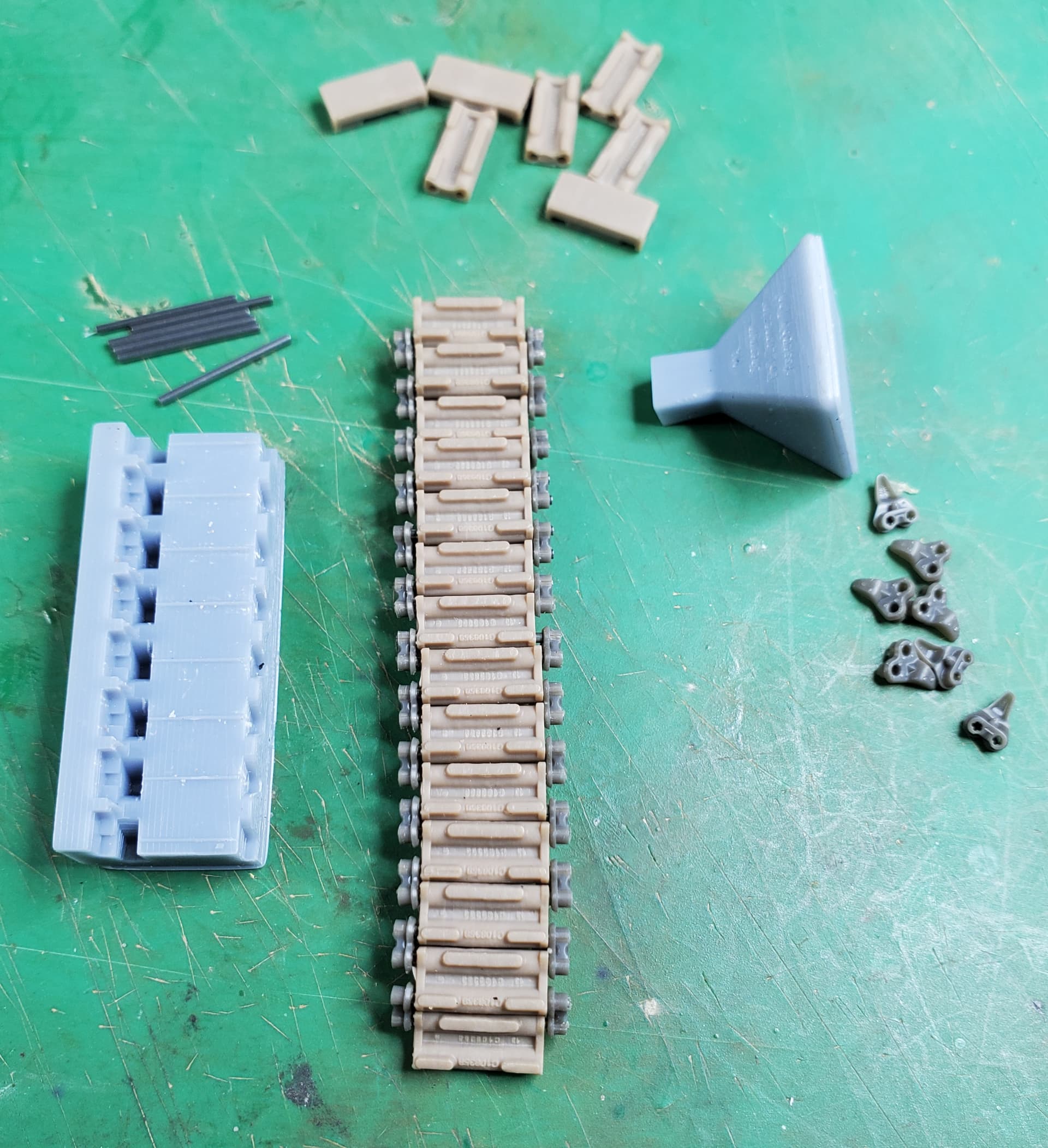

A little while ago I called my IDF M1 Super Sherman ‘complete’ for this campaign, and I stand by that decision. Since then, I have decided the T49 tracks were not up to my standard, nor the application to the finished vehicle. In the meantime, the search was on for better aftermarket tracks. I found E.T. Model to be the answer. The tracks are very durable and can withstand a bit of rough handling. The ‘locking’ feature of the track ends over the metal rods is exquisite…being felt as they are engaged to the metal rods. Although the set is well engineered, they are still single links. They will take a tedious amount of time to complete.
Jack those look spectacular! I’ve got Masterclub VVSS tracks that I think are excellent, but these look even better. You push the end connector onto the steel bar? That’s prototypical. Amazing! Going to order some of these right now.

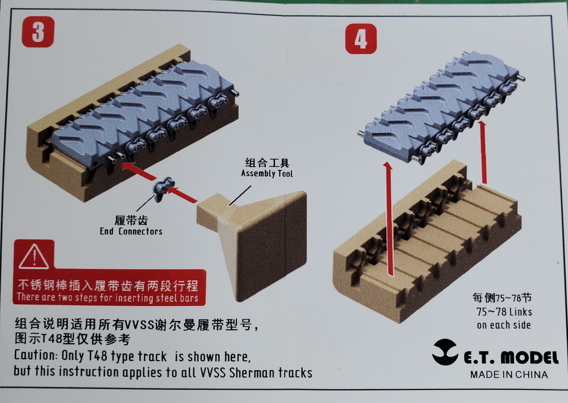

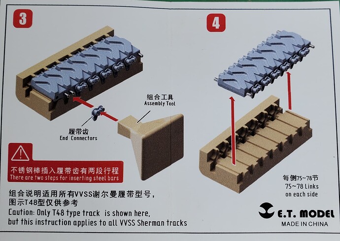

Yes, starting with end connectors placed properly within the jig, place the track face up, install the rods into the track links, then push end connectors on the outside over the rods until you feel 'click(s)/solid resistance. It actually ‘seals’ both end at the same time (at least that’s the way I do it). Everything is indexed and dummy proof. The flexibility afforded after assembly is remarkable. I’ll be able to ‘sling’ the track around at ease for paint/weathering and not fear tearing up the assembly. The instructions I included show the illustration of what I explained in words. Very simple, but tedious.

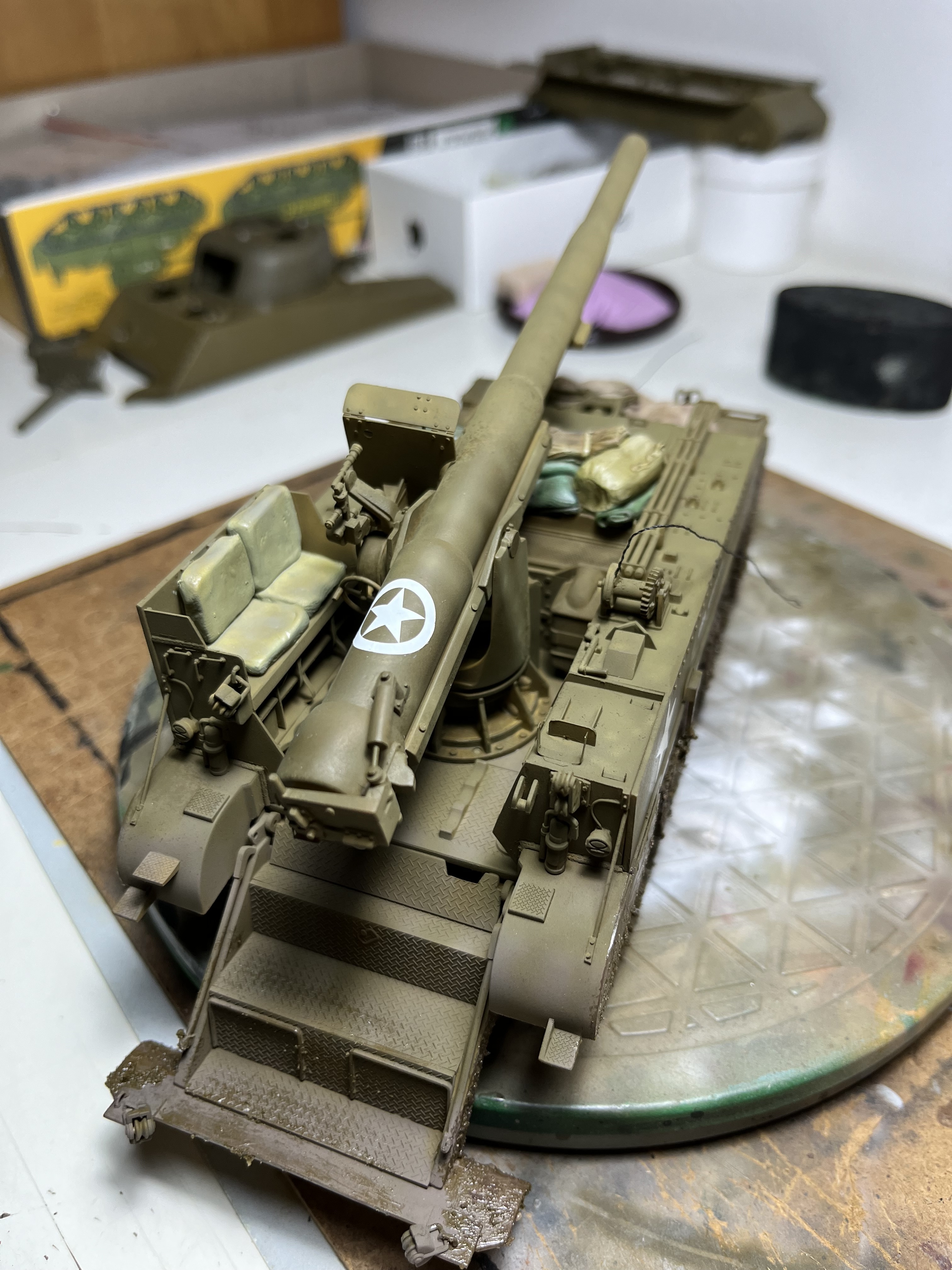

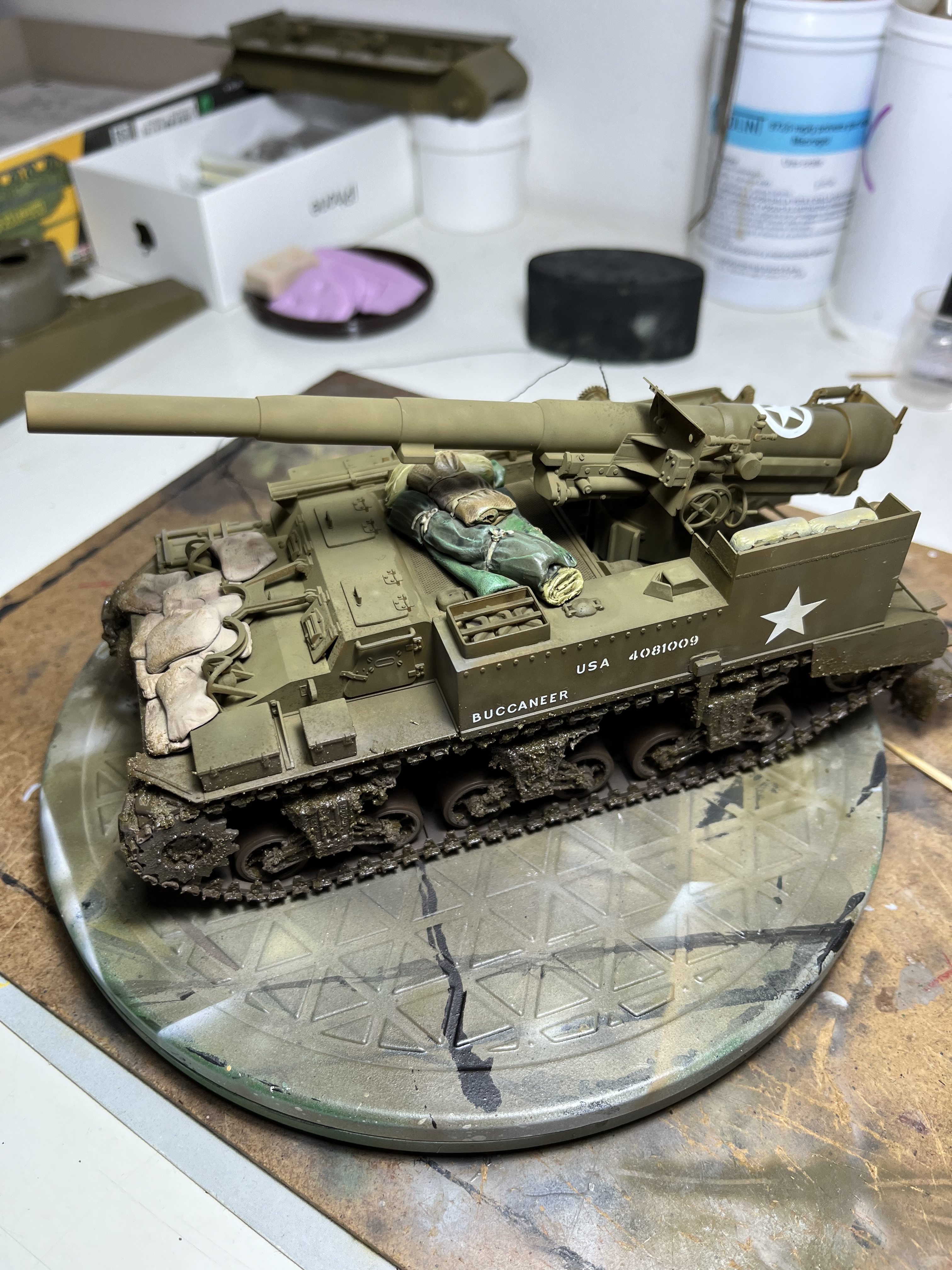

And a bit of M12 as well: started to weathering and made some Easter eggs as well to liven it up!
Cheers Pals
Sorry, no pics!!
Ok, here they are…

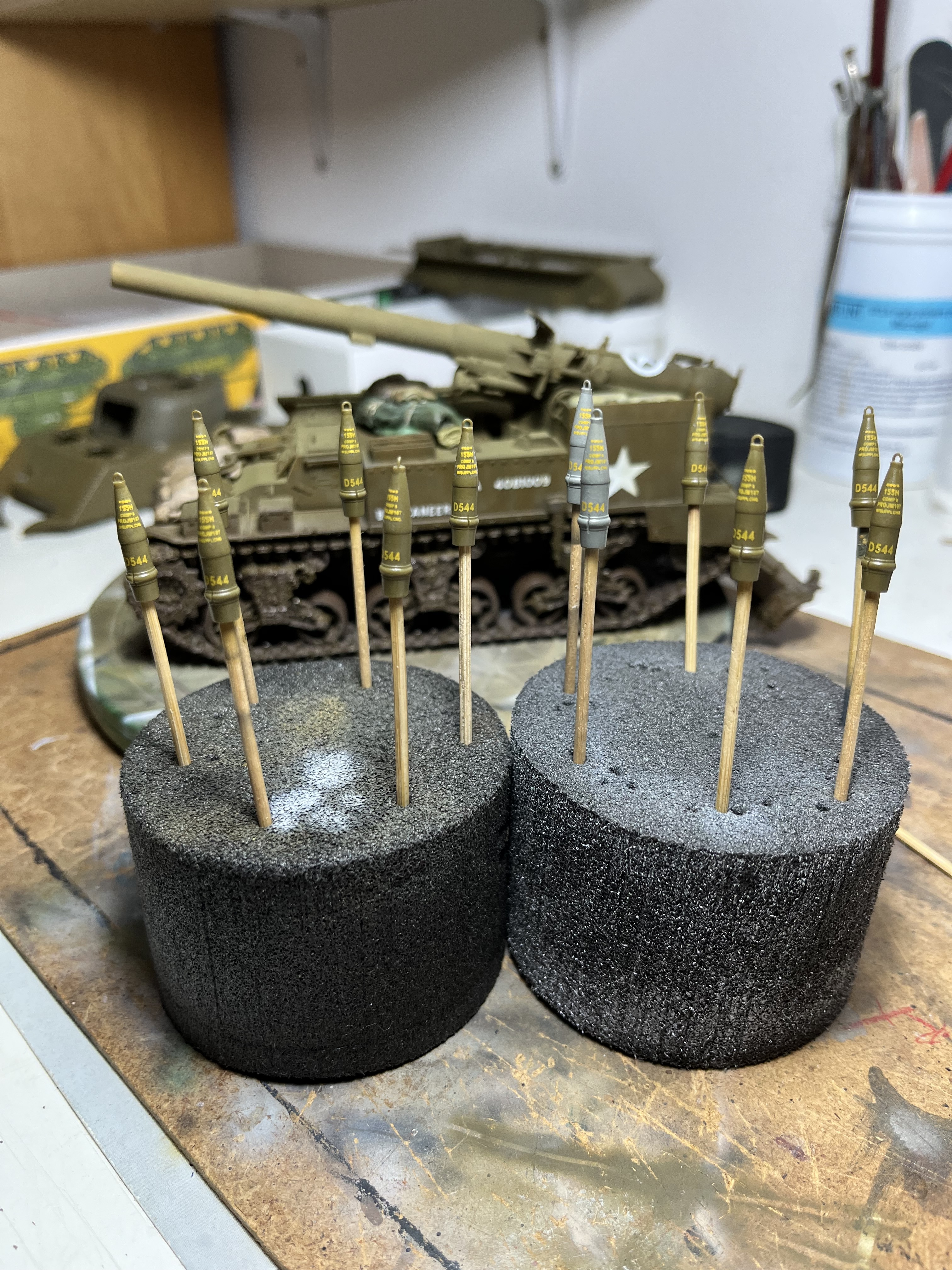

Can i get info on where the ammo and espically those decals came from?

Hi Michael, it’s AFV Club set 35017, including 155 and 203 mm (8in) ammo, fiber tubes and full set of decals. Brass ammo of both calibers are also part of the set, depicting the projectiles ready for shooting, that is with the fuse and the rotating rim exposed.
