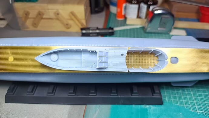

I started by assembling the hull and trying to figure out how I could add whatever detail possible.
There was a fret of photoetch decking supplied but only had the deck plank lines lengthwise.

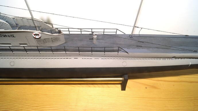

This is the finished model. It is 85cm long so photographing the entire model was kind of hard.
I should not have used the thread I used for the rigging of the radio wire antennas but at first it looked very nice but after vanishing the model it looked horrible.
Overall there was much work involved into making this model that does not show in the end product. Since it was a prototype I am happy with it and in the future there will probably be a second version of the same model, with all the corrections, updates and improvements that will be done to the 3d desing.
