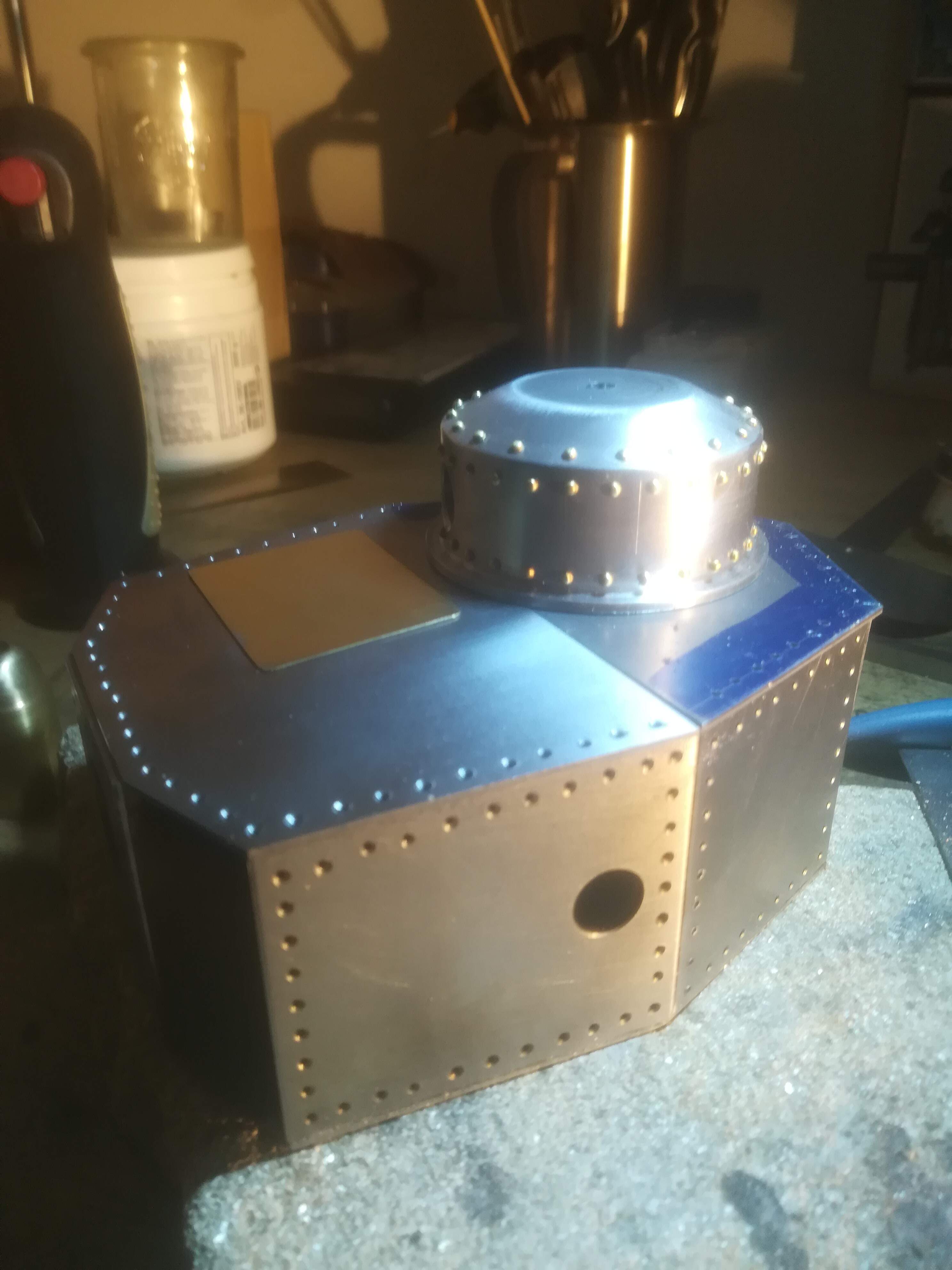

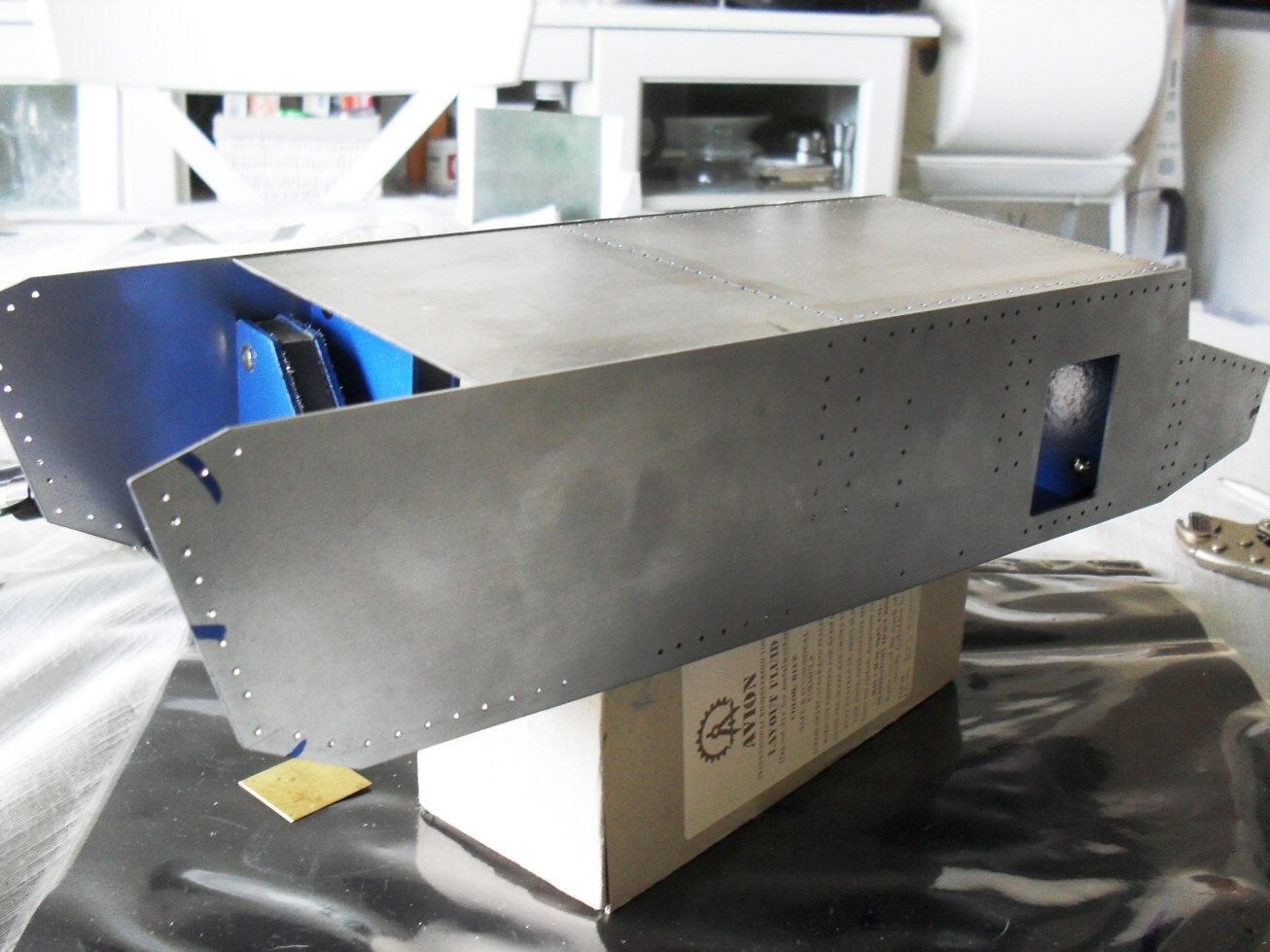

All the pieces were marked out on one large 1.2 mm sheet and cut out with a jigsaw. These were then filed to shape and any cutouts or whatever made.
And once all the shapes were made, I filled the creme brulee torch with gas and set to work solderingthings.
