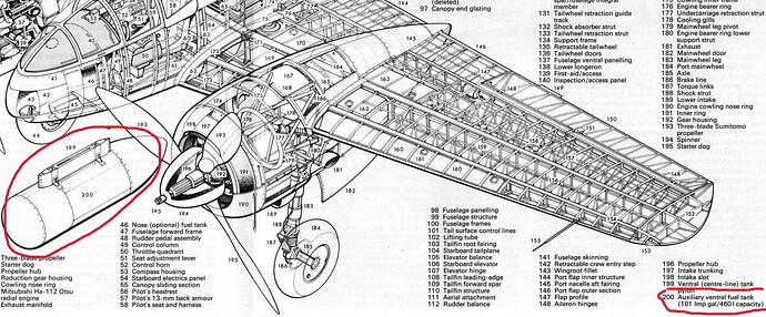

What was the capacity of the centerline fuel tank carried by the Ki-46? Also, the ones configured for Special Attack, what would the observer’s position look like? I’d imagine the camera gear would have been stripped out. Radio gear? Would the position even have been manned?

Oops! Thought I posted this here … 101 Imp Gal. / 120 US Gal. / 460 Liters. Was trying to figure out the weight capability of the center line rack. There were two racks for Ta Dan cluster bombs to either side of the center line. These bombs were 60 kg (?) Not a very useful load for a "special attack " against a ship. The center line should be able to hold a 250 kg (or with some reinforcement, maybe a 500 kg for a “one time” use. As for the observers area, lots of space back there, especially with the camera mounts yanked. Would think they’d’ve crammed explosives or gas (a flying Molotov cocktail!) in the space . Guy in back? Would be only for bragging rights , I’d guess. Thought I read there was no radio. (was common to get extra range with A6Ms in the Solomons. )
3821e14c4c7760f799778eb6da5cf|690x286](upload://2wxoqJnOPGw1UNX7ckD3ZjzUW71.jpeg)
I love those diagrams and cutaways. Growing up I wanted a job illustrating such. But I never had the skill or the patiences.
