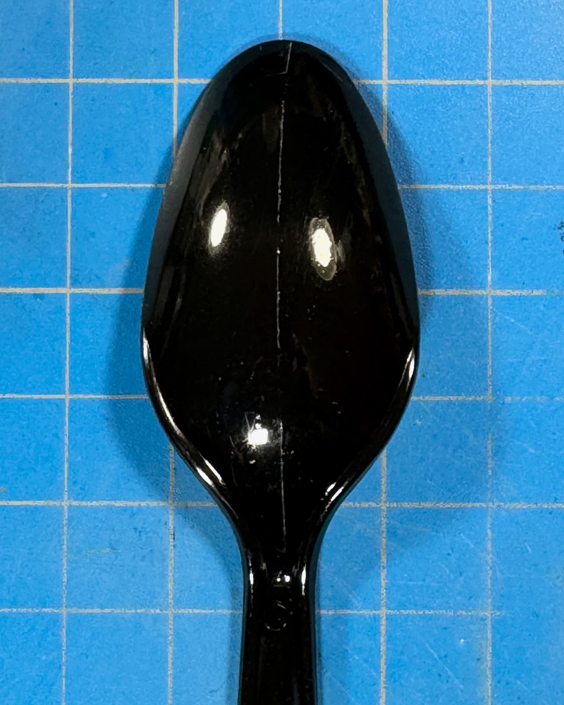

Next, I did a couple of masked-off spoon tests using ‘Holloway House Quick Shine.’ Results varied, but I think this one is pretty good…
<<< wax OFF… wax ON >>>

Interesting experiment. The spoon up there, is the right side the floor shine pump sprayed over black plastic spoon or over gloss black painted spoon?
Did you still have to clean out the pump sprayer?
Ah-ha! What trickery is this? … Is the spoon half empty or is it half full? :thinking: :grin:
Answer: The left side is untouched and the right side has been varnished.
