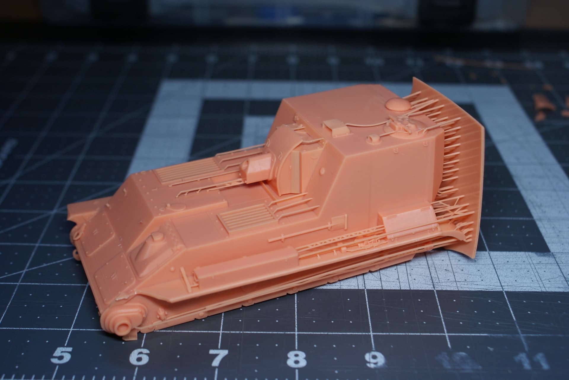

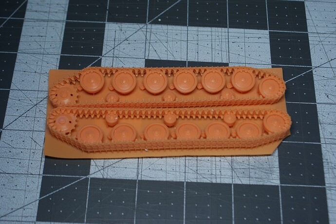

You will get a big slab of printed resin, with the suspension and tracks as a single piece, if not already attached to the hull. There will also be a handful of loose pieces that needs to be attached, but in general 20 parts or less. The printing “trees” break off easy and clean up nicely. Print striations appear minimal and should disappear with priming/painting.

Gino, I picked one SSModel, the T1E1, to check them out. The kit arrived fairly quickly. In spite of being well packed, it had some breakage. The resin is very brittle. The design was simplified and had several accuracy issues. The printing was decent - print lines fairly minimal. The tracks just didn’t look right, and it took me a minute to figure out why. The track links were all sharp 90 degree angles. Every edge on every link would need to be sanded to take off those sharp edges.

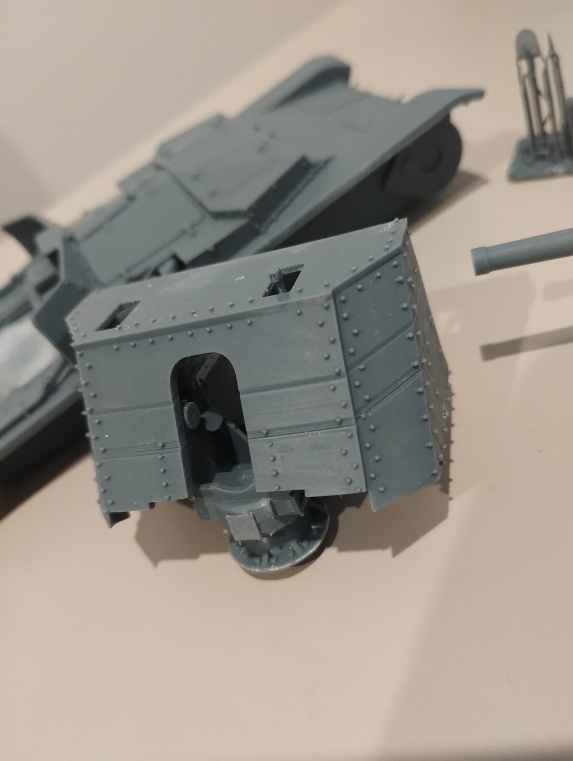

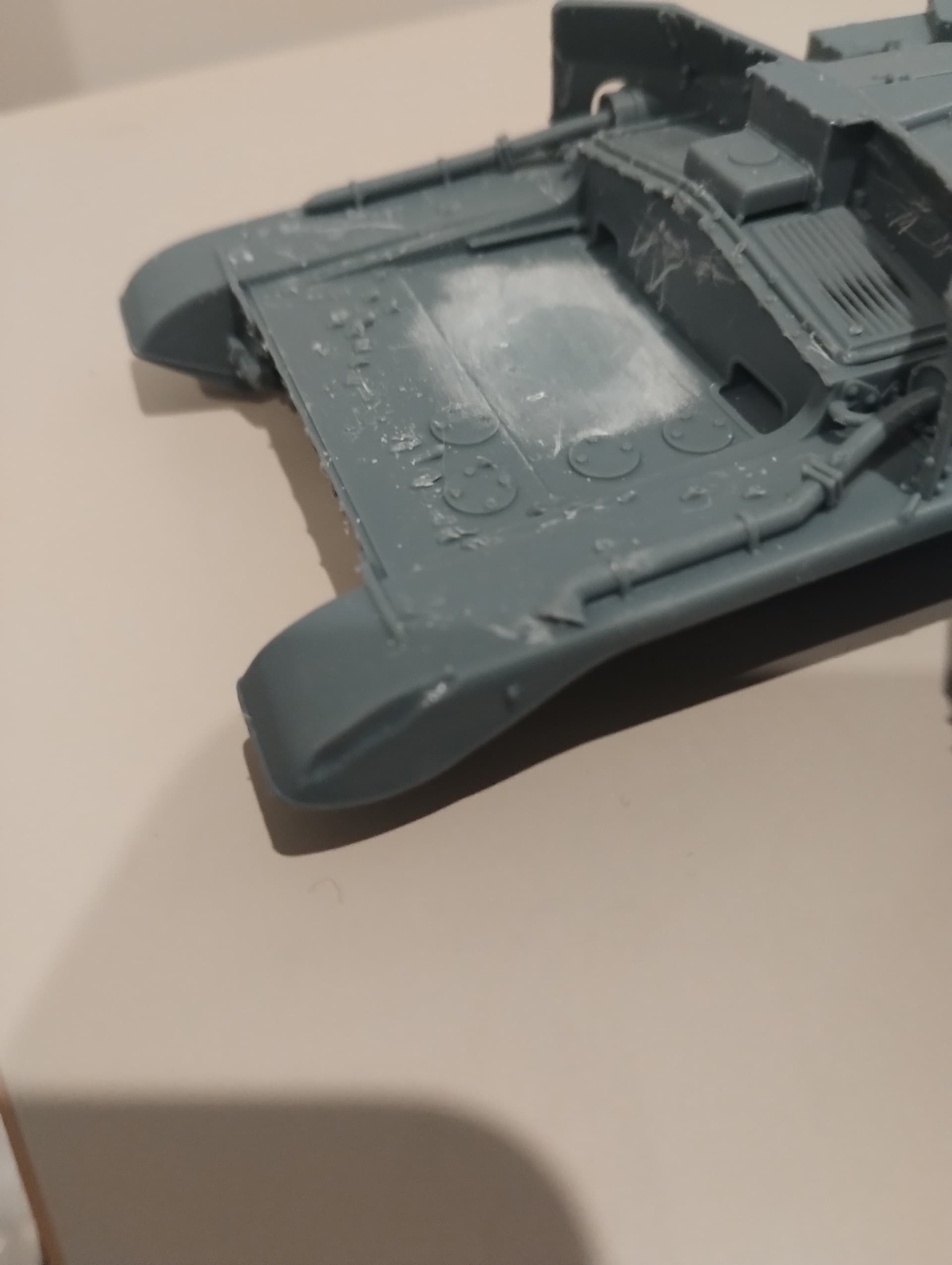

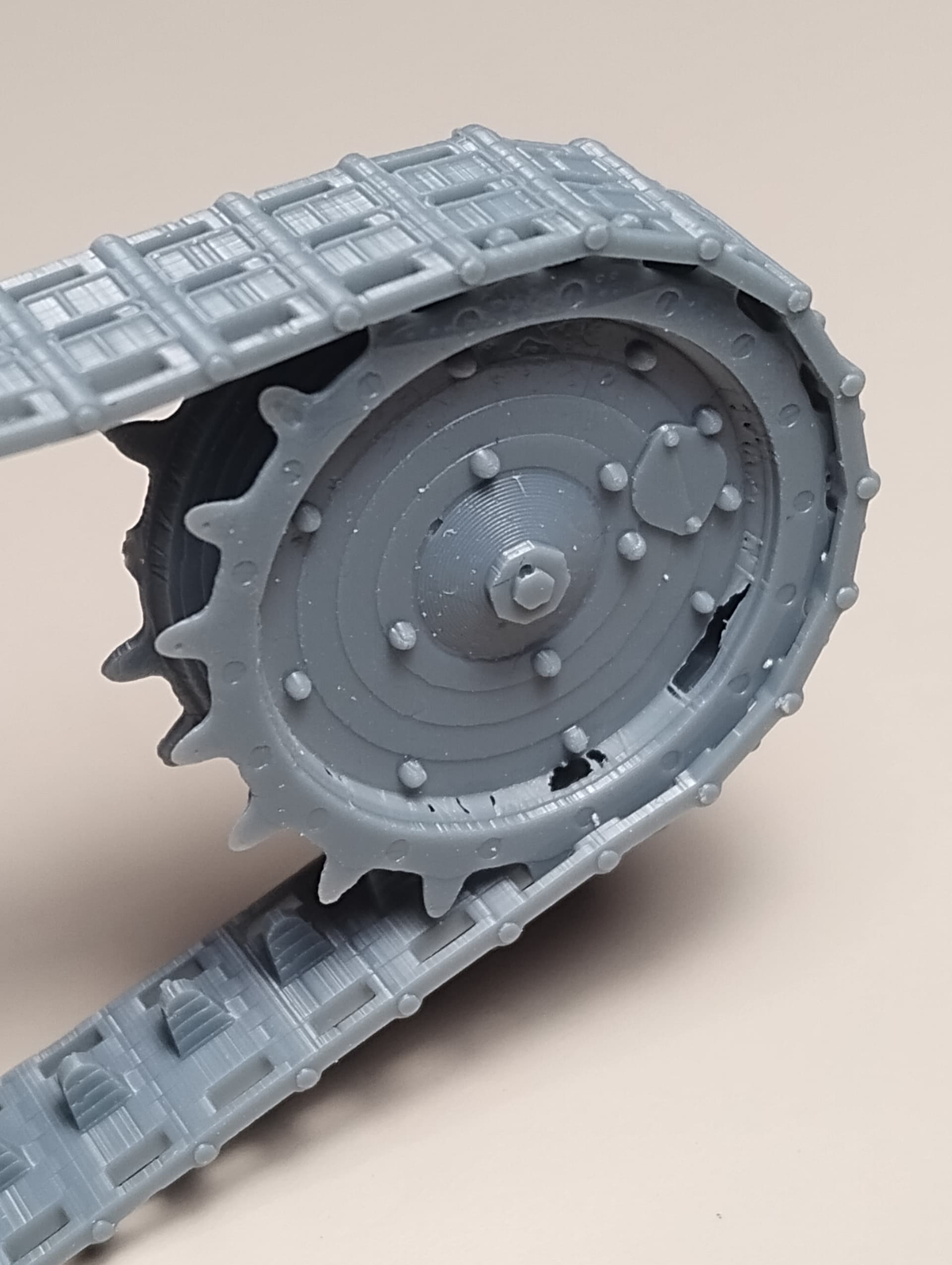

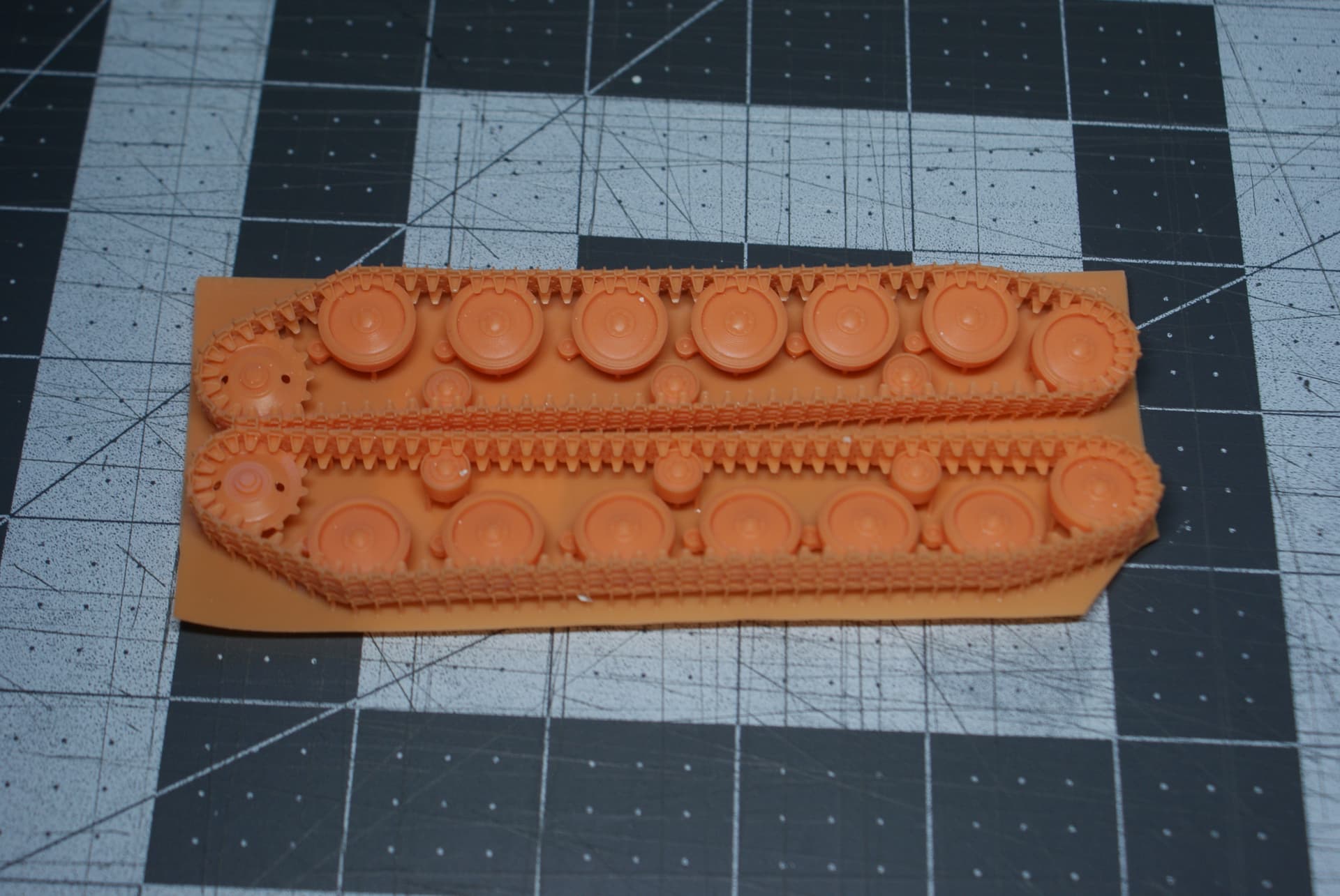

I’ll attach some pics of some of the issues.
First pic has some pretty deep lines in what should be flat panels, second has resin missing from corner of the mud guard. Third pic has holes in the sprocket wheel and is very thin all around.
I’ll try and fill them with putty.

Also with the kits I purchased, they all have warped track/wheel assembly.
Any tips on how to straighten the resin out would me much appreciated as I’m just about ready to bin them all!

You can try heating them in hot water, which softens the resin, and gently bending them into position. Hot air from a hair dryer also has the same effect on the resin.
I’ll give it a go.
Thanks
Be sure to give it enough time for the heat to penetrate into the parts rather than heating up the outside only. But be careful you don’t heat it too far that it will flop all over the place.
