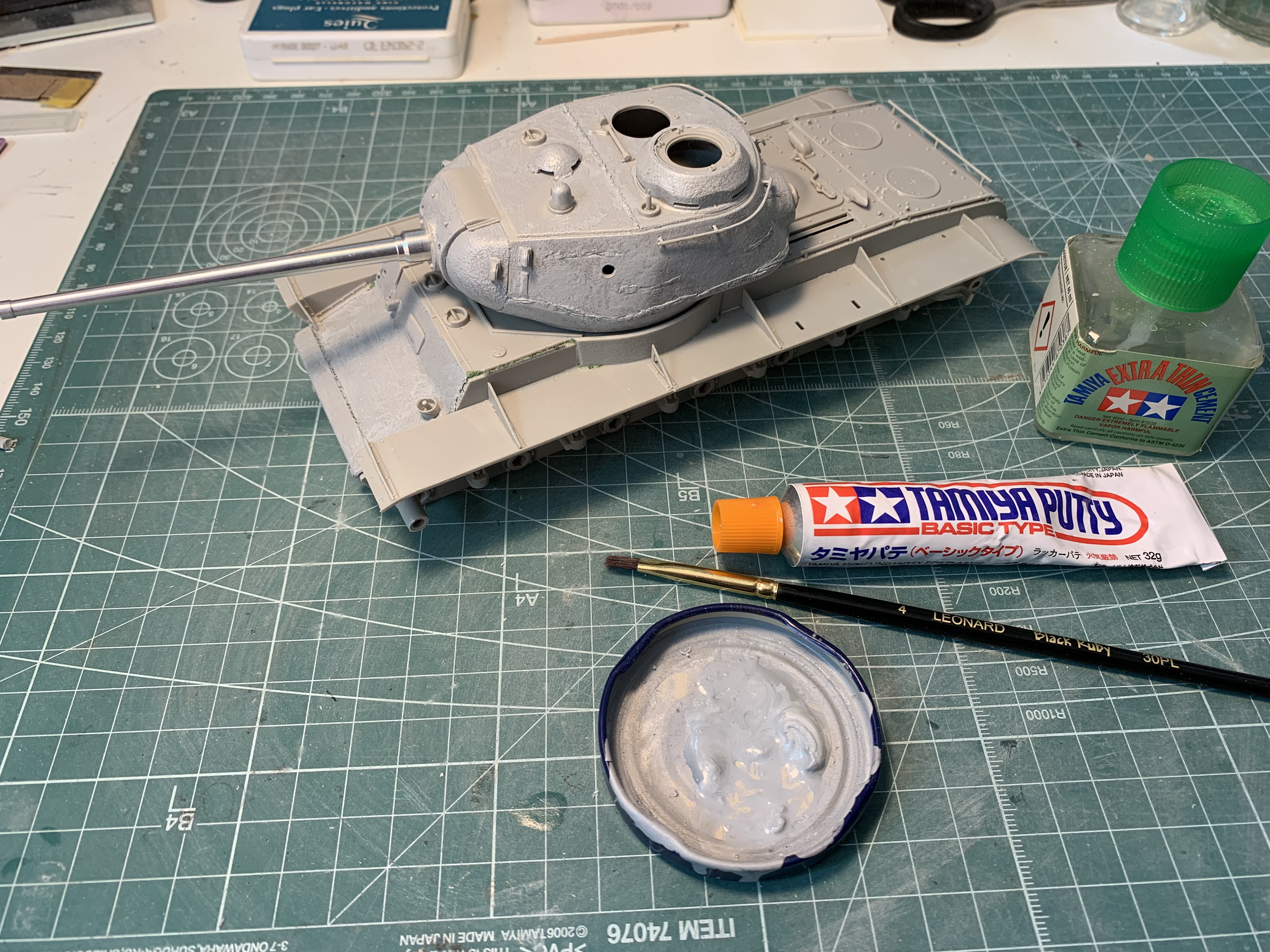

I’m starting a new project based on Trumpeter 1/35 KV-85.
KV-85 was a transitional tank based on a slightly modified KV-1S chassis and the future IS-1 turret waiting for the new chassis being fully developed and produced. It was produced in relatively small number (about 140 units) and introduced in august 1943 just after the battle of Kursk.
IS-1 turret was close to IS-2 one but with a 85mm D5-T gun (also equipping T-34/85) as the 122mm D25-T gun wasn’t yet developed.

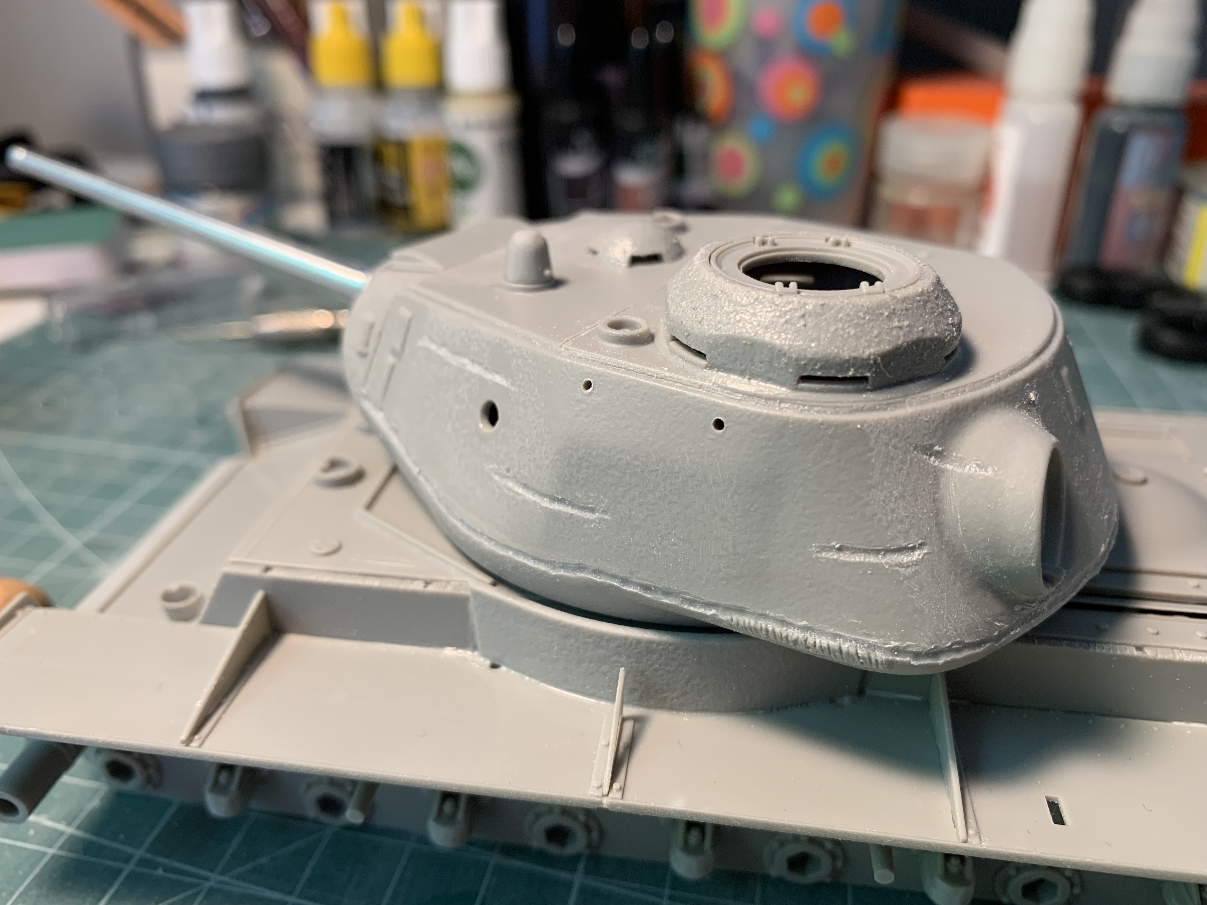

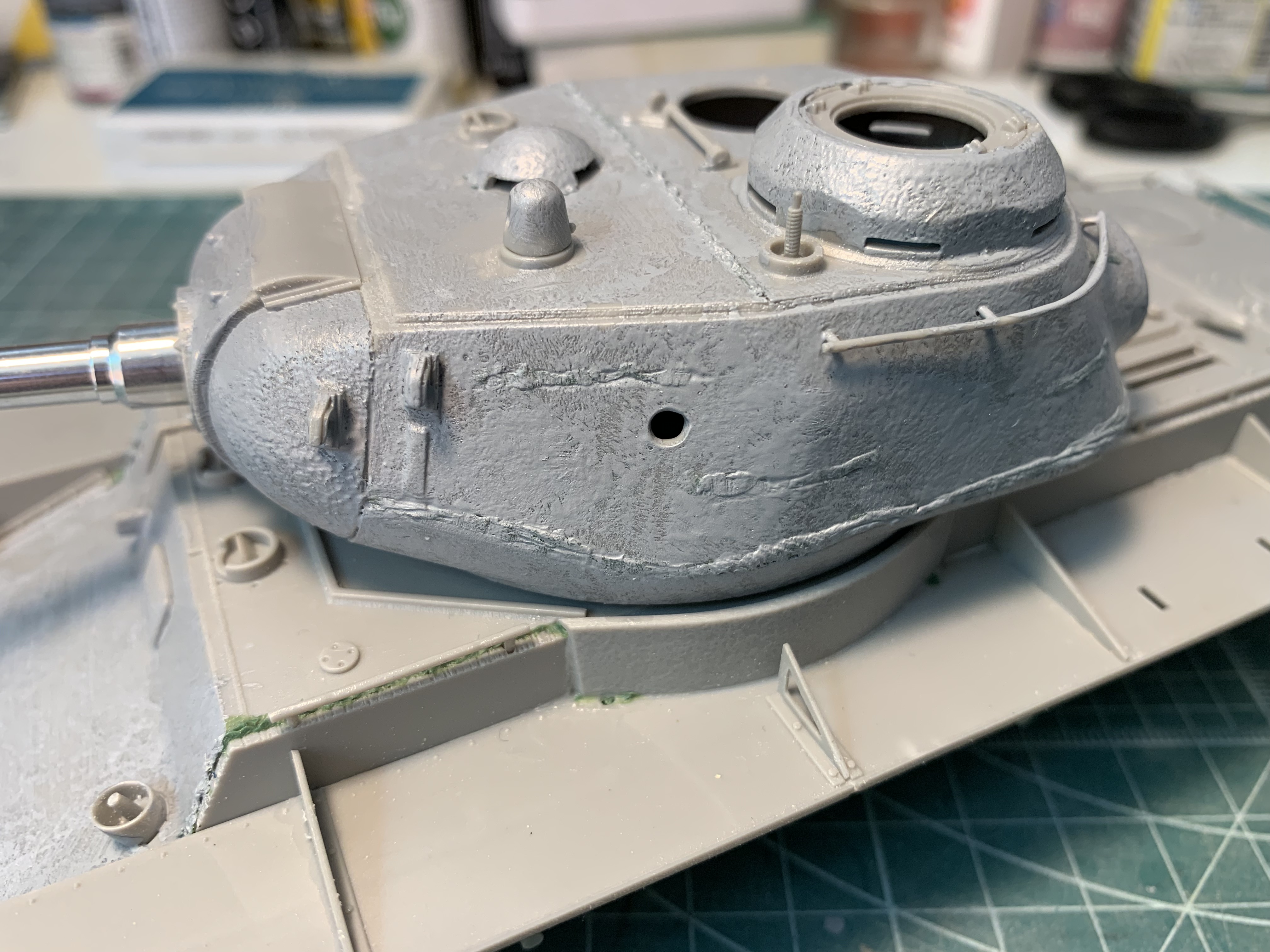

Noticing the heavy casting and some kind of molding scars on the turret I modify Trumpeter pieces to try to replicate these specific textures.
Front bustle was texturized using Tamiya glue stippled with a hard brush, molding lines and “scars” reproduced with a Dremel and filled with epoxy putty (2 components) then covered with Tamiya grey putty diluted with Tamiya extra fluid glue.
I’ve added the welding seam line on the turret roof which is missing on the original part.

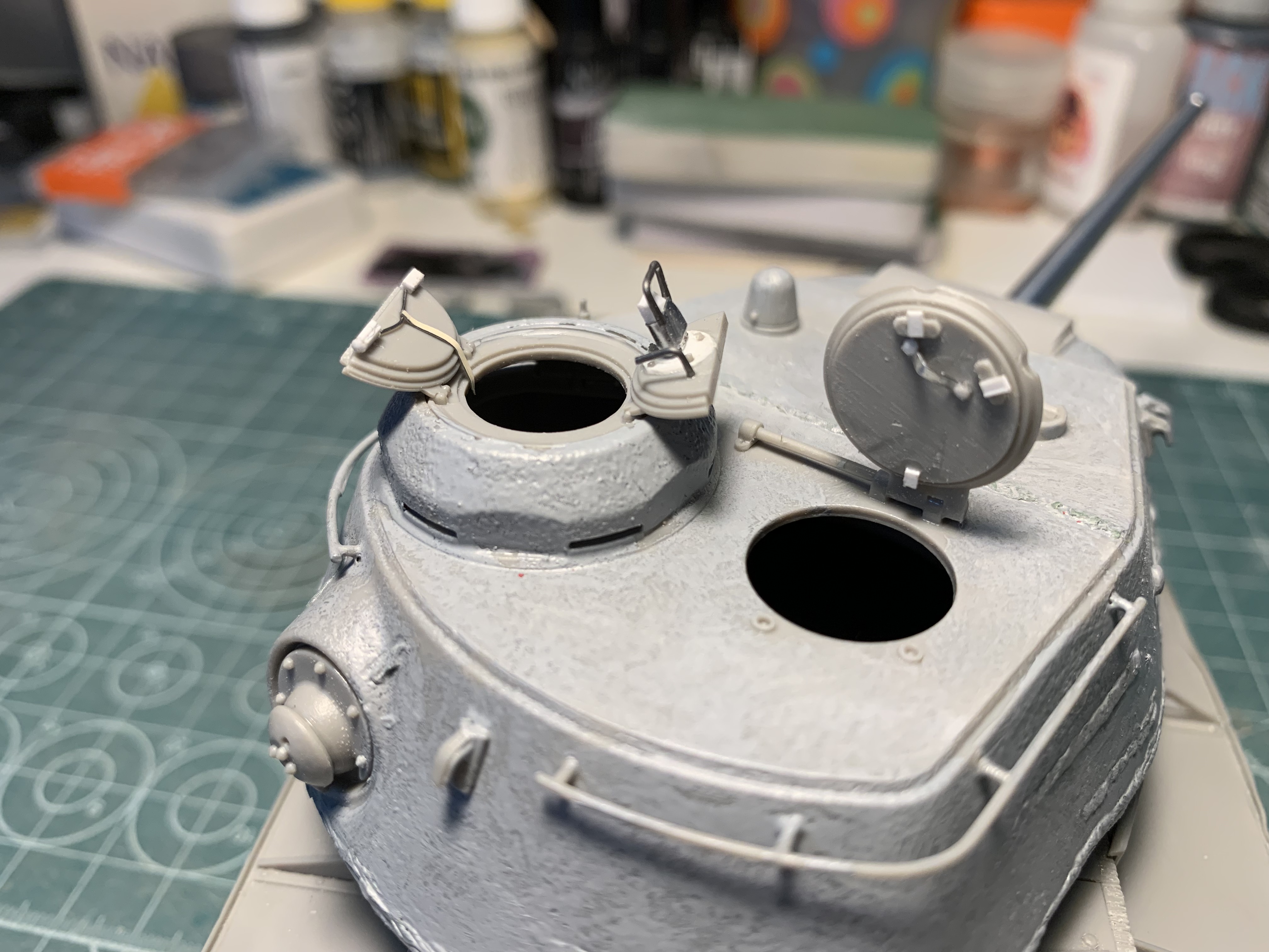

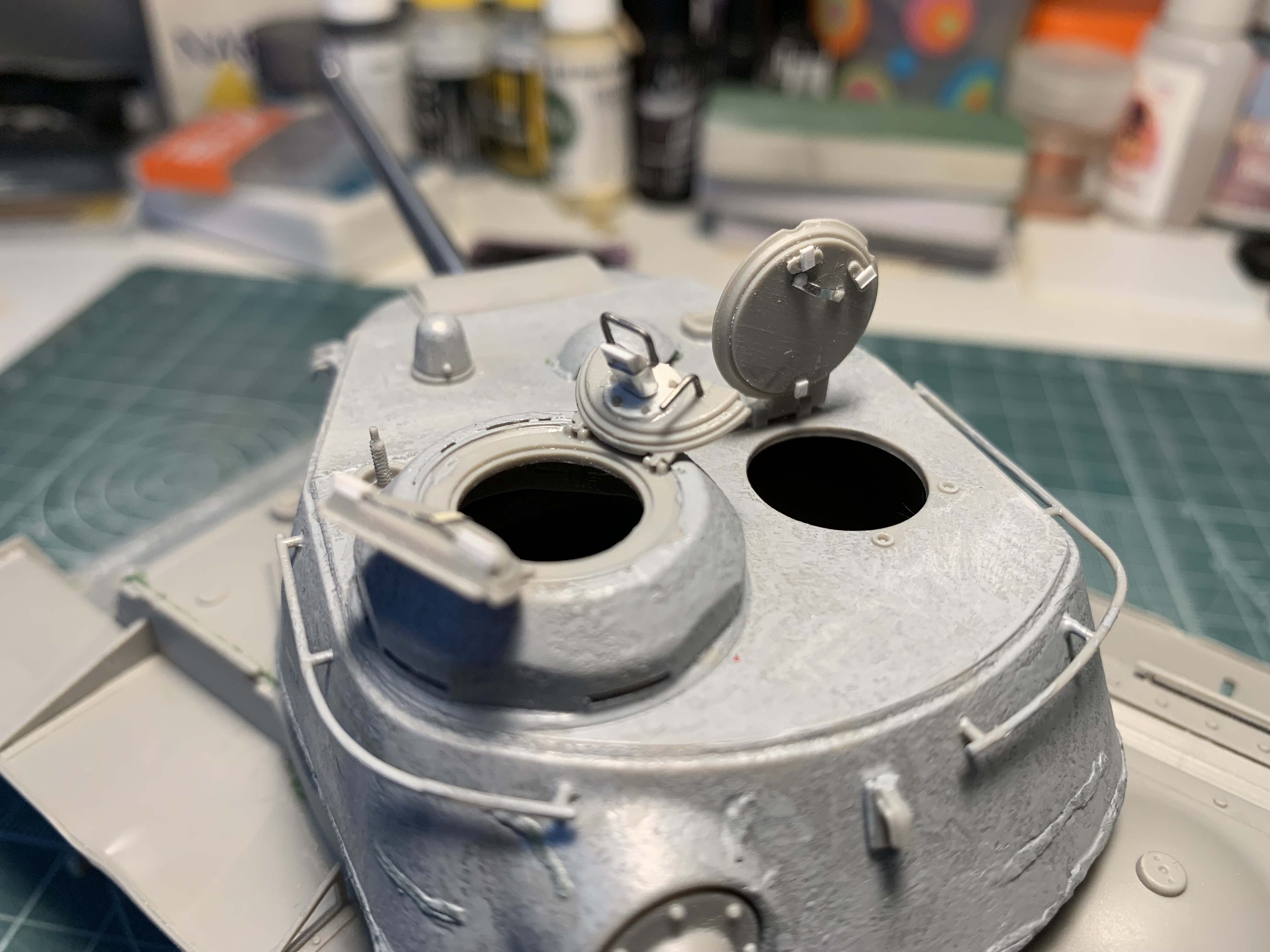

Goinf further detailing the missing details on the inner side of turret hatches.
You are putting some really nice texture work into this. :+1: :+1:
