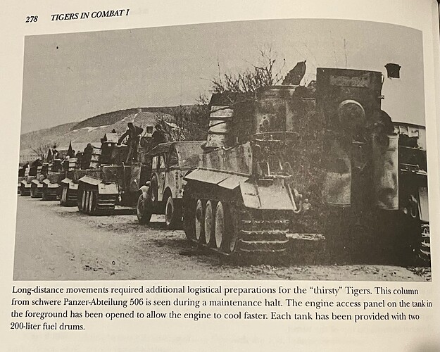

The only pics of Tigers with any extra stowage that I’ve seen are a column of Tiger 1s advancing towards Normandy, each with a 200L barrel or two of fuel on the rear deck for refueling at rest stops on the march. Otherwise they seem to be kept pretty clear of baggage. Then again, most German vehicles seem to be uncluttered compared to Allied ones, so I think it’s a cultural thing among German armoured units.

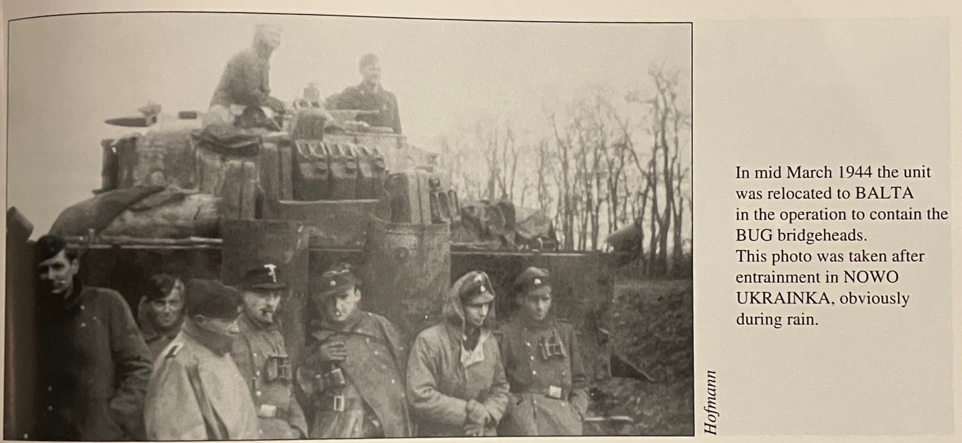

the gentleman really nailed it. There is a great photo of a tiger Battalion in Russia, circa 1943 winter. They, (I believe there are f tigers in the shot), have fuel drums lashed to their engine decking. How I don’t know or want to advance a theory. But I will try and dig up the shot
The overall majority of Tigers are generally devoid of any appreciable amount of stowage, outside of the occasional tarp, a random box and of course, the ubiquitous bucket. And nearly all that did have anything fouling their decks were either entrained or otherwise in transit.
