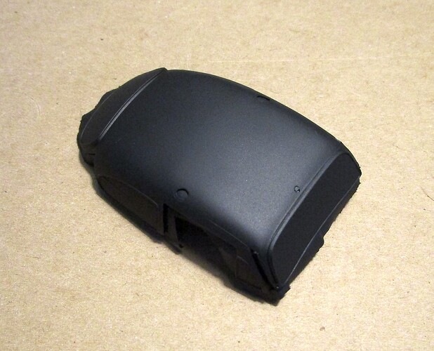

Some putty work was needed on the edges some parts and the roof had two sink marks. While this was curing, I built the suspension and interior.

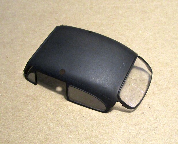

The “glass” is all one part. I masked to paint the weather stripping* and to paint the edges black to block the prism effect. This makes the “glass” look more to scale. I’ll post a bunch of pictures of this because I haven’t built and painted an aircraft model in a long long time so I was very stoked on how this turned out.

Sanded putty, primer, then sanding a little more, then final primer. Then repaint base coat with Testors Tan flat enamel. I’ll let this sit for a week :hourglass_flowing_sand:

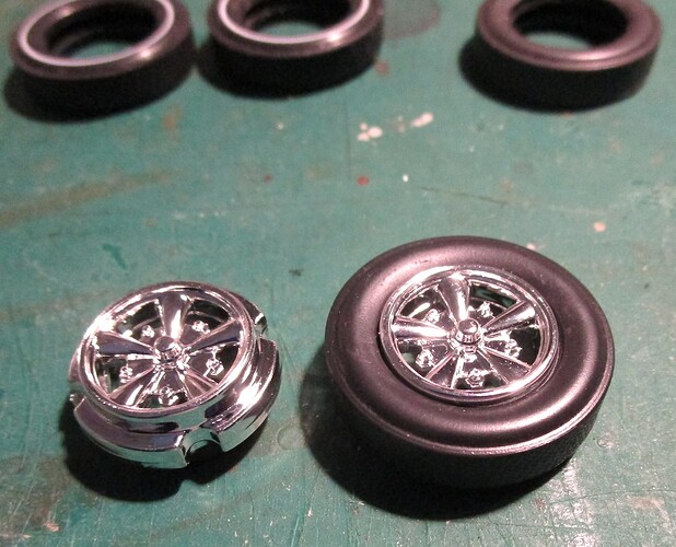

In the meantime I’ll work on the wheels. Different wheels for each side. I couldn’t use the wider slicks with mags because the diameters are different so the bug won’t sit level. I have to file material down to accept the same tires as the left side.
Left side represents a Dodgers fan so Dodger blue rims and a Tamiya metallic blue wash into the VW.
Flat black over the chrome rims for the right side.
