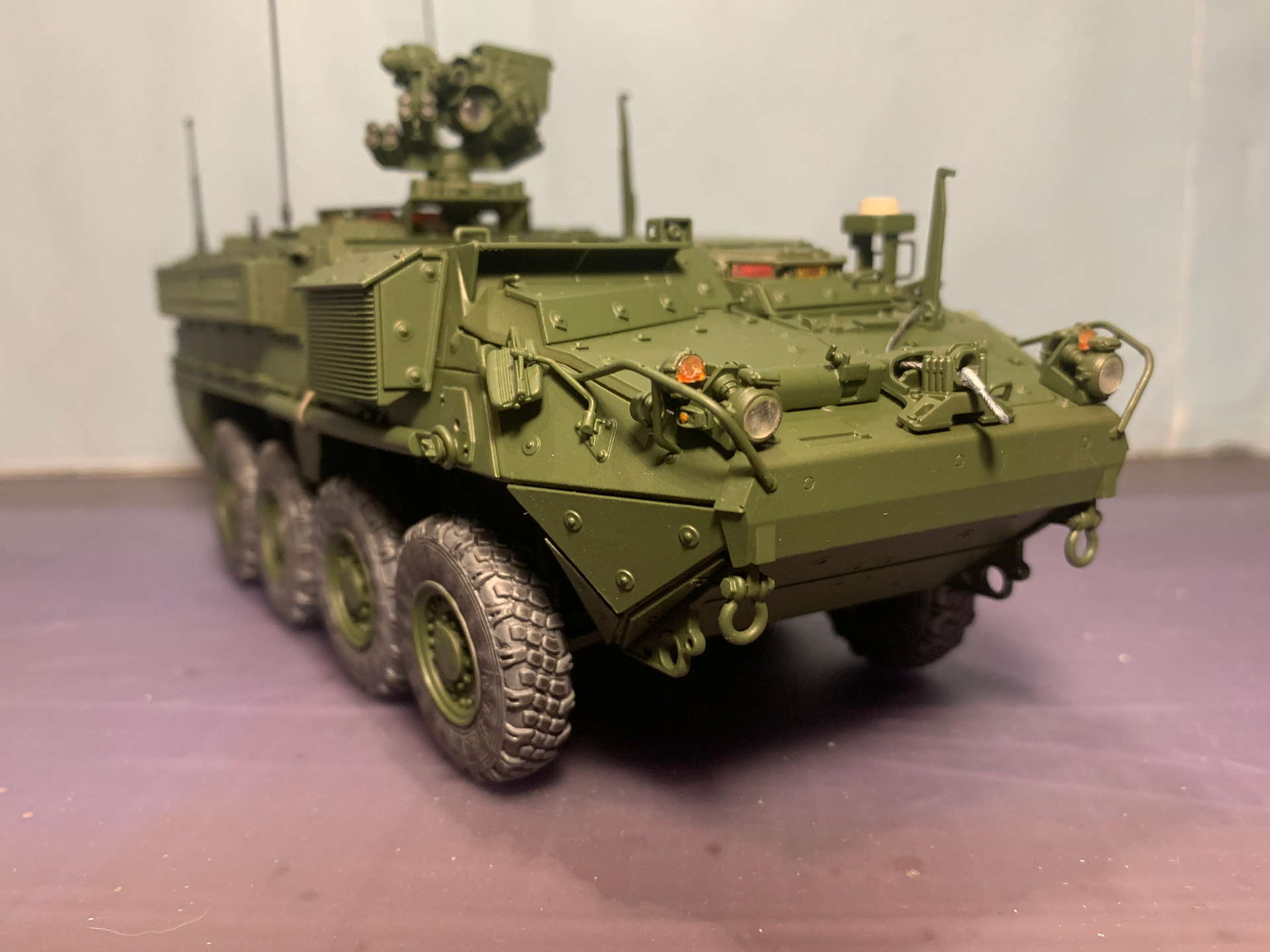

Model completed.
I decided not to weather it, assuming this vehicle had just been assigned to a field unit.
I didn’t attempt to replicate the double-V hull bottom; I figured this wouldn’t affect the model’s appearance as an A1 version, so it wasn’t worth the effort.
I’m unsure whether to keep the RWS with an M2 or install a RWS/J (Javelin) version. Suggestions are welcome.

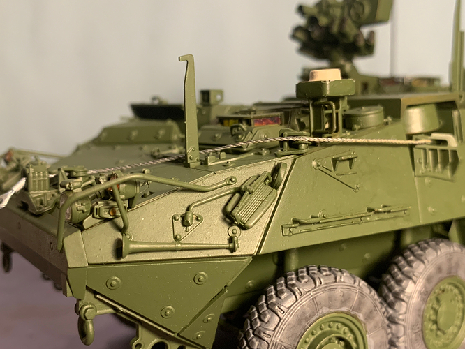

more pictures with close view some of the parts I designed
I also modified the side stowage racks which are different from the previous Stryker version; this was a cut, sand and paste work.
Looks good. I would add the Javelin if it is a newer version.
Very great, just a little detail: wheels on stryker A1 are like te LAV A2 , drive train and suspensions are modified.
