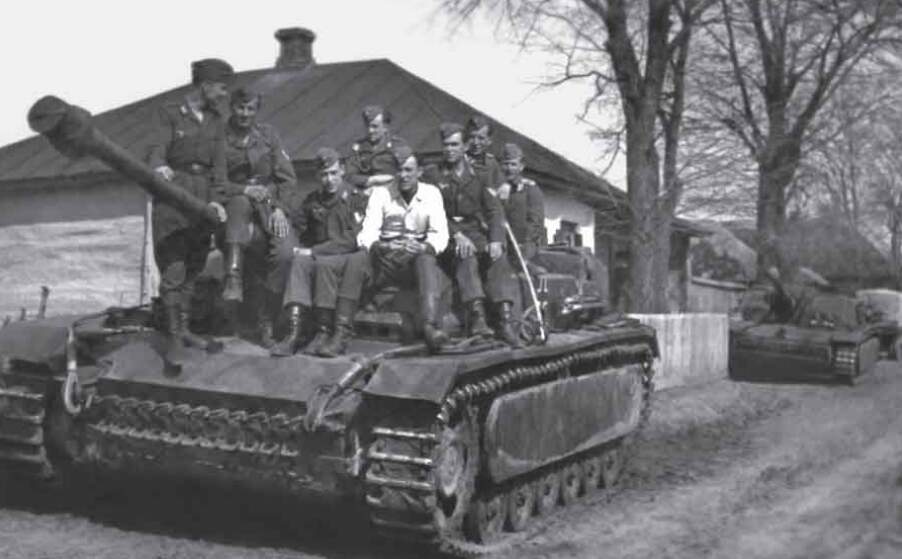

If not, have any of you seen this side armor before? Also, looks like it has an added plate on the upper glacis.

Skull is not right, but I’ve seen the odd side armor somewhere else.
Looks like it was from this unit: Armorama :: Peko Publishing StuG Abt 202 Review
I noticed some Chinese kid posted that the video was AI garbage and not real “because the Panzer III NEVER had side plates like that” in very snooty internet lingo so I linked him the book title and ISBN number and informed him he had just been roasted online.
More wooden side skirts…
So… how were they attached?
Steel brackets welded to the hull between the road wheels and return rollers.

Well done. Not roasting. Educating. When I think back to all of the “written in stone” truths that I learned from the Panzer Color and other books from the seventies and eighties, and how the end of the Cold War opened up the deluge of news source material that shattered so many myths, I’ve been very happy to be educated on new discoveries.

These wooden skirt plates helped to camouflage and blur vulnerable spots. It made it much harder for Russian soldiers with Anti Tank rifles to aim for these vulnerable spots.
Another reason was that it could activate early fuse activation so the fuse on HEAT rounds could be activated before hitting the actual armor. That would reduce the impact.
With other words they tried these wood panels as a DIY solution. Same reason why they mounted spare Tank track links
It was a placebo if it was used for protection. It was most likely thought to help camouflage some how. The Russian anti tank rifles 14mm round were way to effective at 500 M.

One of the things I heard was the standoff did not stop the antitank rifles. What it did was to start them tumbling thus reducing their effectiveness.
I think Steve Zaloga addressed that in a recent Pzr III or IV book. Every German tank up to the Tiger/Panther, the side armor was thin (<30mm) and vulnerable to Soviet anti-tank rifles, which could penetrate up to 30 mm at 500 m, and 40 mm at 100 m. The thin skirts the Germans put on would dissipate energy and, as said above, cause the round to tumble.
