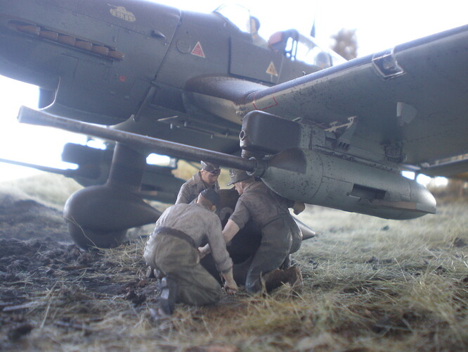

Aha, OK I had a feeling I’d misunderstood you, so happy to be clarified. Completely agree aircraft weathering is a different animal from AFV’s, I found that with my Stuka & don’t think I was very successful. The only common issues are (a) is it straight out of the factory, or lived a few months in the combat zone? (b) if the latter, all camo seems to rapidly fade and gets overlaid with dust/oil & exhaust stains etc. If I’m going to go too far, I’d rather over-fade a model than leave it looking too fresh/toy-like. Good luck anyway!
you have a link to your Stuka build? for reference on my build, thanks
OK - I didn’t want to hijack your thread (particularly with one of my less successful efforts) and I don’t have any build images, just of the final result…
looks good to me, especially the figures ![]()
