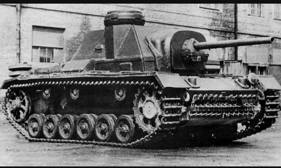

This photo shows an example with the sprocket and idler of the type used on early Pz.Kpfw IIIs, Ausf. E, F and G. The newer type of sprocket and idler was introduced with the Ausf. H.
The other thing to consider is that spares would probably have been salvaged from whatever they had, so it seems quite possible that there may have been mixes of parts from different marques.

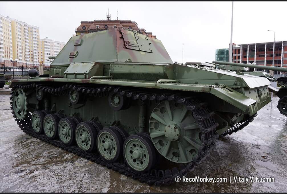

Here’s a preserved example that seems to show an early type idler (G or before) in combination with a later type sprocket (H or after). Obviously this being a preserved vehicle means that could have been done post war, but the principle is the same, using whatever is available.
Photos of these things are pretty rare, so there will be variations that are
Hmm, I was looking for the backend of that very vehicle as it has the later front drive sprockets but the earlier rear idler’s. HMM thanks. It does appear to have the later style rear end though. Not the type I was looking for. Thanks First Circle. I was looking for images of the backside of that.
Thanks that’s one of the many ones I did find. I’ve seen that one multiple times. Much obliged.
