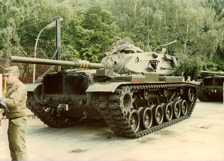

I cannot speak for the color used by Berlin Brigade vehicles during the Berlin Crisis. However, I can tell you that the color used by the 1980s was significantly darker OD than the colors used by US units outside of Berlin. As someone assigned to 40th Armor in Berlin I can say that you should think OD green with some black added to it. Here are some samples from the mid to late 80s. The second picture appears lighter only because it was taken with noon sun directly overhead.
Wow great pics; didn’t realize there were any plain OD vehicles in the US Army in the mid/ late 80s. Another painting option I guess.
Although in 1986 during Reforger, now that I think about it, we exchanged our M113s in MERDC camo for Forest Green vehicles for a reconstitution mission.
Long time ago I read that adding black to OD was a common practice when all vehicles were OD - to make them look “smarter”. It would probably help a little with the fading of the color.
