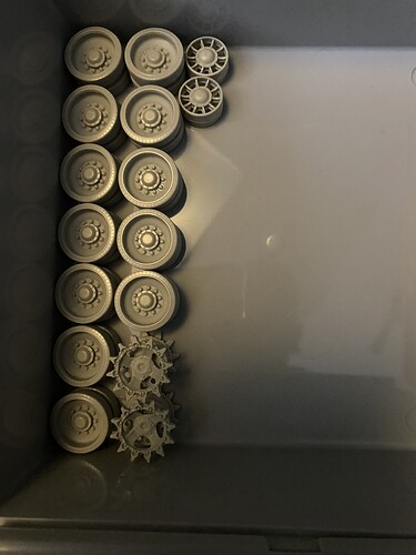

The wheels are finally completed. I will say something about quality of this kit- it’s horrible, lines on every part, thickening on the edges, plastic is hard and very fragile.
Unfortunately I need to announce that I need to stop building this kit (maybe not forever and it is likely I’ll continue in the future) due to manufacturing defects the model has.
It’s curious how two modellers have completely opposite views on a kit ![]()
