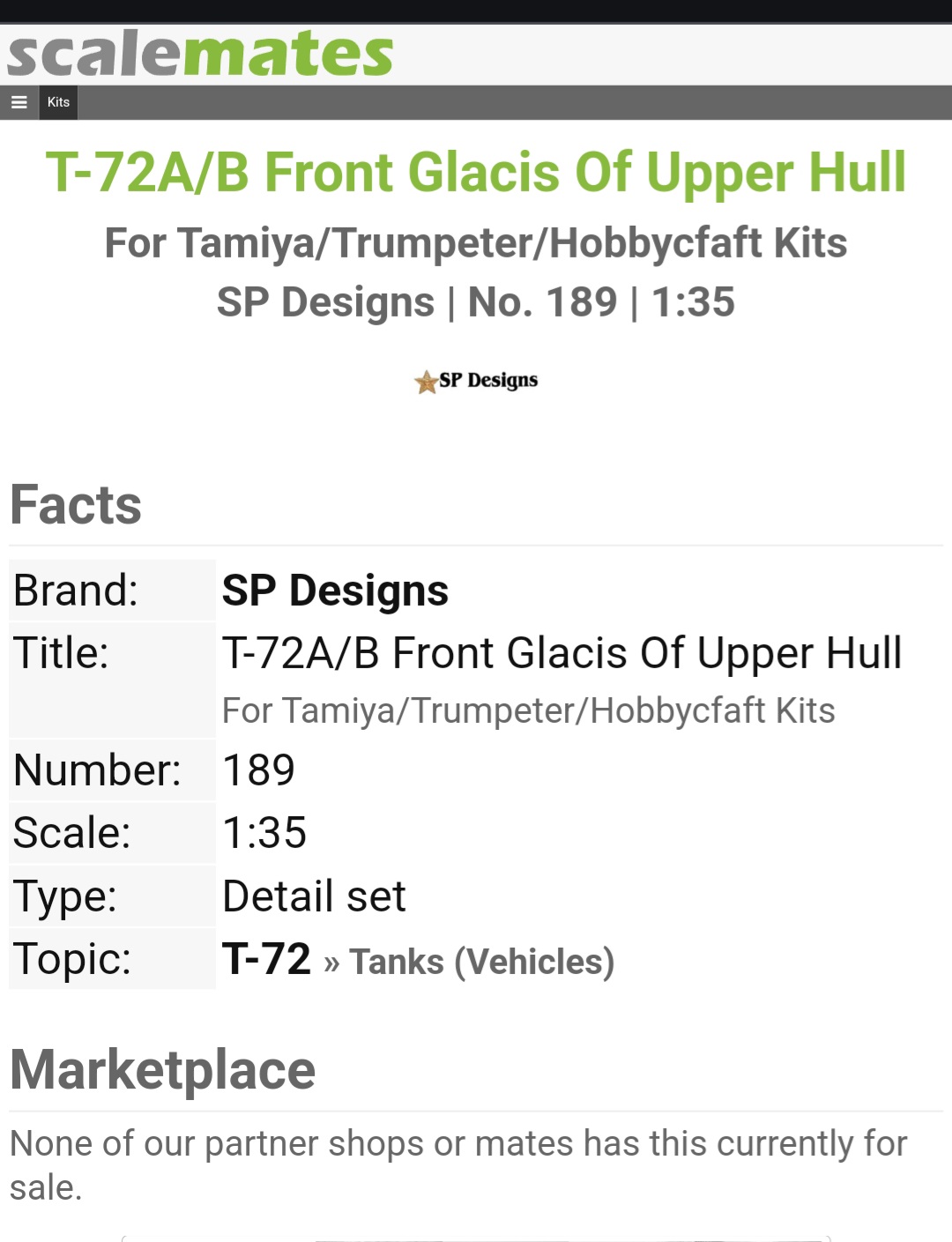

Not my area of primary interest but I believe there was an aftermarket glacis offer for this once upon a time.

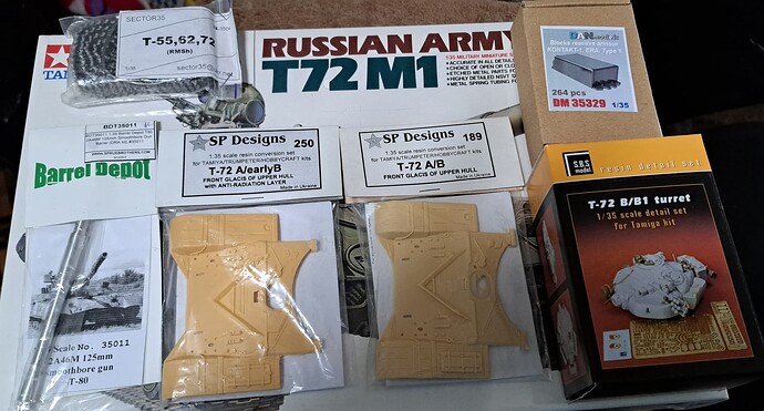

Let me check the stash when back home because there’s a Tamiya T-72 w/an early SBS turret and a couple of replacement glacis(es) from someone.
thanks

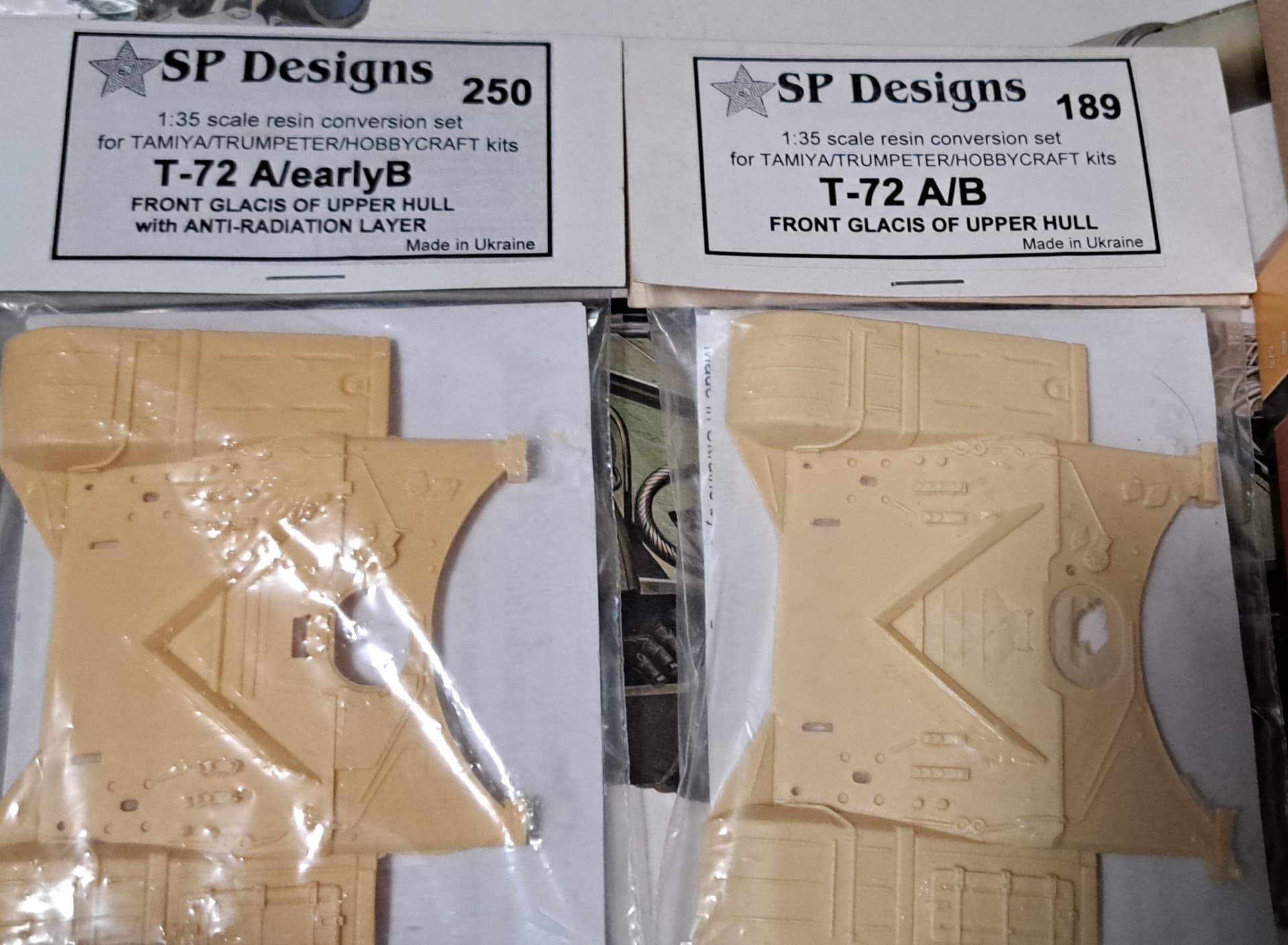

@tanknick22 Nick,
I have a spare SP front glacis. It’s yours if you want it, free no strings etc.
I’d like to keep the glacis that matches to the SBS T-72B/B1 turret w/ERA added. No idea which one that is, I so grabbed both SP parts when they were on clearance.
HTH
