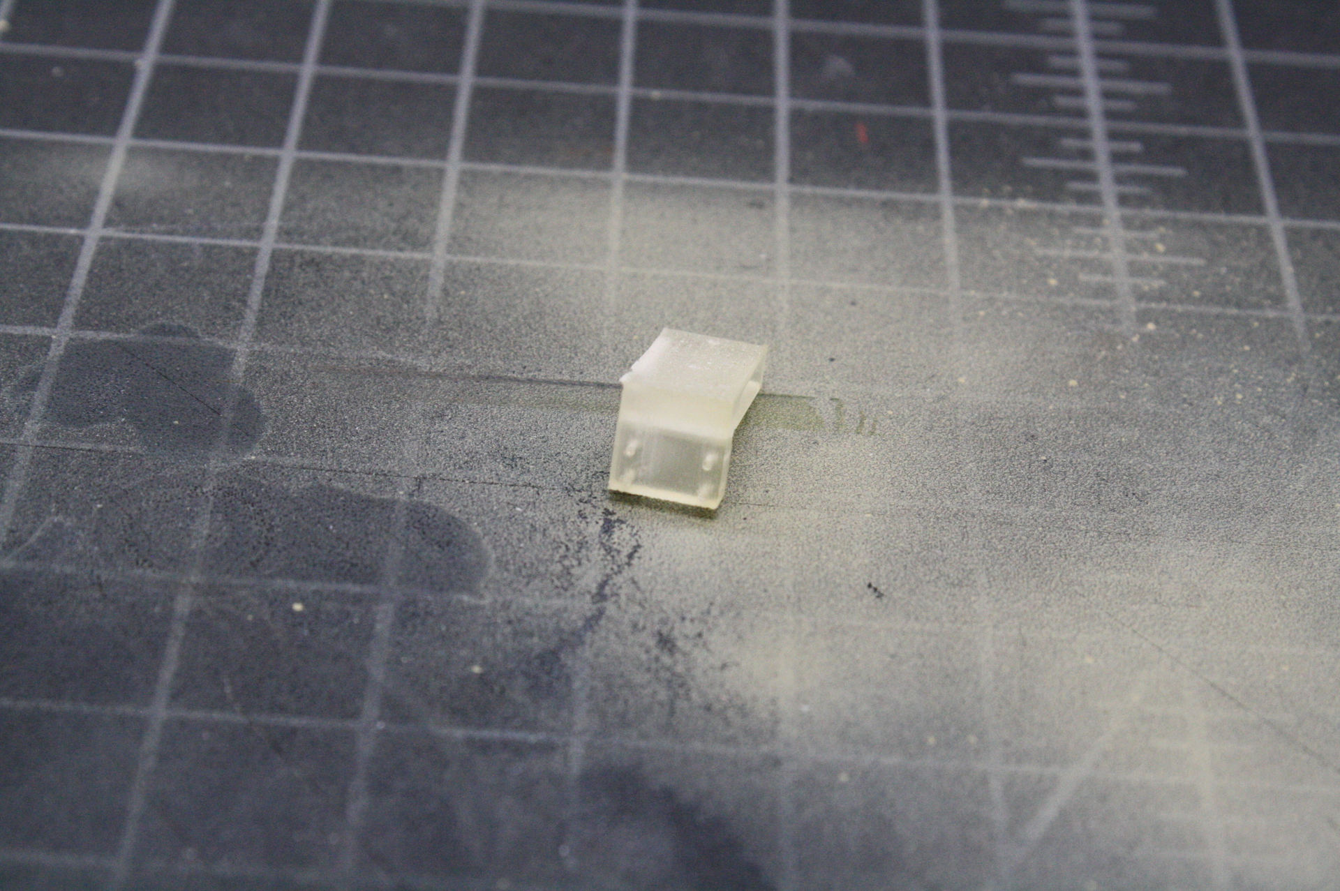

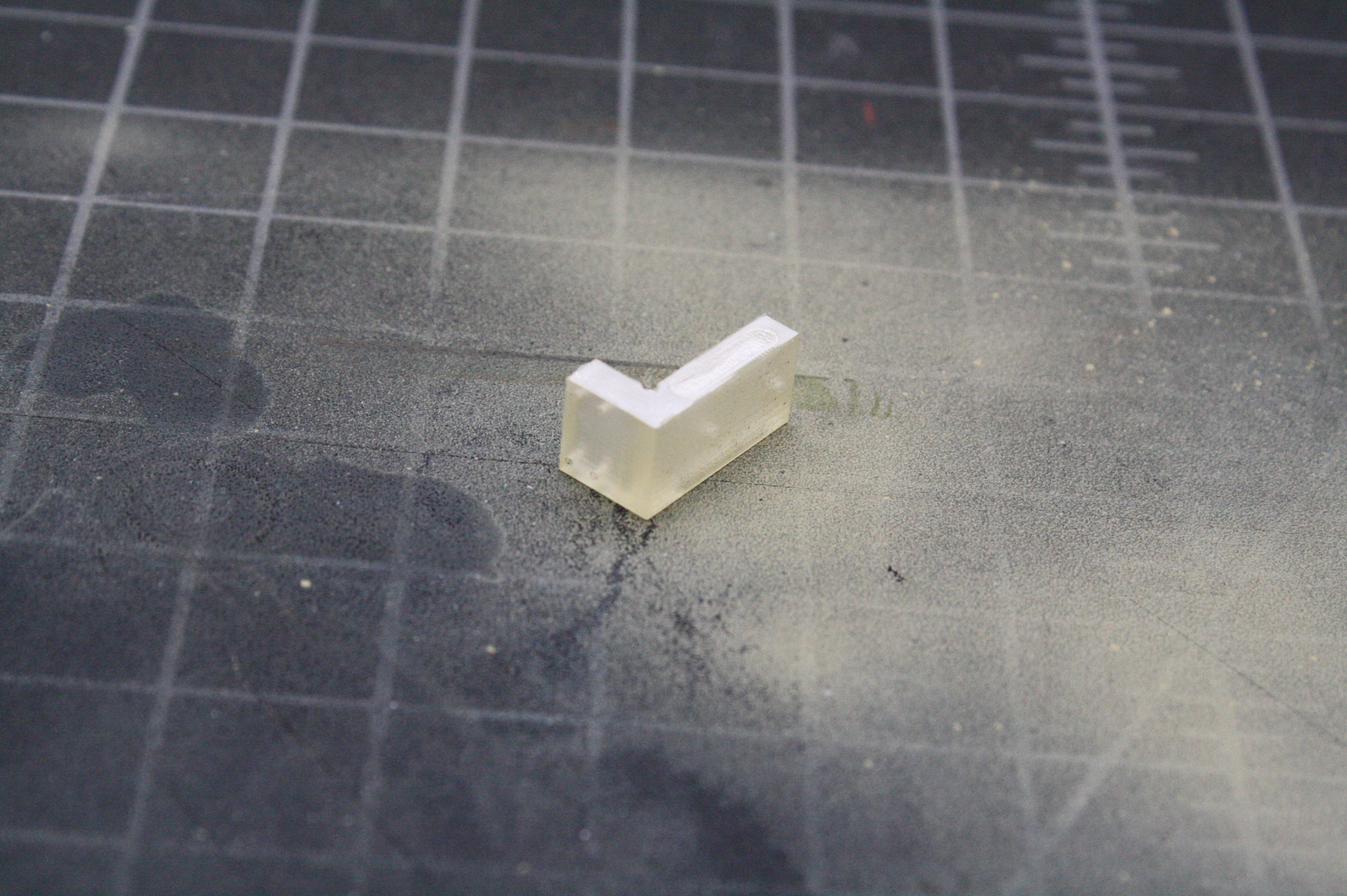

Here it is. You put it on top of the bogie truck (before you put the track skid on) and drill the two holes in the top and the four holes on the front side. The two holes in the top are for releasing spring tension, and the four holes on the side are for reversing the bogie. Handmade by Clay Caras of the Northeast Military Modelers Association.
Thats the same one that I have, but its from the older 3D company that went out of business.

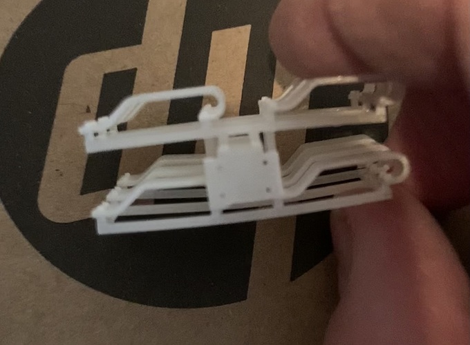

I offered a set of skids and a drilling jig on Shapeways back in the day - maybe I need to dust it off and put it on Cults?

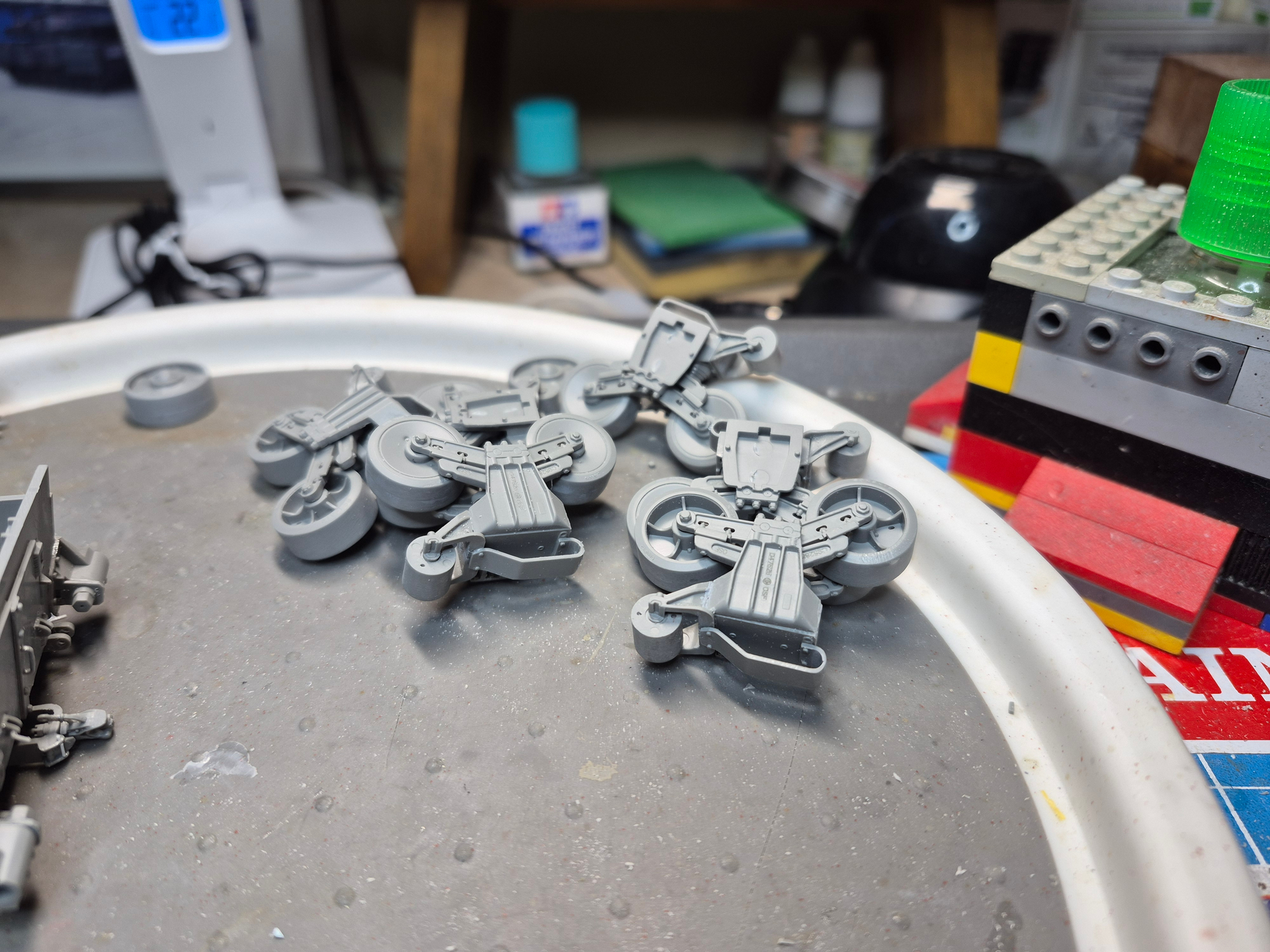

All I build is Shermans so ages ago I bought a jig, then I hated it and then I built my own and then I hated that one too😂…now I just eyeball the holes and never think twice about it😉
I did this suspension yesterday, all the holes free hand…if you zoom in you can see the holes.

Suspension trucks are done and now just need some clean up.

There were several sets on SW - mine was a sprued box with six skids and the jig all attached.
While looking for other 3D parts I came across them.
