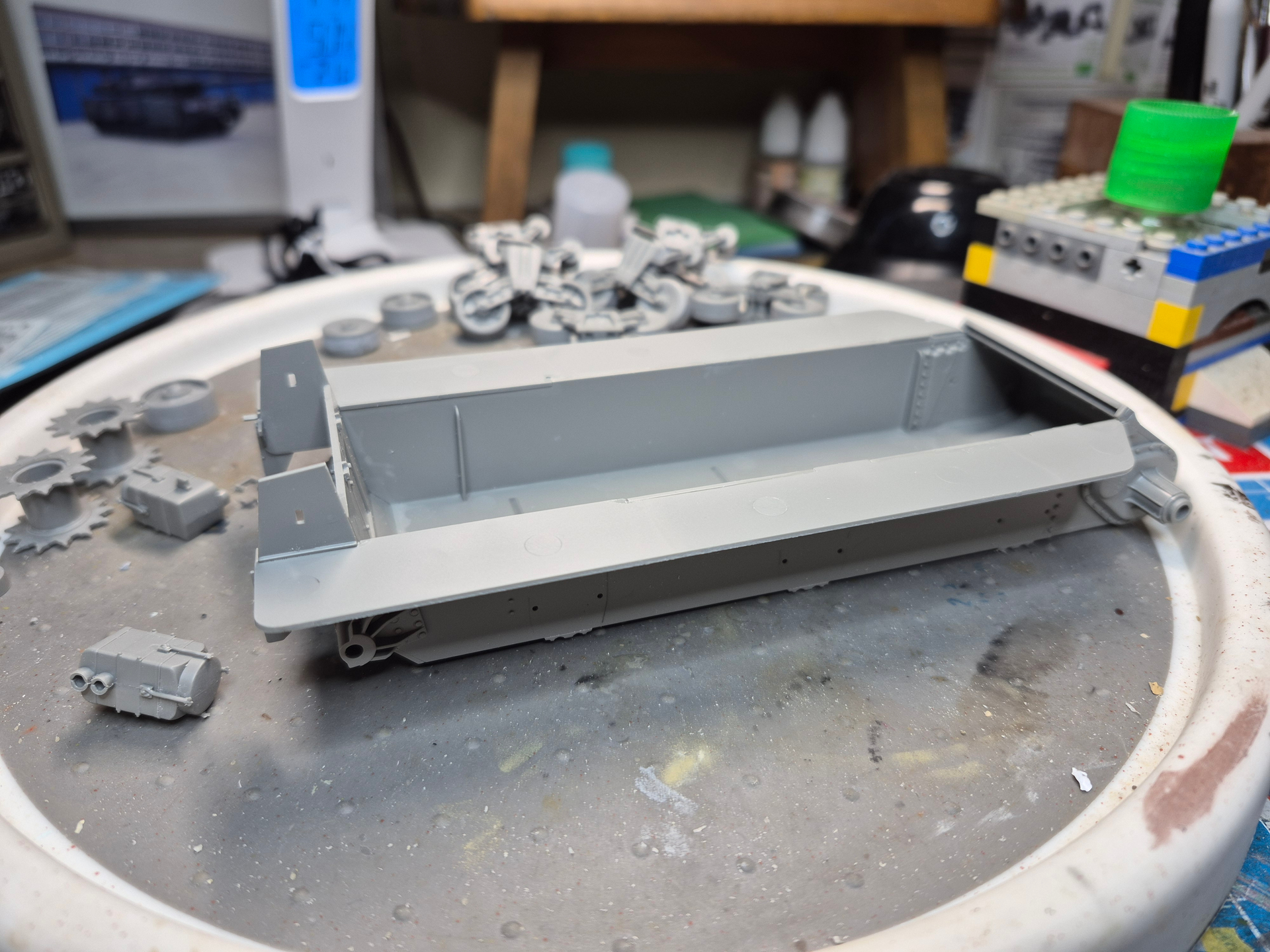

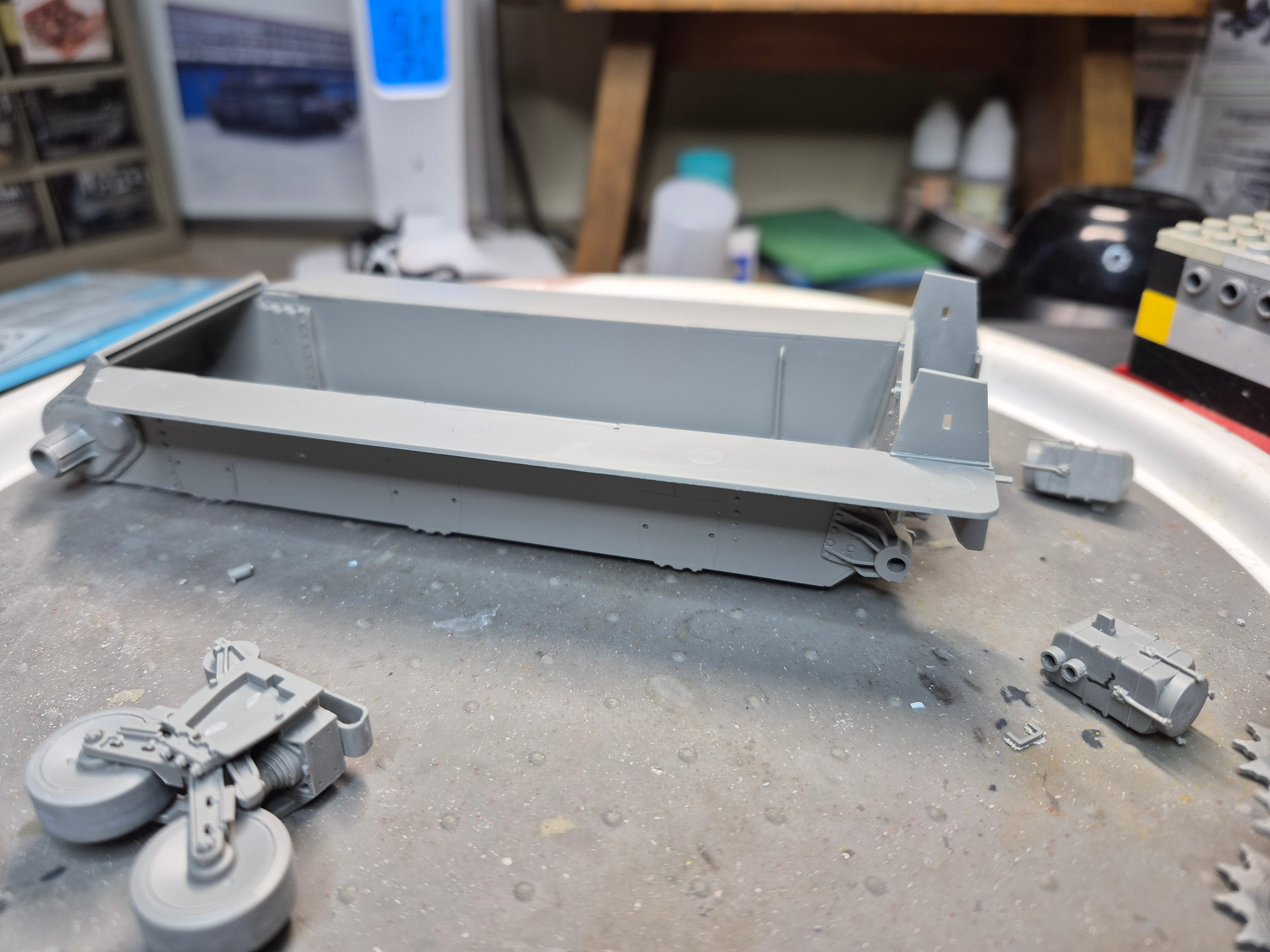

I made my own jig for drilling those holes: a piece of plastic card with four holes drilled in the right locations, then an L-shape of 2 mm square rod glued on both sides so I can position it against the bogie correctly.

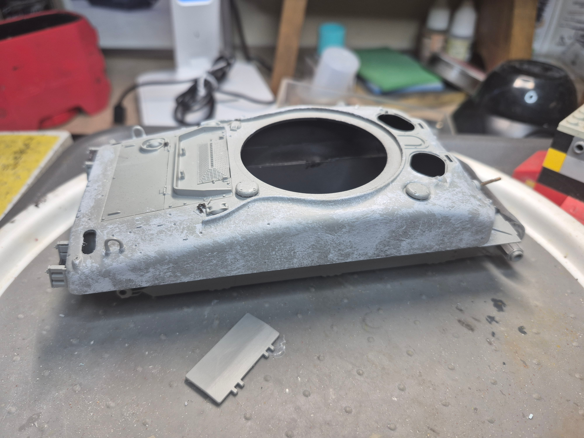

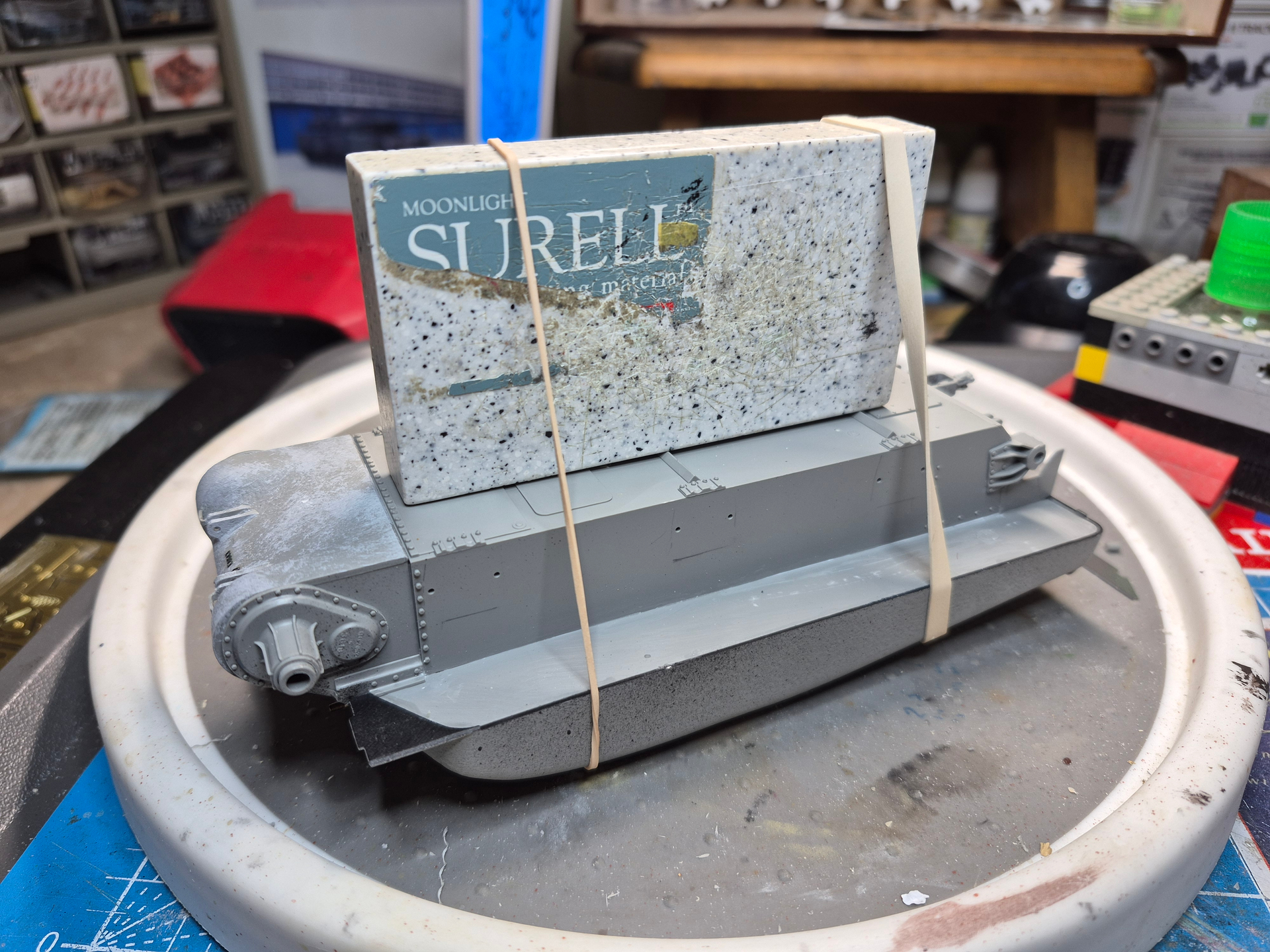

Sponson bottoms on, with square air cleaners done as well.

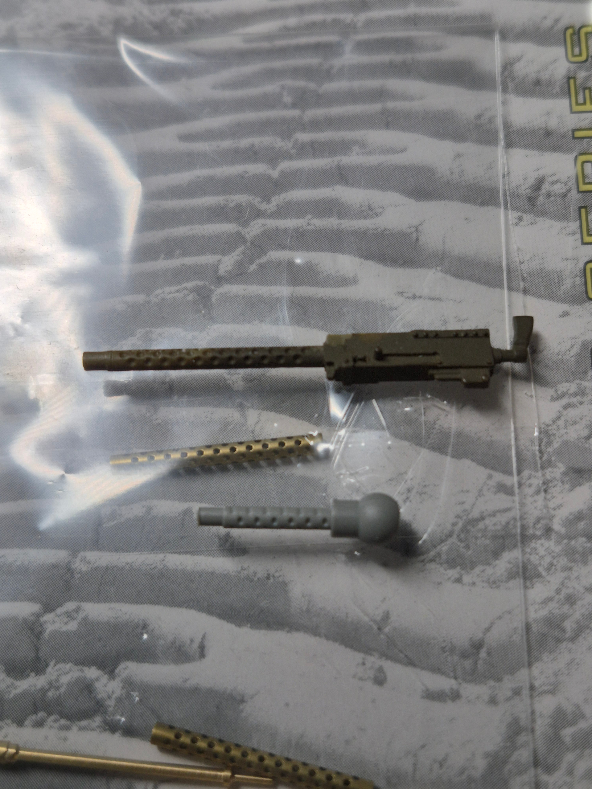

Takom’s .30 cal is a bit thick to me and I found some Master barrels that I’ll use instead.

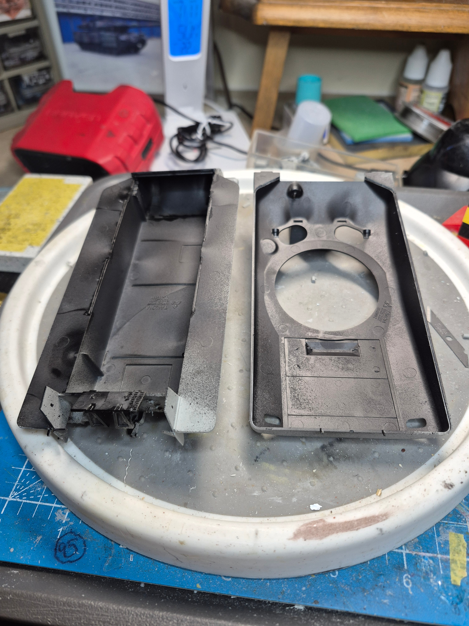

Spray painted the interior black. So exciting.
The hulls snapped together with no problems. :ok_hand:

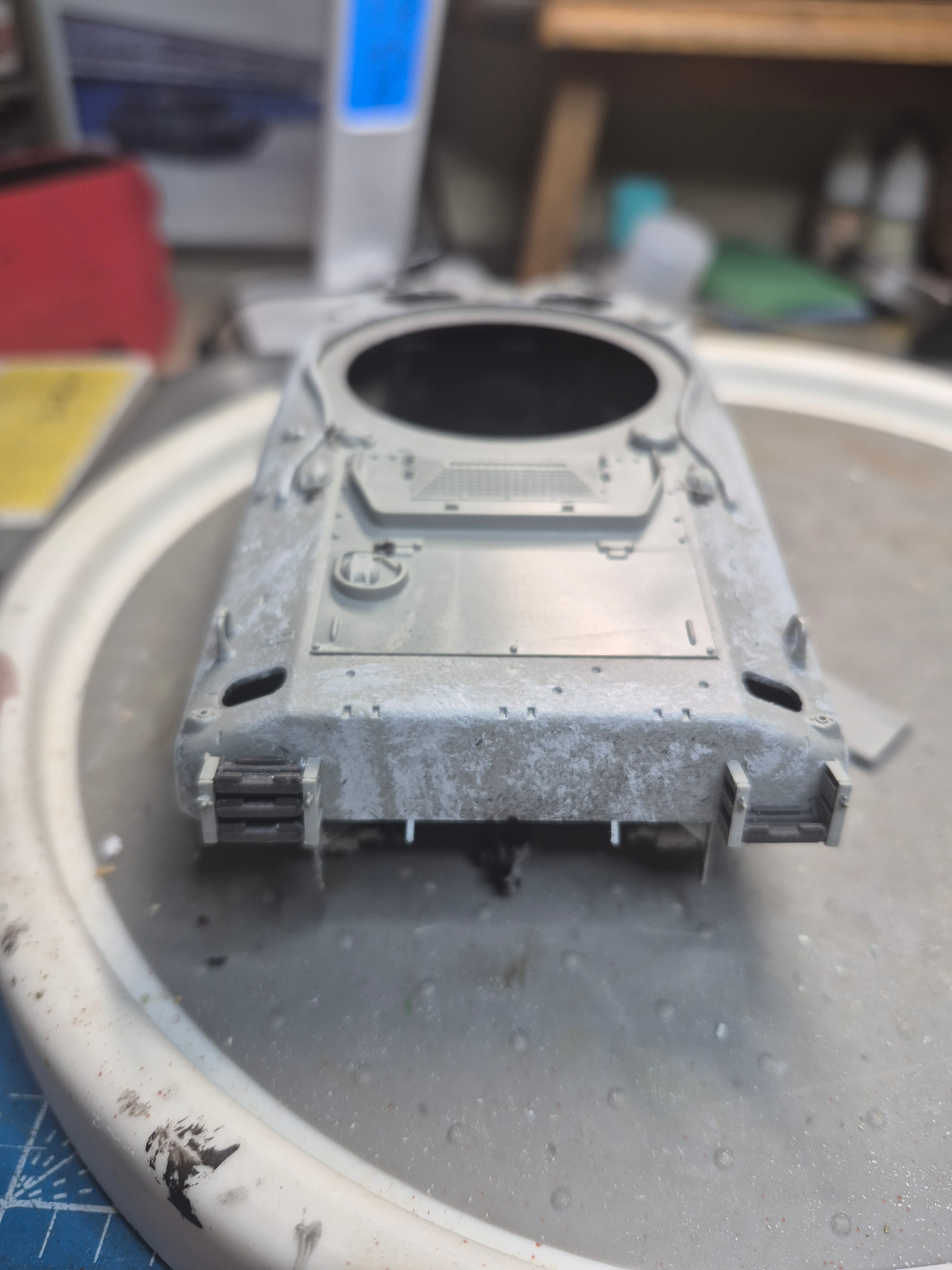

Some more hull detail added. More to be added next.

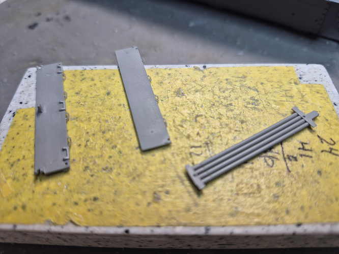

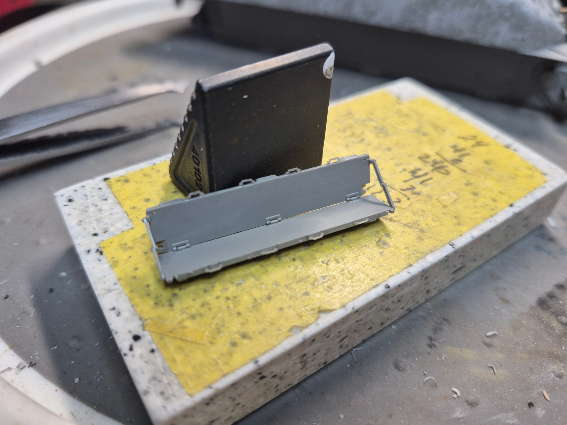

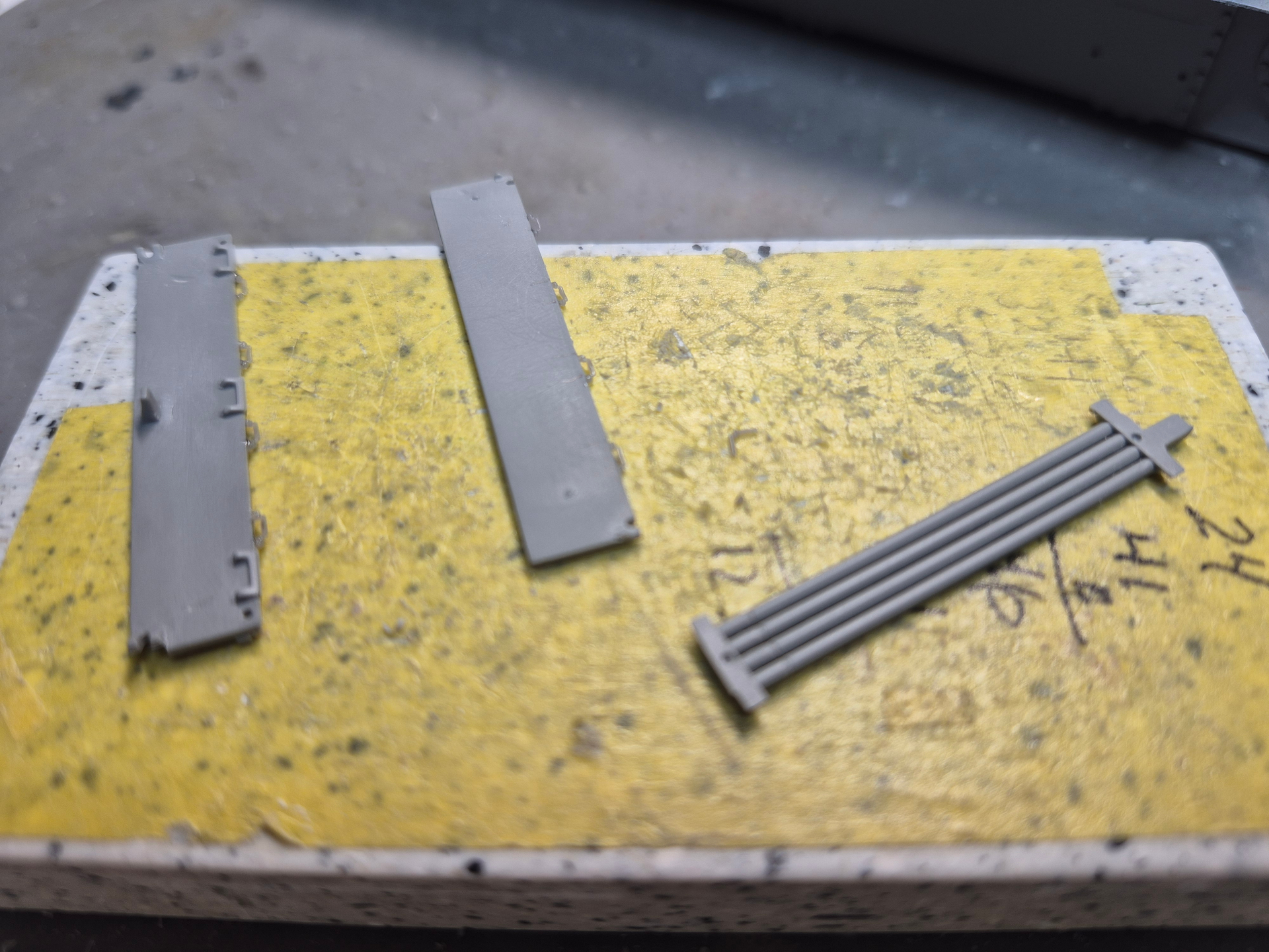

Blanket rack done with some fragile 3D footmen loops added.
@Dan
I could get behind using some 3D printed detail stuff, are you able to glue those with extra thin or do you have to use CA for those loops?
Those look really good and they add a lot to that stowage rack.
