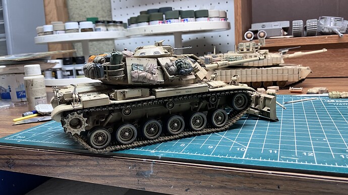

As always you guys come through. Thanks to James for pointing out the barrel gaffe and thanks to Ryan for the replacement decals on the bore evacuator. Stowage has also been added. Done for now pending possible replacement tracks down the road. Thanks.
