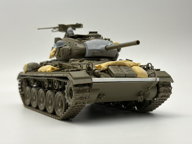

Just finished the build phase on Tamiya’s 1/35 M24 Chaffee. Great kit — clean fit, no major issues throughout the assembly.
Added a few scratch modifications before moving to paint:
  • Folded paper ration cart on the rear deck
  • Epoxy putty tarpaulin and sandbags
  • Lacquer putty cast texture across the hull and turret

That tank crew figure is amazing considering it is Tamiya! Looks better than some resin figures I have. :+1:
:grinning_face: :canada:
Thank you! :grinning_face_with_smiling_eyes: Tamiya really stepped up with this one — the figure detail is surprisingly good straight out of the box. Rendered it in black and white to keep the focus on the tank, but it deserved a proper color paint job honestly! :folded_hands:
