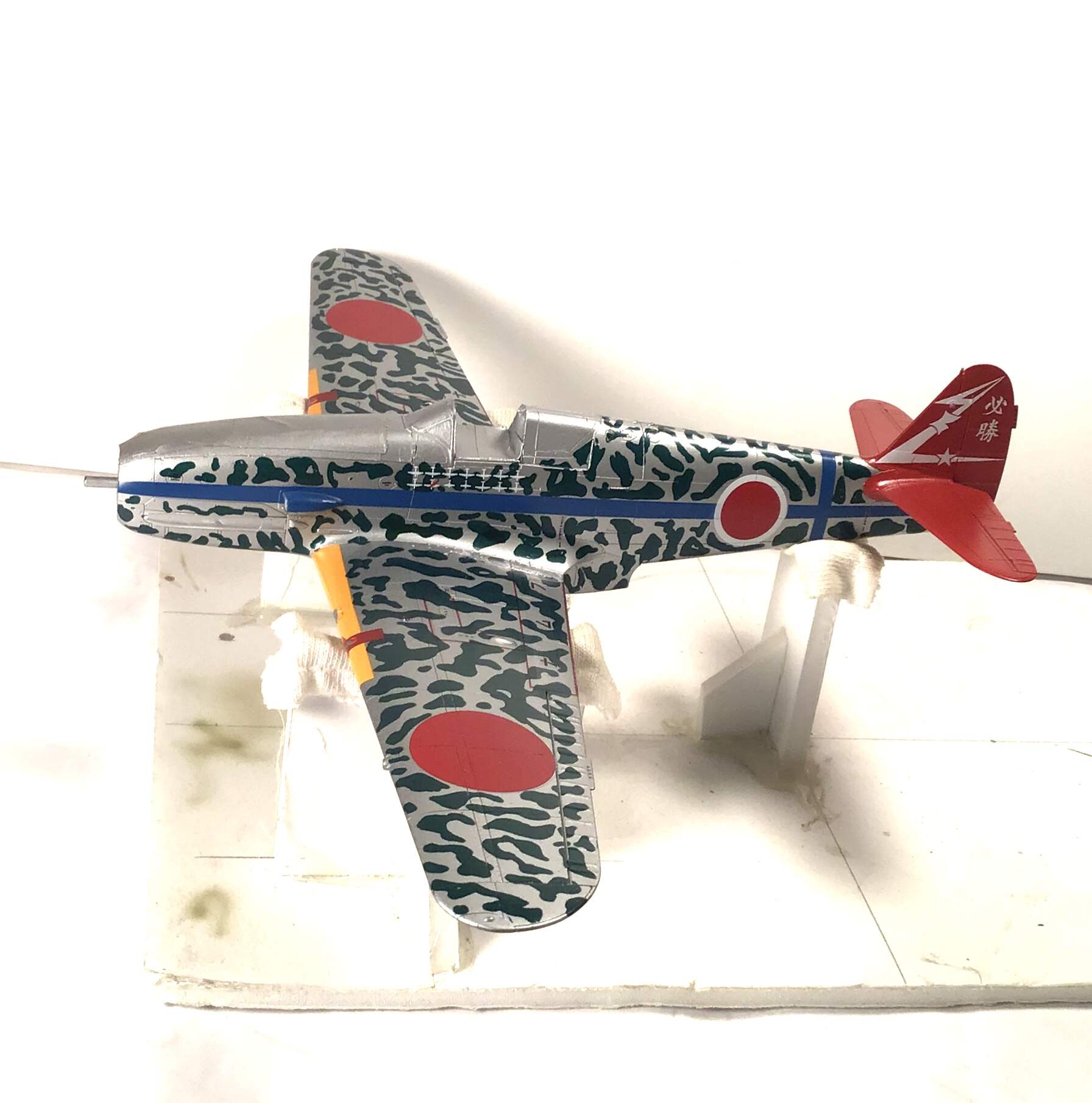

Decals largely done now - a couple of stencils here and there remain.
The HGW wet transfers worked beautifully as far as installation goes - a little learning curve to negotiate but nothing too difficult. The removal of the film went without a hitch. The only negatives to speak of are fit and color . The lower fuselage camo below the blue stripe overlapped the wing camo at the root in a few places. The green blotches are slightly translucent and where they overlap it looks like a black blotch. I was able to correct this to some degree by over painting the entire blotch in question with a similar green. The other issue is the color itself. To the best of my knowledge the blotches should be IJA Dark Green or Olive Green - both of which are more brown in tone . The color on the wet transfer is a bright emerald blueish green.
That being said I am still pleased with the outcome.
Thanks for looking!

Those wet transfers really look outstanding. I can’t imagine trying to mask it out and then air brushing all of it.

Calling this one done . I will add the antenna and mast at a later date because I have to box the model up until I get a bigger display cabinet - current one is full.
This was a very enjoyable build - as I have stated earlier , the engineering and its attendant fit is just superb . The wet transfers were a new experience for me and I will certainly look to using them again - thinking of doing something with a BMF using foil .

Once again you managed to kick up your build a few notches. Just super impressive everywhere I look. The cockpit is up to your usual high standards, as is the paint, and decaling. As for those wet transfers, I’d say that you really nailed them.

richard i really love this build. where did you get the camo decals? i have the hasegawa hein kit and been looking for them in 1/48. i see them for 1/72 and couldn’t understand why know one hadn’t made them in 1/48. are they made for the tamiya kit or are they generic?
joe
Hi Joe - the camo decals are from HGW and are engineered for the Tamiya kit - I don’t know if the would fit the Hasegawa Hein - likely not .
I ordered the direct from HGW as no retailers seem to carry them . hgwmodel.cz
