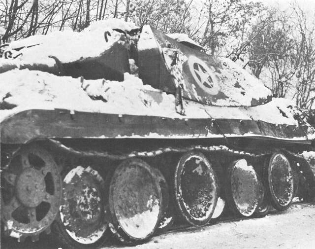

You can barely see it, but you can see the hollow guide horns on this “Ersatz M10” Panther tank.

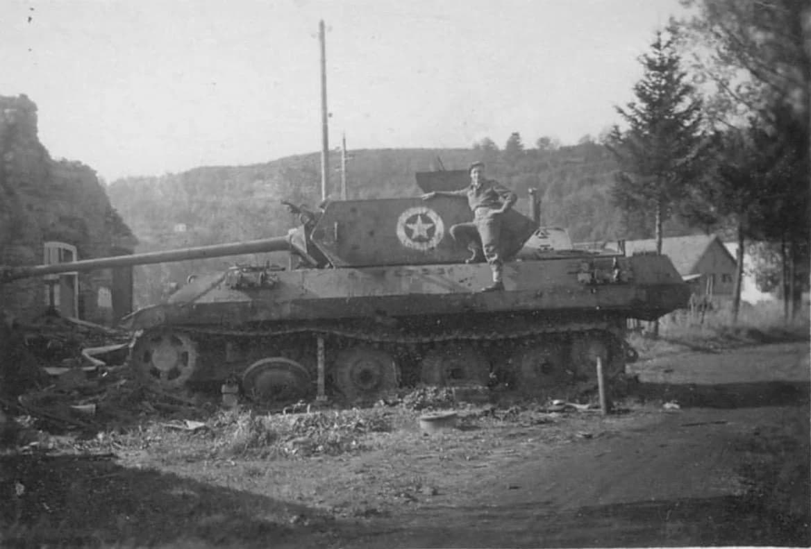

You can see it more clearly on this one.
