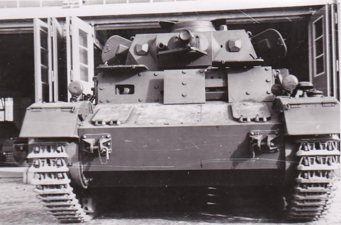

Making the sprocket thinner will alterate its mid plan when mounted on the original pins. I would suggest to ckeck if to move the sprocket a bit outside while fitting them to the hull to mantain the alignment to the mid plan of the road wheels.
Perhaps you need to see this?
And your driver; well, he just needs to see.
David
I thought about that. The sprockets are adjustable at this point and not glued in place, so can fiddle with their inboard/outboard placement.
It looks like Tamiya made the outermost drivers add on plate too wide, and I was following the directions blindly… :face_with_raised_eyebrow: I’ll see what I can do to correct that.
I think Tamiya’s plates are fine, but their instructions are very unclear here.
David
Good catch David, I totally missed that detail when looking at the upper hull.
I was able to pry the plates off. I’ll have to downsize them a bit in addition to minor repositioning in order to get both of those holes above the drivers vision slot visible.
