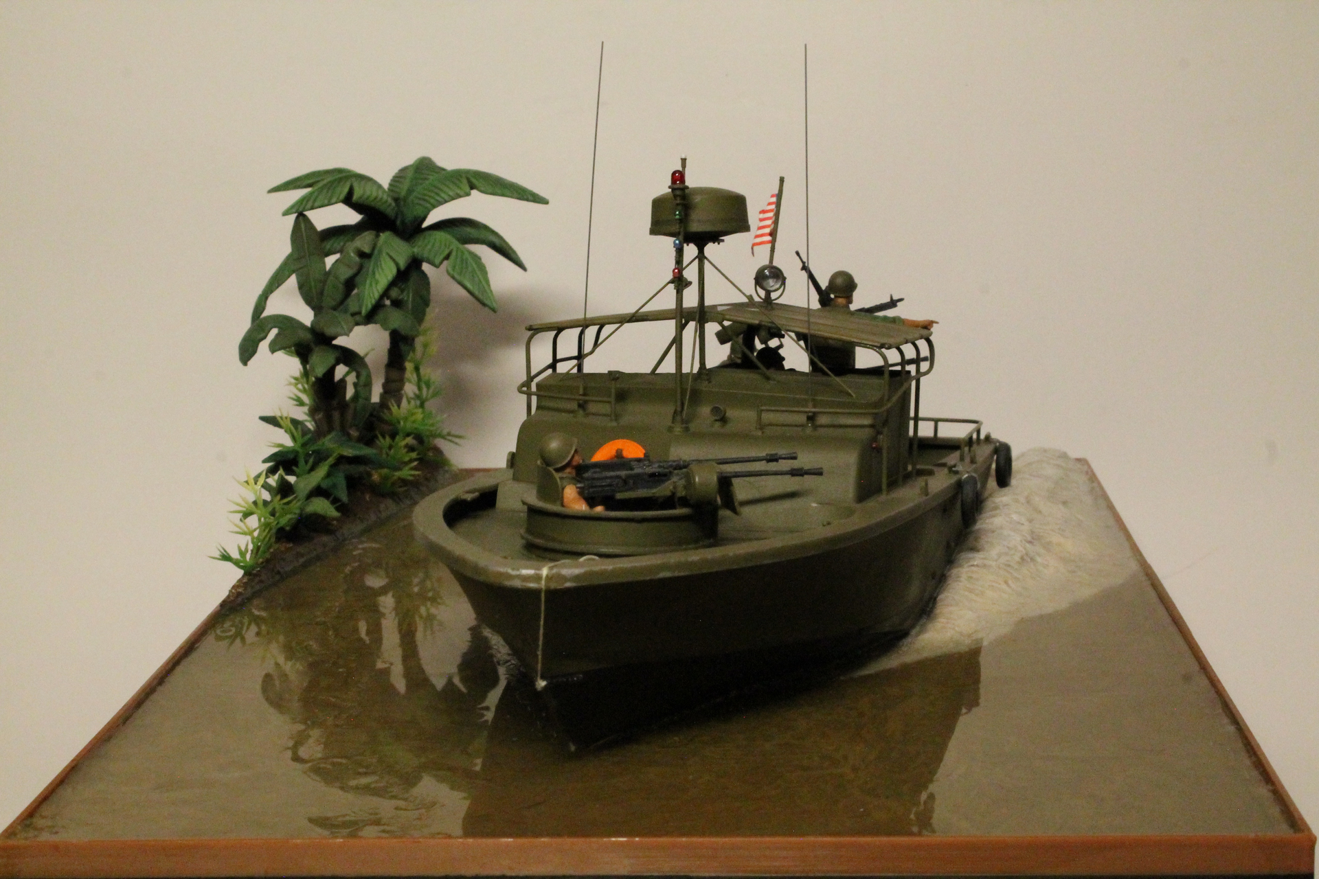

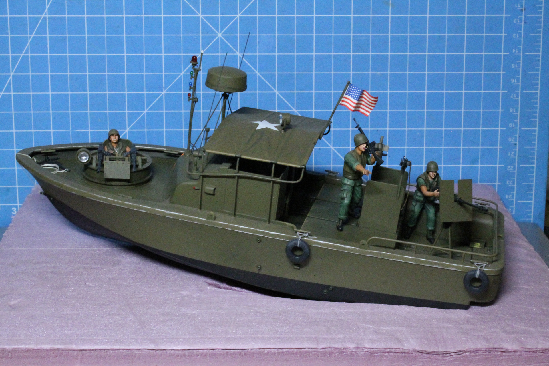

I posted an article awhile back about building the Tamiya PBR. I have since completed the base for it, so here’s an update.

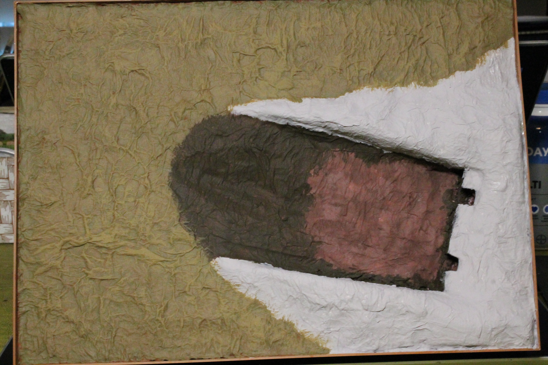

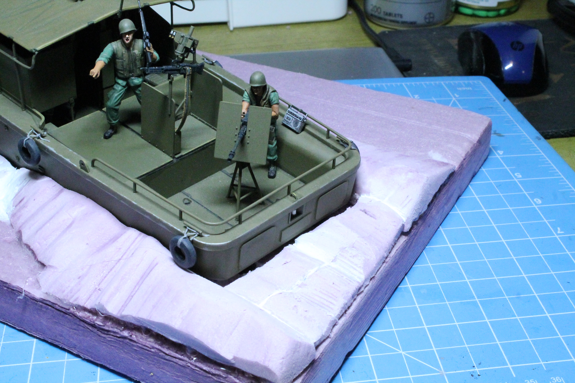

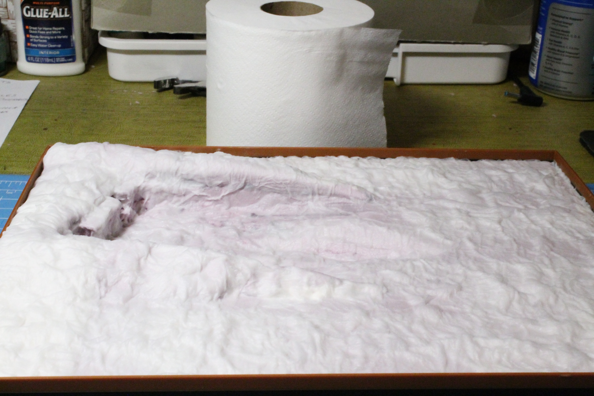

I started with a piece of styrofoam. It took quite a bit of effort to carve out the indentation for the boat.

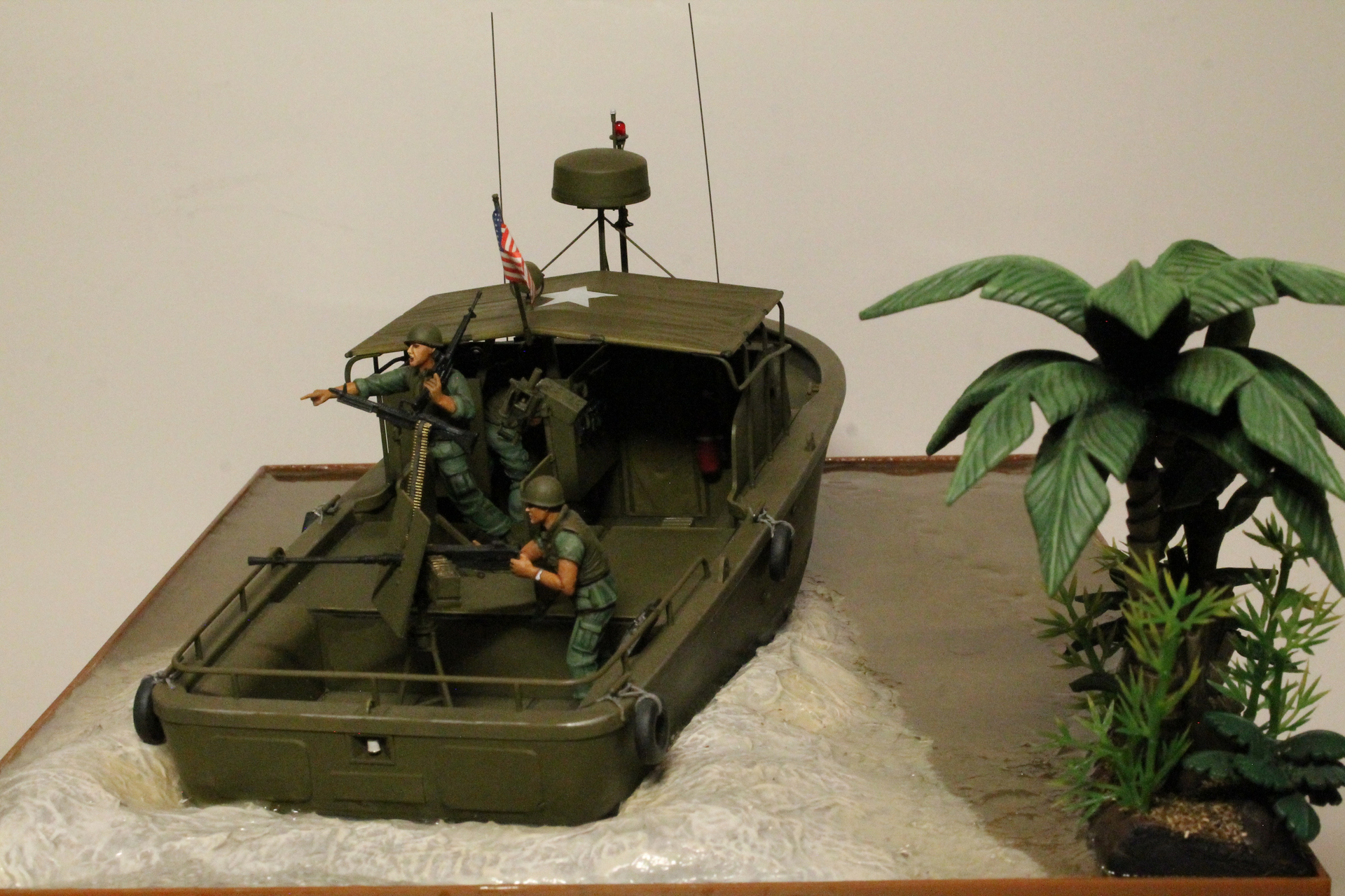

The ‘wake’ was built up using three pieces of styrofoam.
It was then covered using tissue paper soaked with diluted white glue. I found this method after watching a video on YouTube.
I then painted the base. I mixed my own colors using photos of the Mekong as a reference.

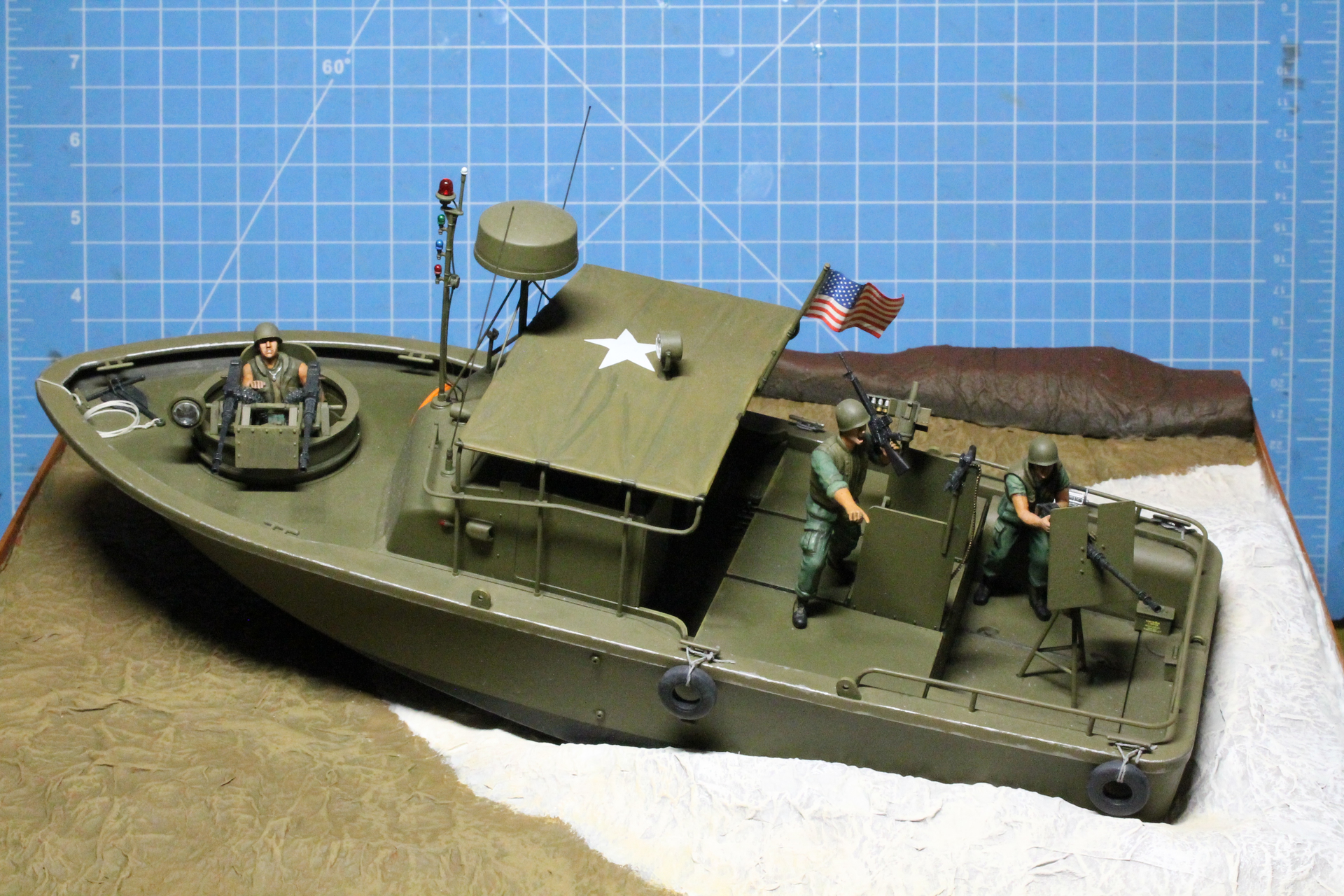

The background needed something, so I added a bit of riverbank. It was another piece of tissue covered styrofoam.

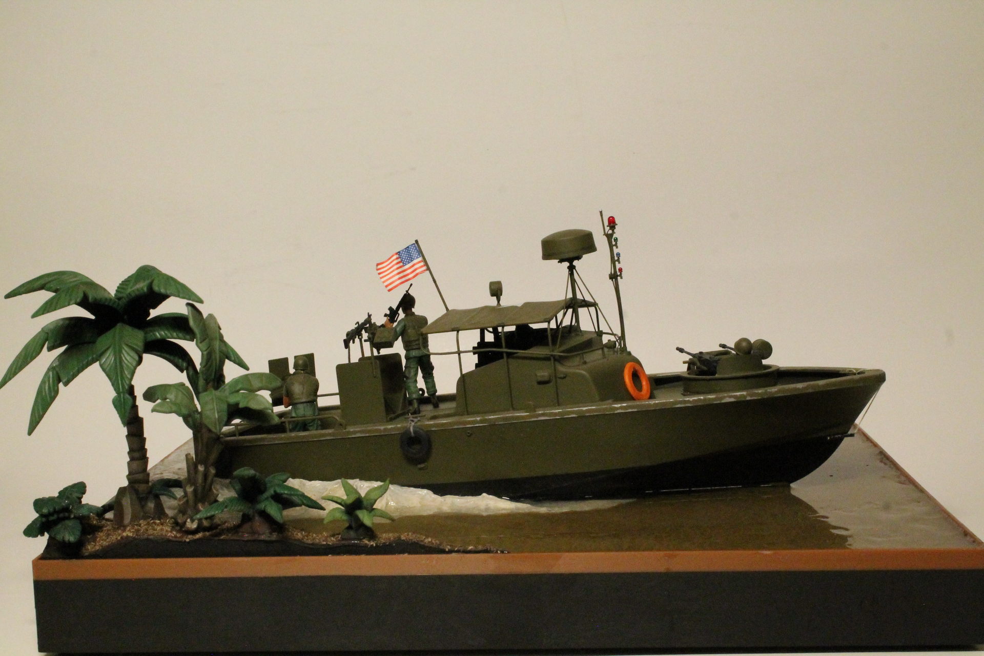

The jungle is comprised of a set of 3D printed trees and plants that I got from Etsy. They were nicely detailed and there was no clean-up needed. The palm tree was two pieces. I later added some smaller plants to fill in the gaps.

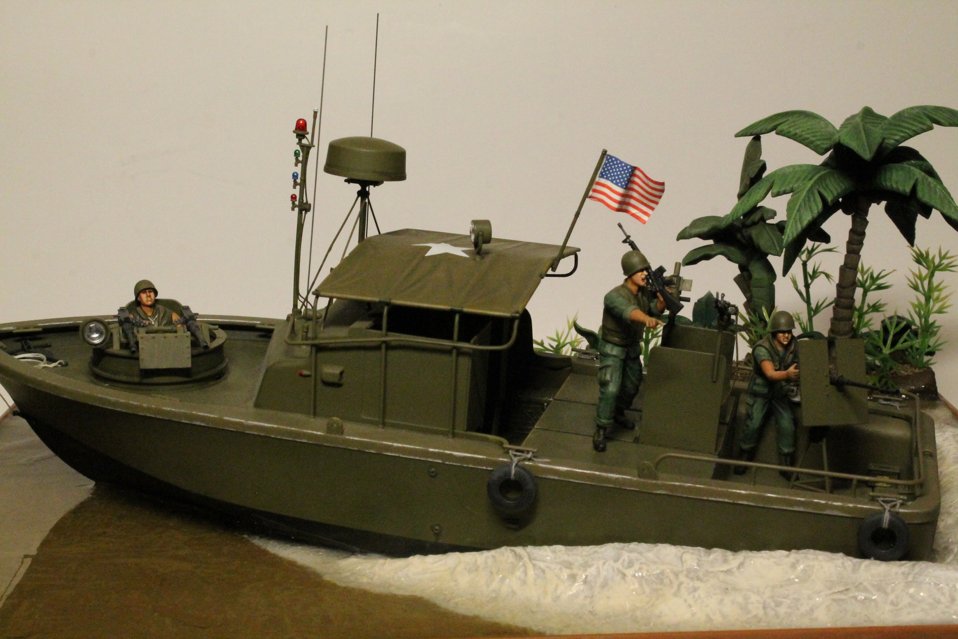

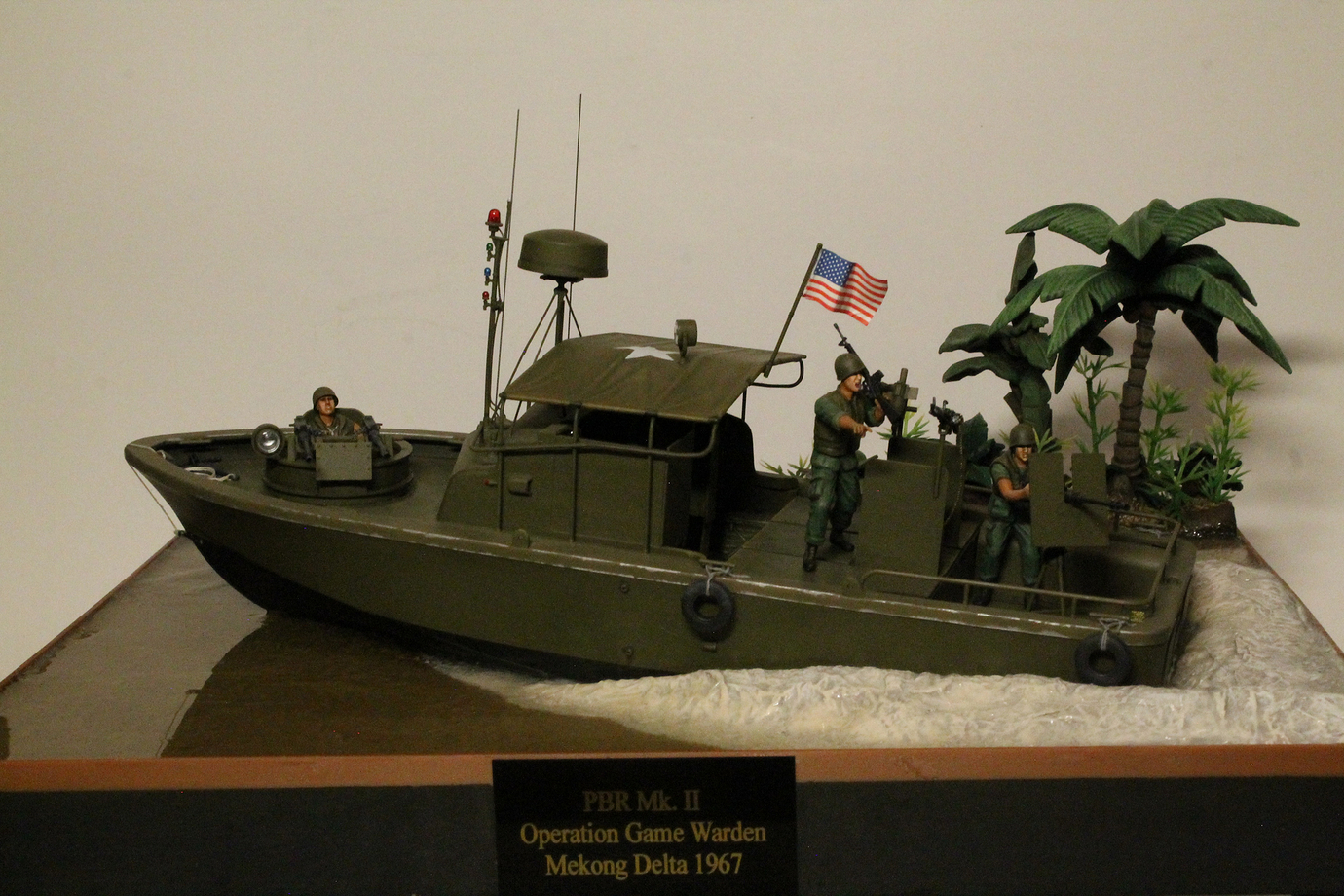

The water was made using a combination of methods. I first used a two part casting resin and then a gloss acrylic gel medium and gloss acrylic varnish from Liquitex to add texture.
Thanks for looking, questions and comments are welcome.

Very nice. The water looks great. I have built a couple PBRs and intended to mount them on bases, but never got around to it…someday.
I tried similar some 30 years ago, using a wood base ( not a good idea as it turned out). I first waterlined the hull and then realized the aft gun position hangs lower than the cut hull! If I had used foam, like you, I would have been able to cut out a recess for the boat.
:grinning_face: :canada:
Thanks, Gino. The base was easier to do than I thought it would be. Just have to be careful not to lay on the acrylics too thick or they might not dry clear. Ask me how I know.
My son used his 3D printer to make the box that I placed the foam into. That, and the fact that the PBR has a shallow draft and no props and rudders, made it easier as well.
Very nicely done Albert! That foaming wake looks really good and the figures look great too! Thanks for sharing!
Thank you, much appreciated.
That’s an awesome build and I actually watched a video about doing the water effects using that very method that’s really cool.
TinyDog01
Thank you. I’m happy with how it turned out. Pouring the resin on top of the tissue gave a better sense of depth I think. The tissue paper alone would work better with smaller scale, waterline models in my opinion.
First rate work, Albert - the water and groundwork really bring that PBR alive! :grin: :+1:
Thanks, Tim. Much appreciated.
very nice but when was the water that calm
