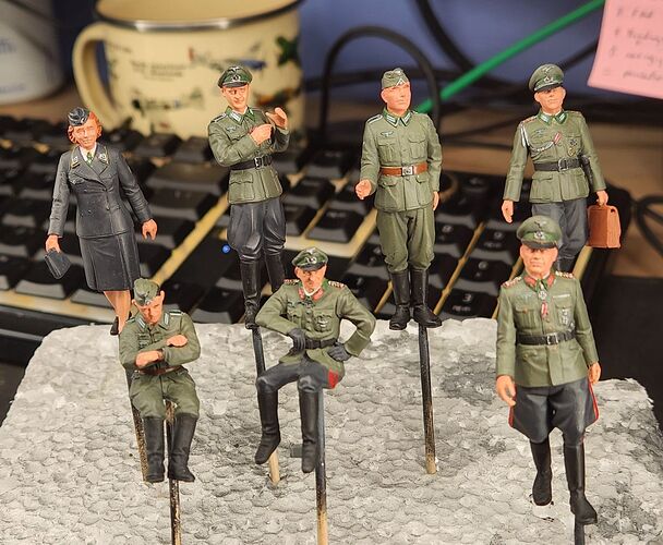

These are all using the Tamiya decals:
As mentioned a gloss coat where the decals will sit and softening agent are your very best friend here. A lint-free cotton bud or piece of paper towel to press it against irregularities to get them to conform to the topography is also great.
Very nice :+1:
