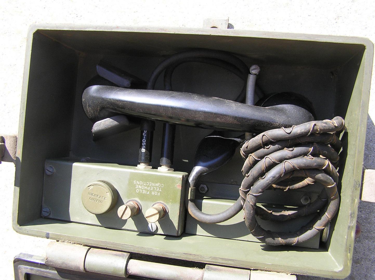

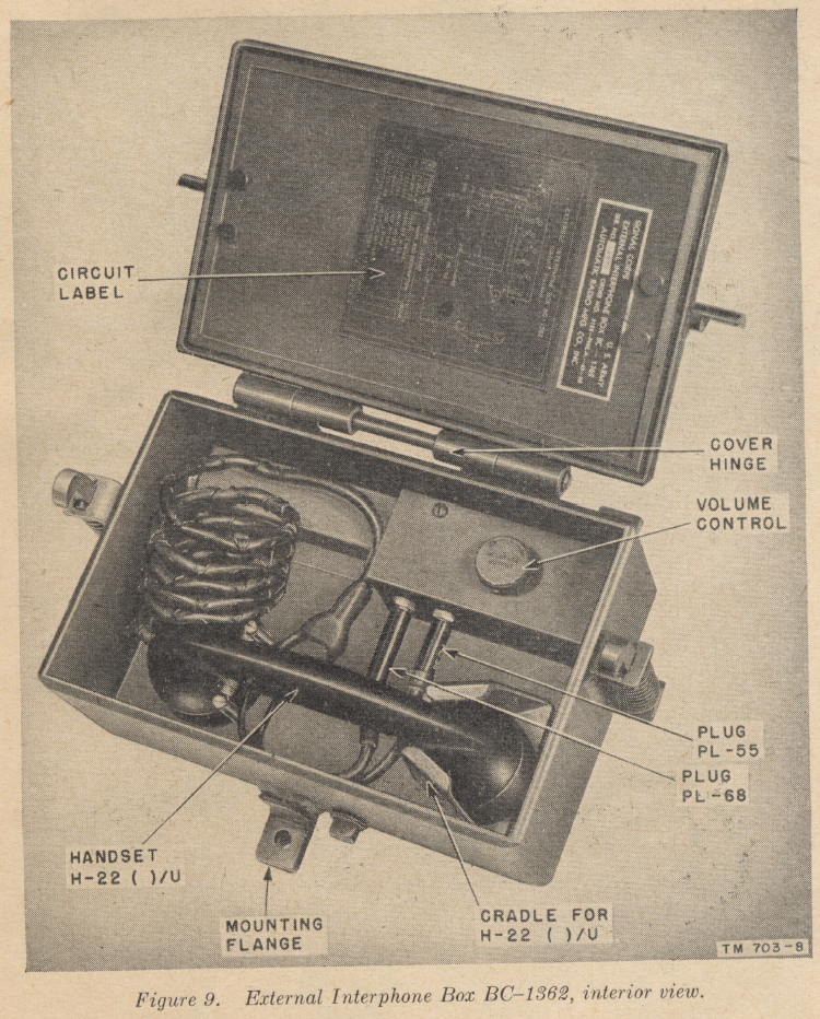

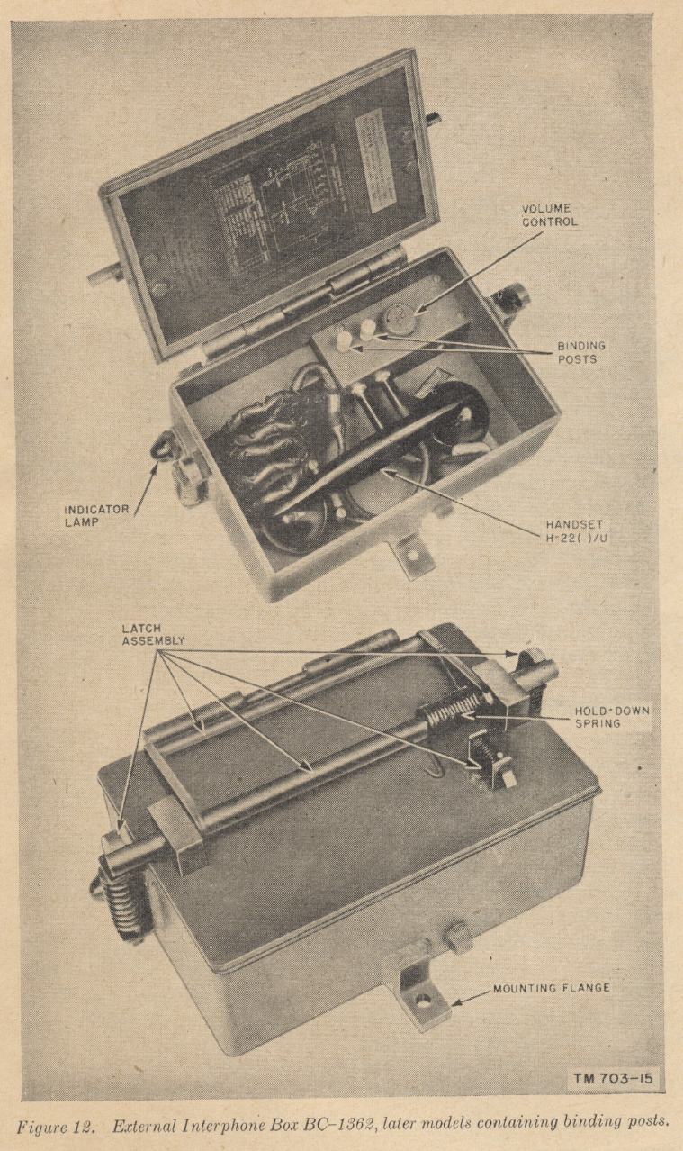

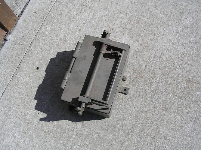

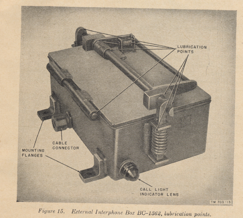

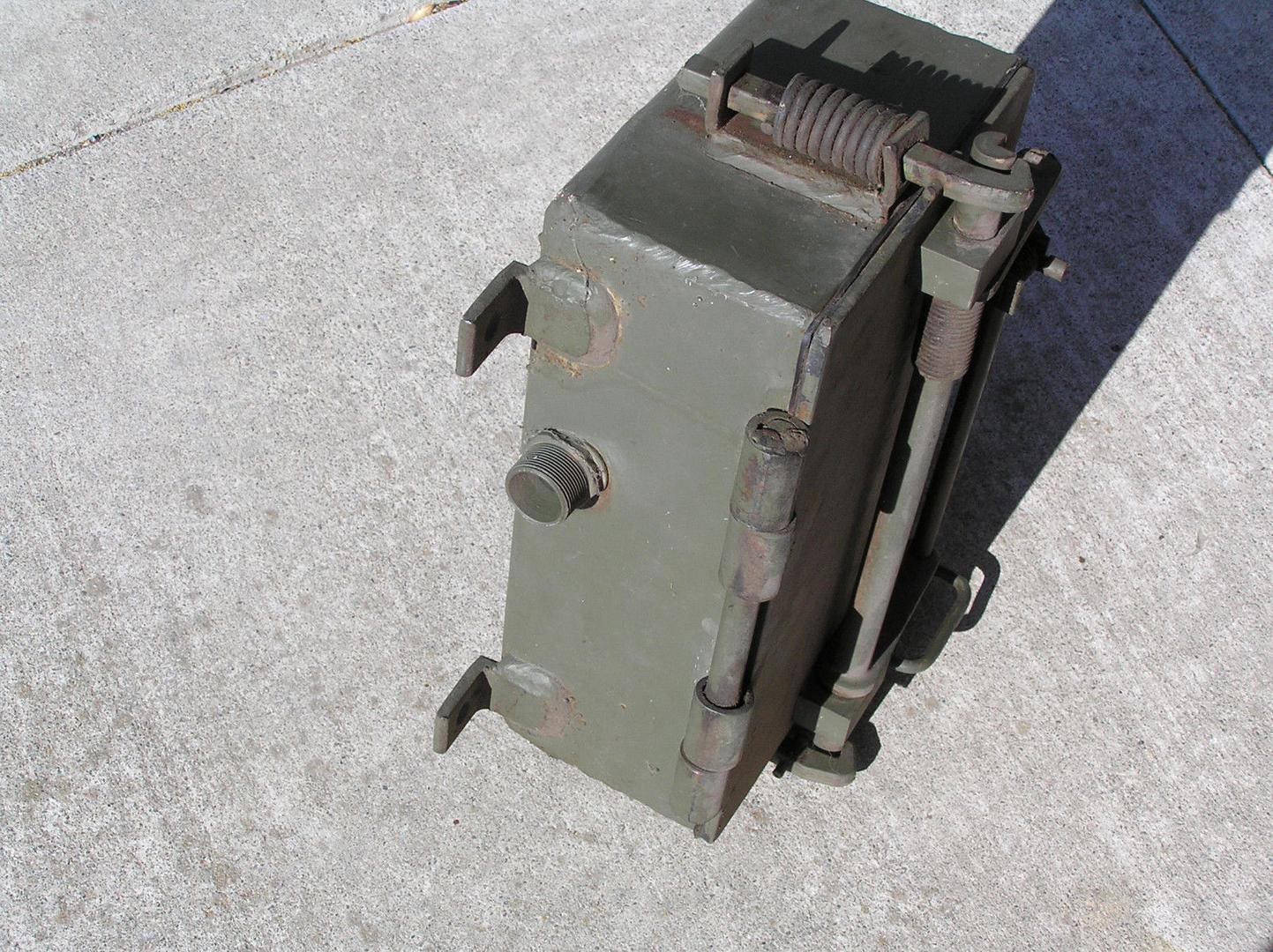

I know that the earliest ons in WWII were field improvised, using GI field phones in machine gun ammo cans attached to the hull rear and wired into the tank’s intercom system.
Early variant :
KL

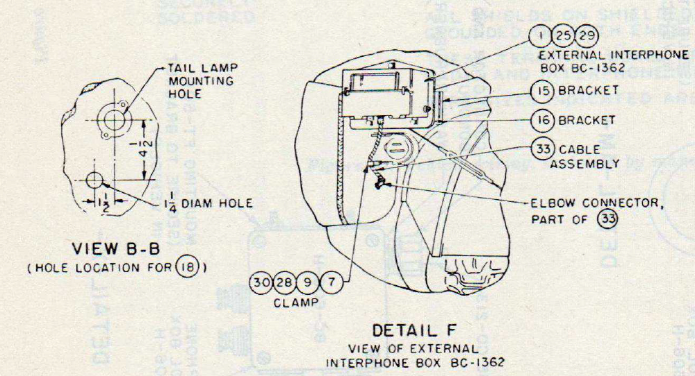

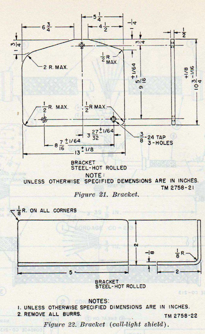

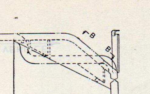

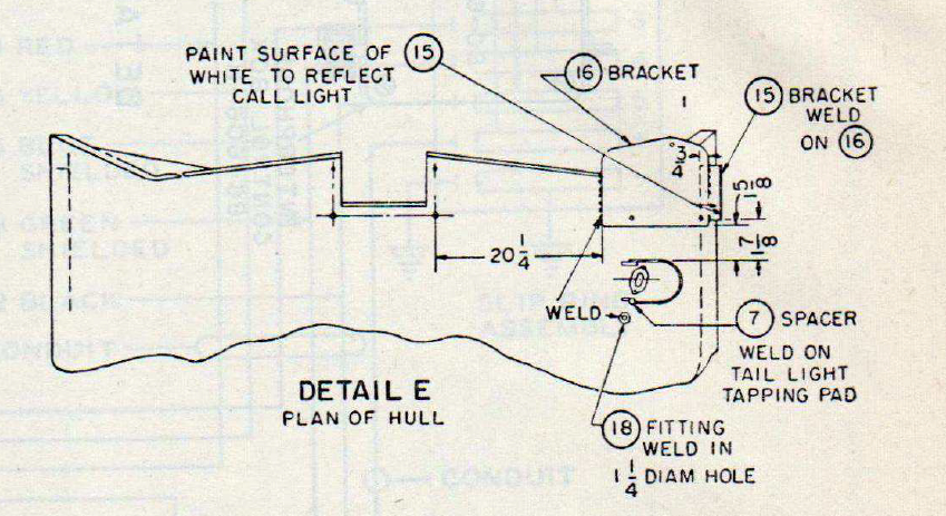

Brackets 16 and 15:

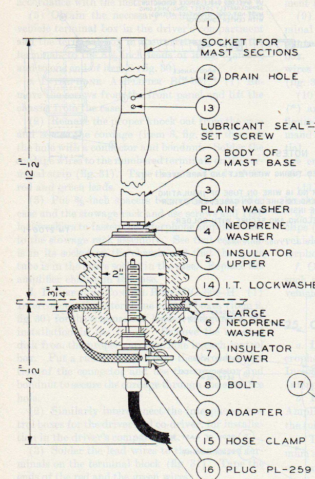

Weren’t you also asking about AB-15/GR antenna bases?

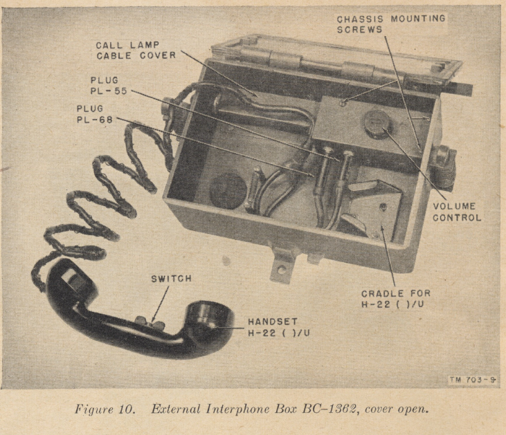

In case you need one in 1/35, Italeri includes this set up, with the hand set, on their M47 Patton kit. It could use a cord, but the basics are there.

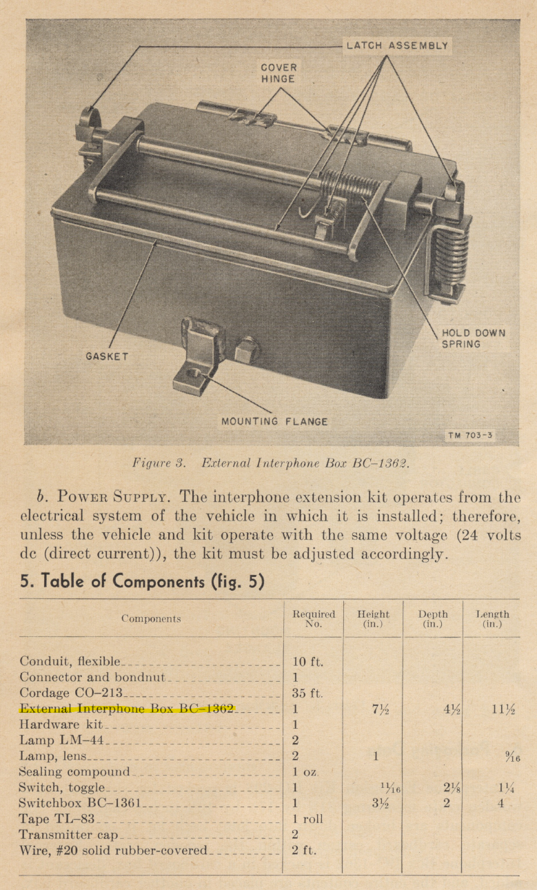

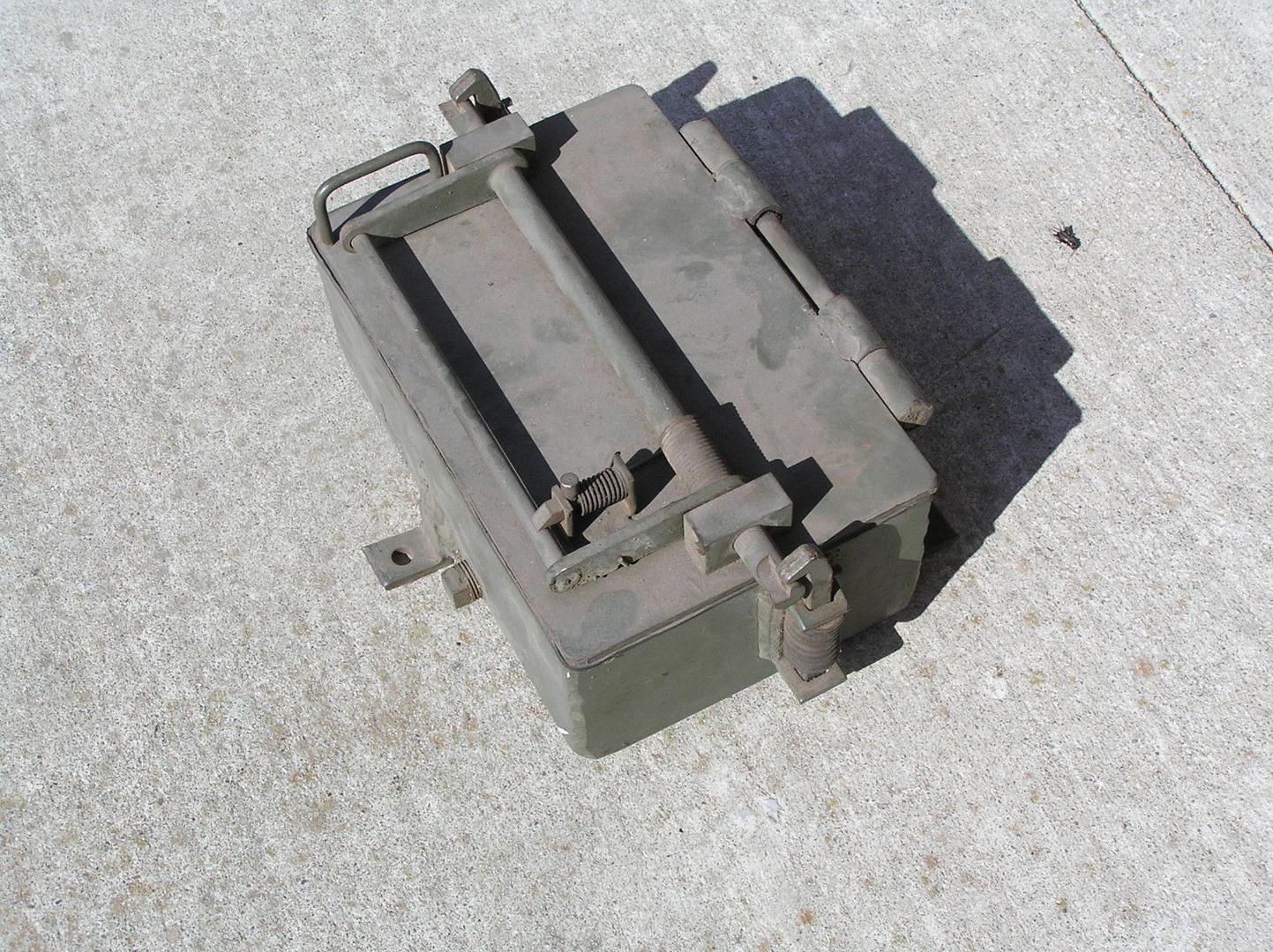

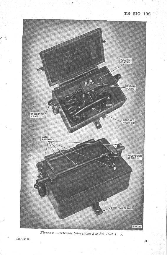

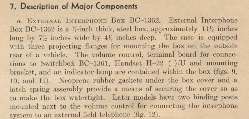

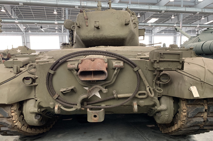

Thanks guys - that is far more, and much more quickly, than I could have hoped for.
Frenchy - the M24 photos are even more appropriate since I need the box for a ‘Bison’.
Kurt - the dimensions are great and the AB-15 data is also welcome.
Stikpusher - good call on the Italeri M47. Despite it’s age it’s still an outstanding kit. I’ll dig around in my stash and see if I still have one in stock but with the information provided here, I’m confident I can scratch the box (and get more satisfaction from the project).

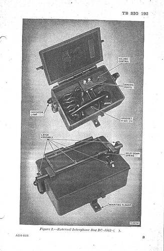

I want to say that the Dragon M26A1 and M46 kits also offer the phone box as an option, depending on which timeframe variant that you build.
