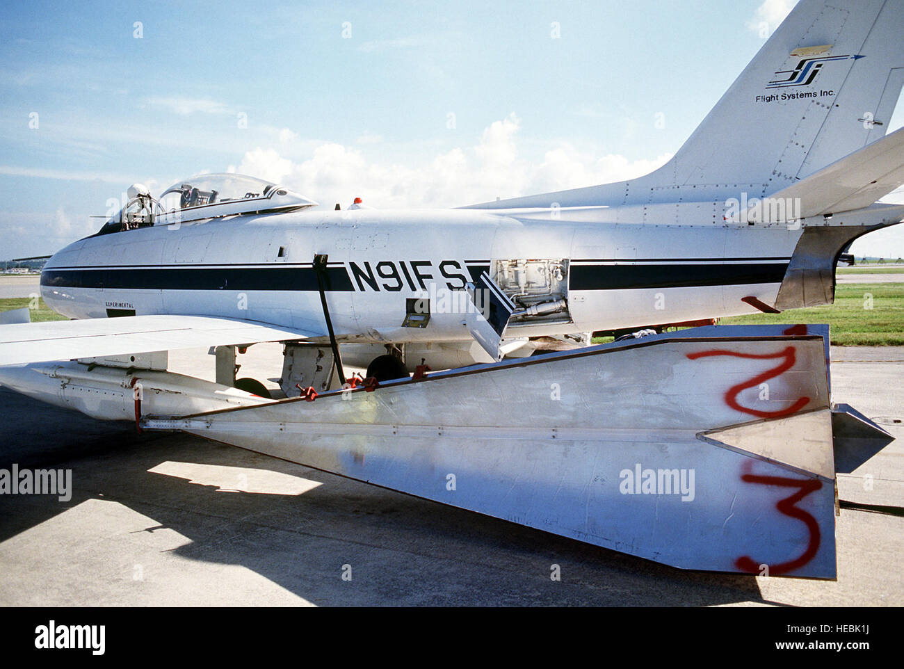

Another idea would be a Learjet with one. I think it was a JASDF bird I saw! Here’s a Swedish one in the UK. And a Flight Systems F-86.
A thousand thanks to Stikpusher for the back up with the tow targets.
Sorry to say but the orange target on the Swedish Learjet tower is not the same type.
As Orville said to Wilbur, “You’re right.” … :slight_smile: The body is more bomb like. Some sort of electronics on board? Make for an interesting project with one of the 1/48 biz jets.
