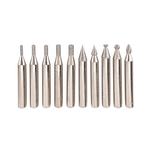

Another possibility is a pointed diamond tipped or carbide engraver on a Dremel. You can gouge and possibly add some very fine spider cracks with it.

I have a few dremel heads around somewhere and will go at the window with a blade also them.
