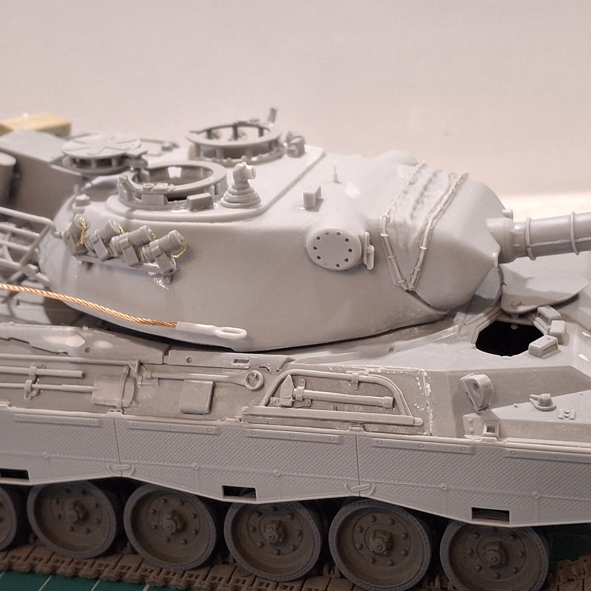

Did I not mention I was undertaking this? Perhaps I forgot! Anyway, here we have a Canadian Leopard 1A2 – often referred to as the Rent -a-Panzer (der gemietete Panzer) reflecting the short-term nature of the Canadian Army’s procurement, pending the introduction of the C1.

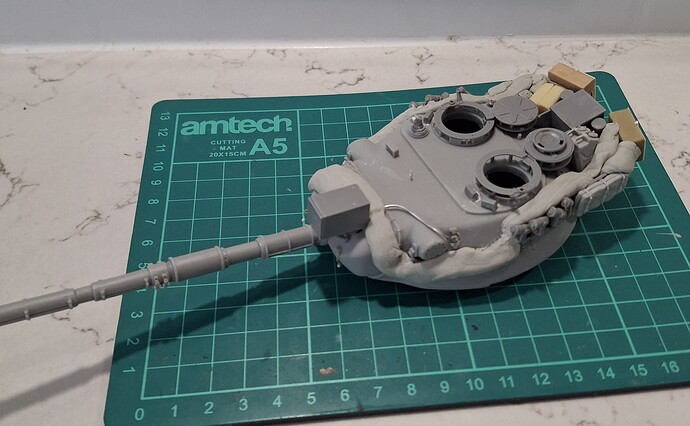

In the interests of accuracy I shelled out for the 1A2 turret available from Perfectscale Modellbau; this is in resin, and has the difficult-to-reproduce-otherwise, oval shaped rangefinder covers.

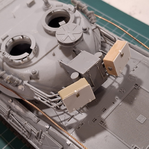

So, I thought I was ahead of the game, however, I found that the donor kit I was using, Revell’s 1A5, involved more hassle that I bargained for; there was the inevitable problem with using Superglue, and the polystyrene from Revell; it was exacerbated by my not fitting the searchlight stowage box at all well, which meant at the end of my labours, the stowage rack was hopelessly distorted, which was extremely frustrating. Could I strip it all down, without trashing the rack? Probably not, given the unforgiving nature of Superglue. It’s only out by around 5mm but that’s enough to spoil it all, and sadly visible. The only option I could think of was to try and obscure the upward leaning rack with carefully placed stowage, and hope that any observers would not notice. Well, that’s the plan.

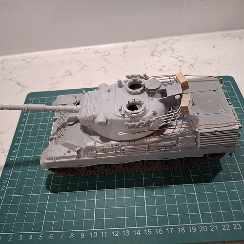

This is as far as I’ve got: tow cables from Karaya, (had to be shortened by around half an inch) are about to be fitted. I’ll glue them first then add brackets I think. We’ll see which is easier.
Elsewhere, I’ve had to use Mr Dissolved Putty to tackle a few errant seams; fit wasn’t brilliant in places. That said, it may have been me. I have rushed it a bit, which would explain a lot.

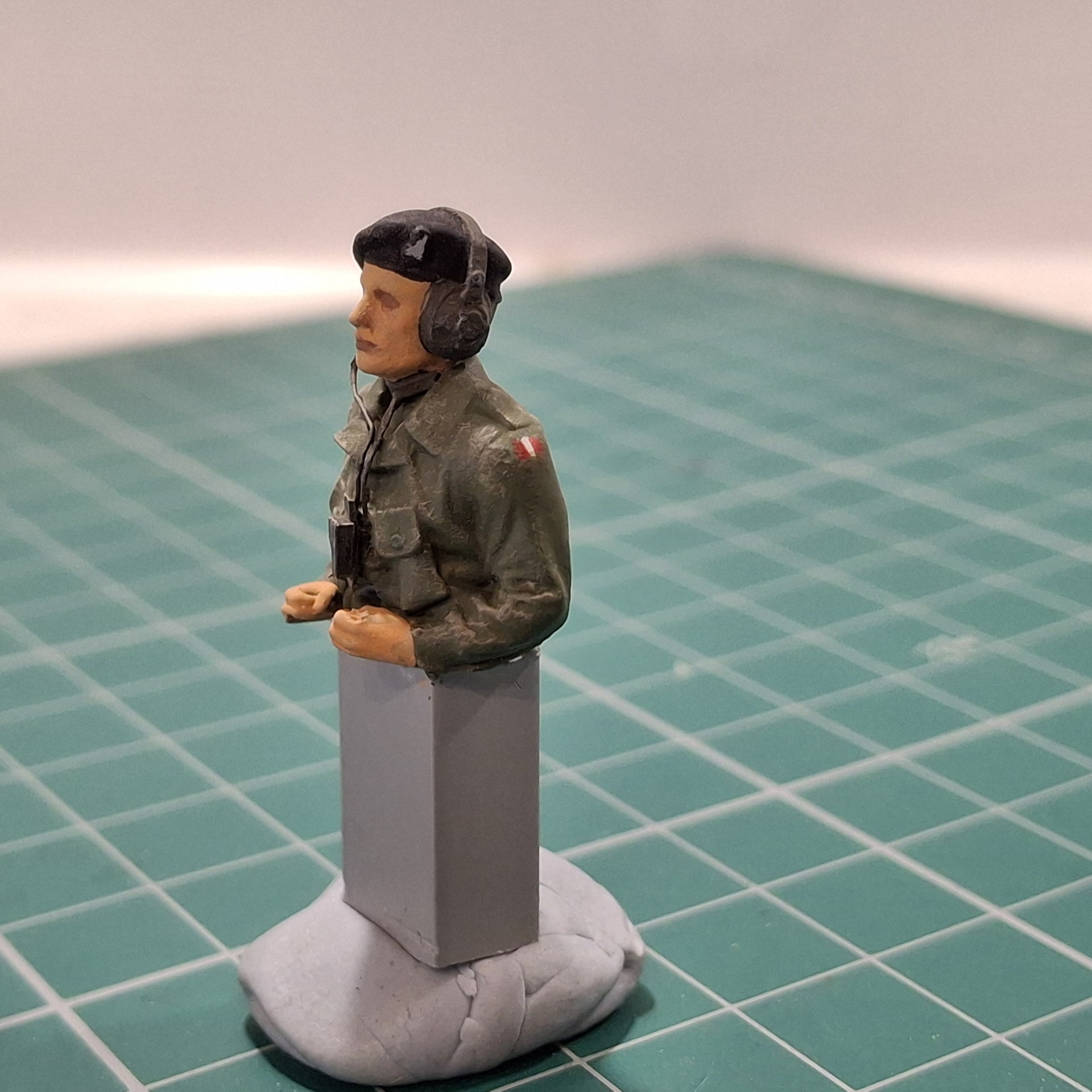

I’m all ready to go though; decals all ready, and a crew in waiting, the Driver also shown here:
Well, that’s where we are; having to camouflage a major error - not my finest hour(!)

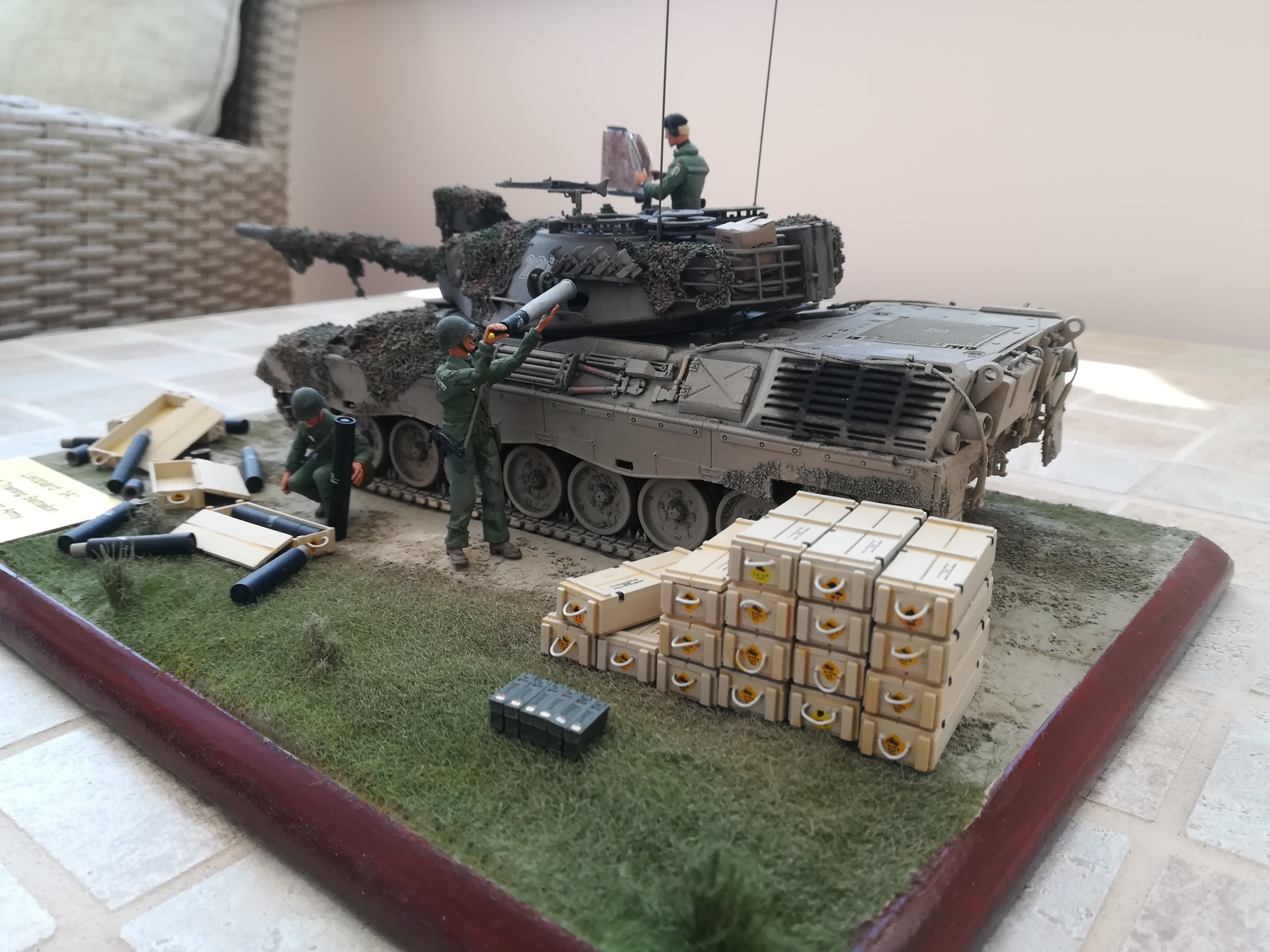

Here’s my Canadian Leopard 1A2 built using the PSM turret and Revell Germany hull.
That rack is calling out for a badly-stowed camo net! Some day I need to tackle an A2 - I just wish there was a plastic turret option…
I agree - re a plastic option, as Dear God, this turret nearly broke me; I think it must be quite an old mould as the recesses for the stowage box were less than sharp, ditto for the smoke dischargers and so on. I may well have got the sequencing wrong with the stowage rack, but it turned out to be a real pain.
I had thought that for an A2 turret all I really had to do was make my own oval-shaped rangefinder covers but it’s not just that, it’s the thickening of the armour plate at the turret bottom which requires attention, and I’m not sure I have the skill set for that.
Italeri market one of their Leos (No 374) as a “1A2” but it isn’t, just in case someone pipes up with it all; it’s a 1A1.
Right, where’s the “badly-stowed cam net”?
Yup - saw the Italeri one and noted the lack of A2 details! For an A2 shell you really need to add a good 1mm of extra thickness on the sides and rear, maybe by rolling on a sheet of putty? Then it gets curved in at the bottom. And don’t forget those rangefinder hoods! All in all a conversion too far if doing it by hand…

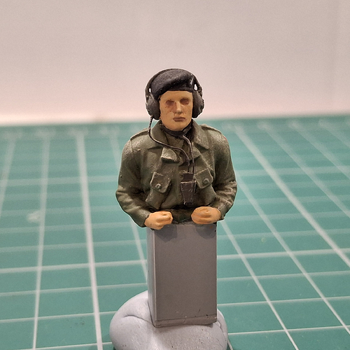

A couple of other things to note are the use of the German antennas and the Canadian crews used the Bundeswehr headsets with throat mic’s, not the standard Gentex headsets with boom mic.
Thanks Jason; nothing like first hand info. The picture is very useful too.

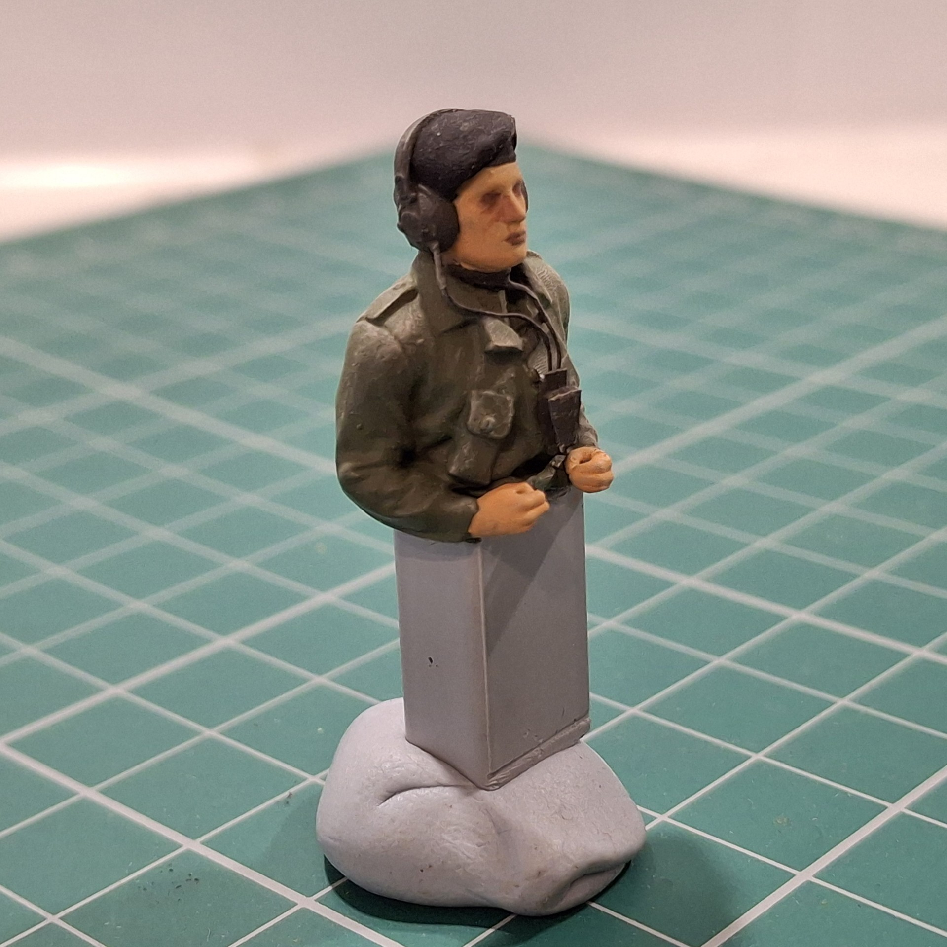

I’ve altered the mikes on the crew - initially from Sylly’s Models - but as I say, now altered; I showed the Driver (which is the only one I’ve completed) before, but here he is again:
Luckily, depending on the pose of course, throat mikes don’t show too much.

Right, let the great cover-up commence:
