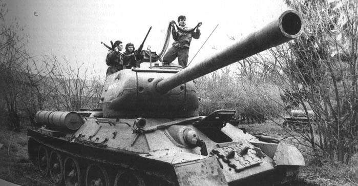

For T-34 action in the 1990’s in the Balkans, Yves Debay did some fantastic work.
Excellent if you can find a copy.
Has a Croatian T-34/85 w/a .50 Cal M2 if I recall correctly.
The Croatians cobbled a lot of stuff into their T-34s to make them battle ready, American M2 Brownings, T-54 roadwheels, Rubber matting… You name it.

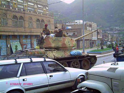

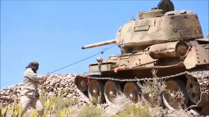

They have fought in Yemen.
One photo illustrated a T-34-85 in what can only be German World War II-inspired three-color camo.
He’s so going to need a bigger leash for that!
You can literally see the hole on the side of the turret for the pull cord on both photos.
First photo. But it was a T-34 in a street and the colors were more pronounced.
Of course, that’s a lot of dust there too…
Found it!
Has to be the tank. The photo I saw was of the port side.
