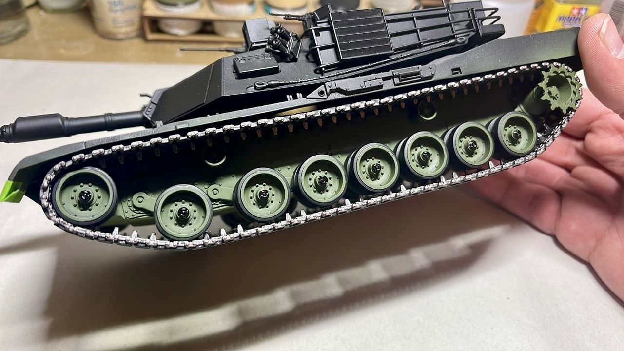

I used Tamiya acrylics with Mr. Color Leveling Thinner and i was very happy with the end results. I will shelf all my other thinners and use Mr. Color from now on.
Paint came out really smooth and uniform.
