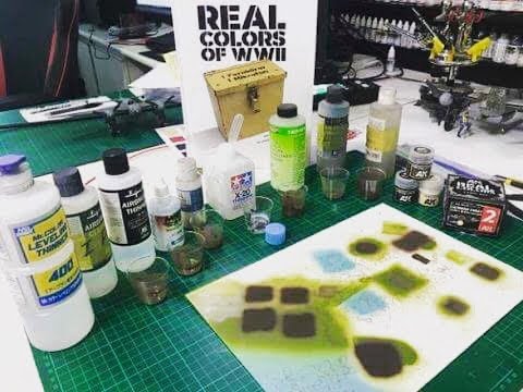

In this review they are tested with a variety of popular thinners including AK’s own and water.
