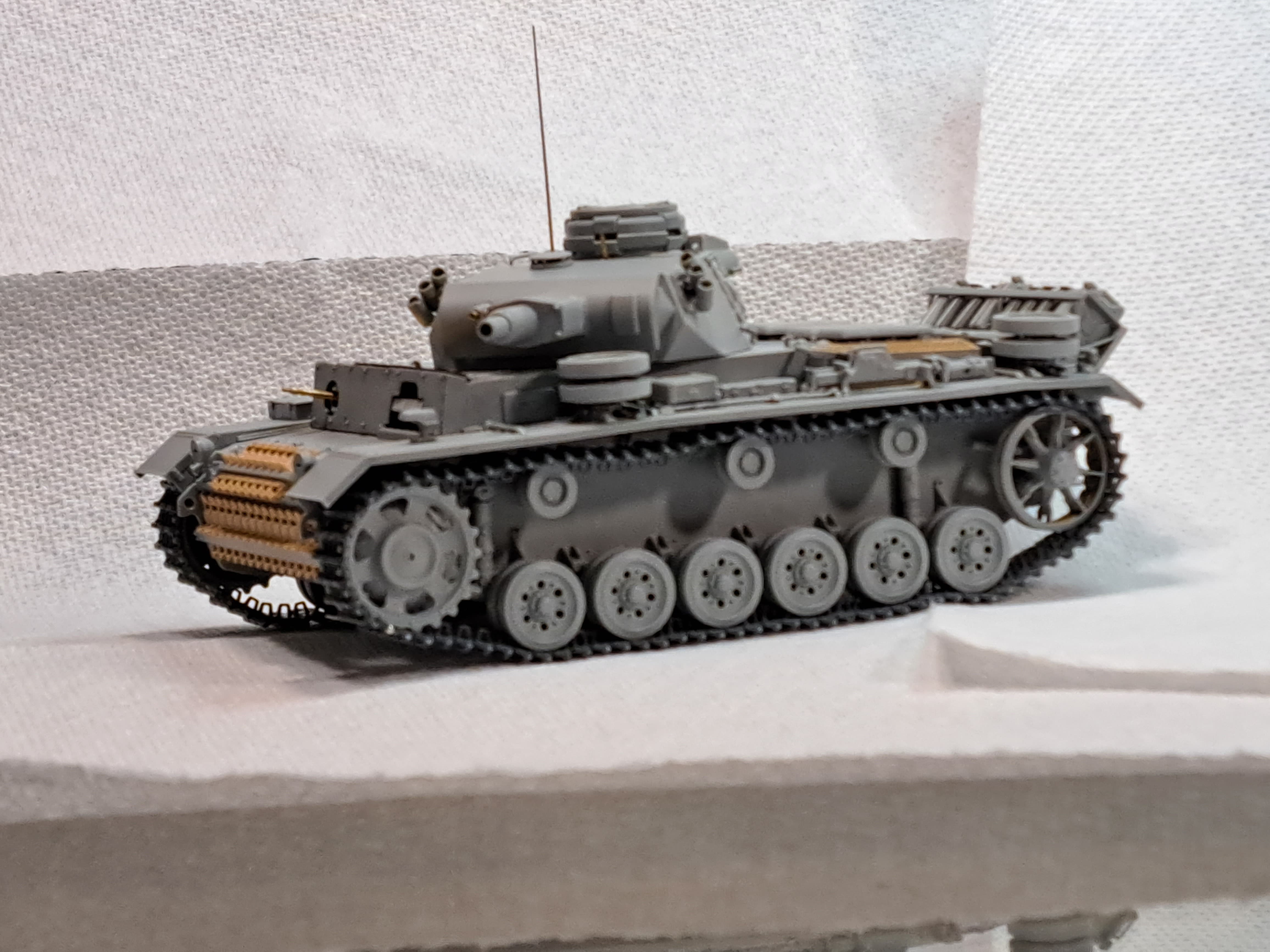

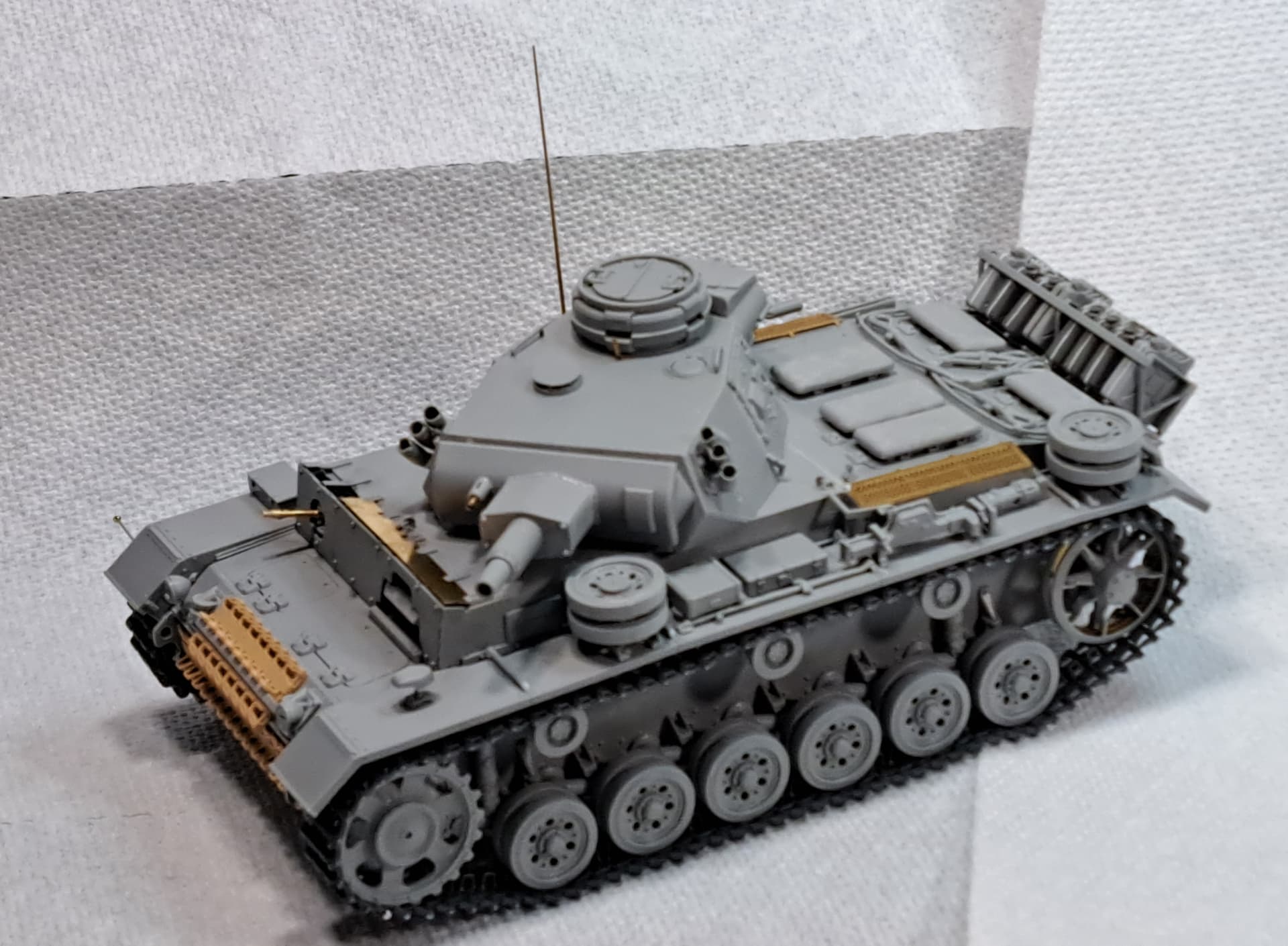

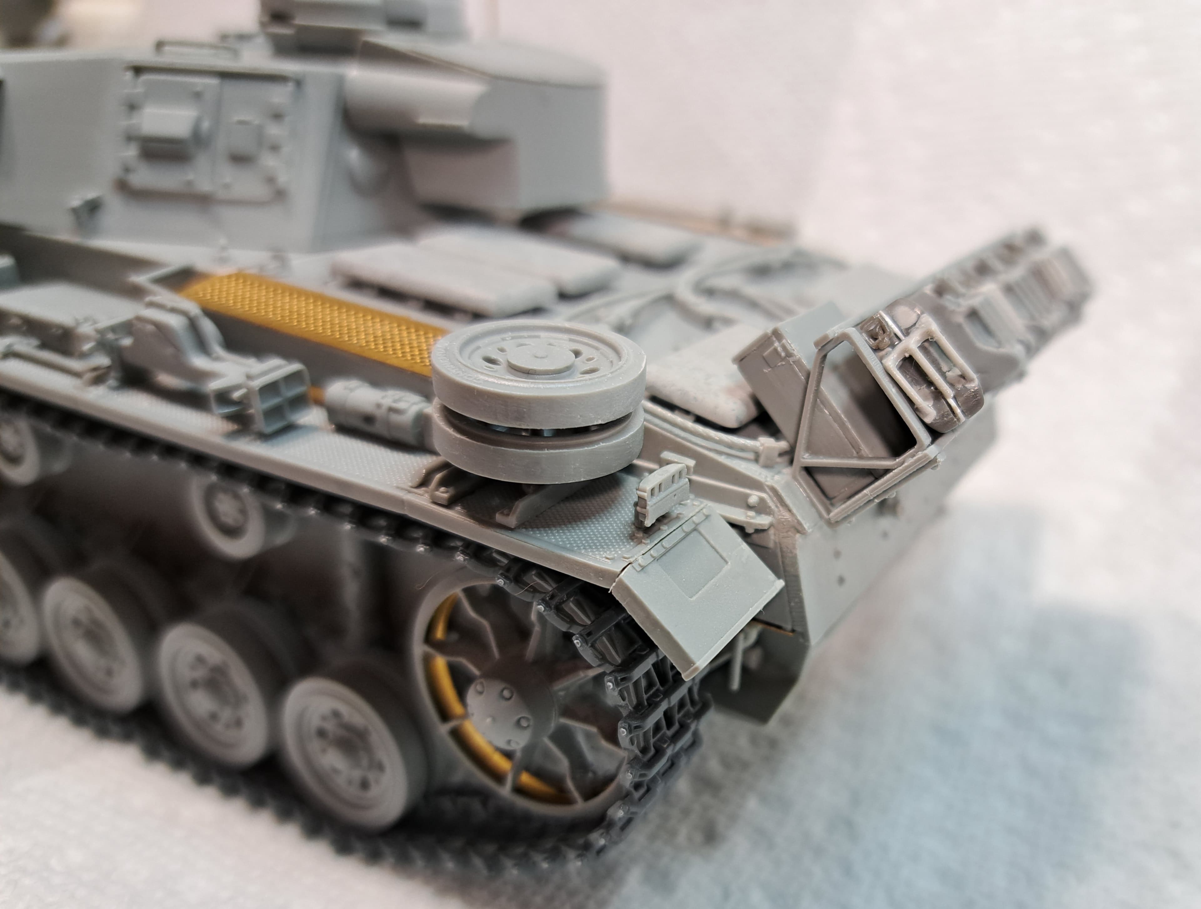

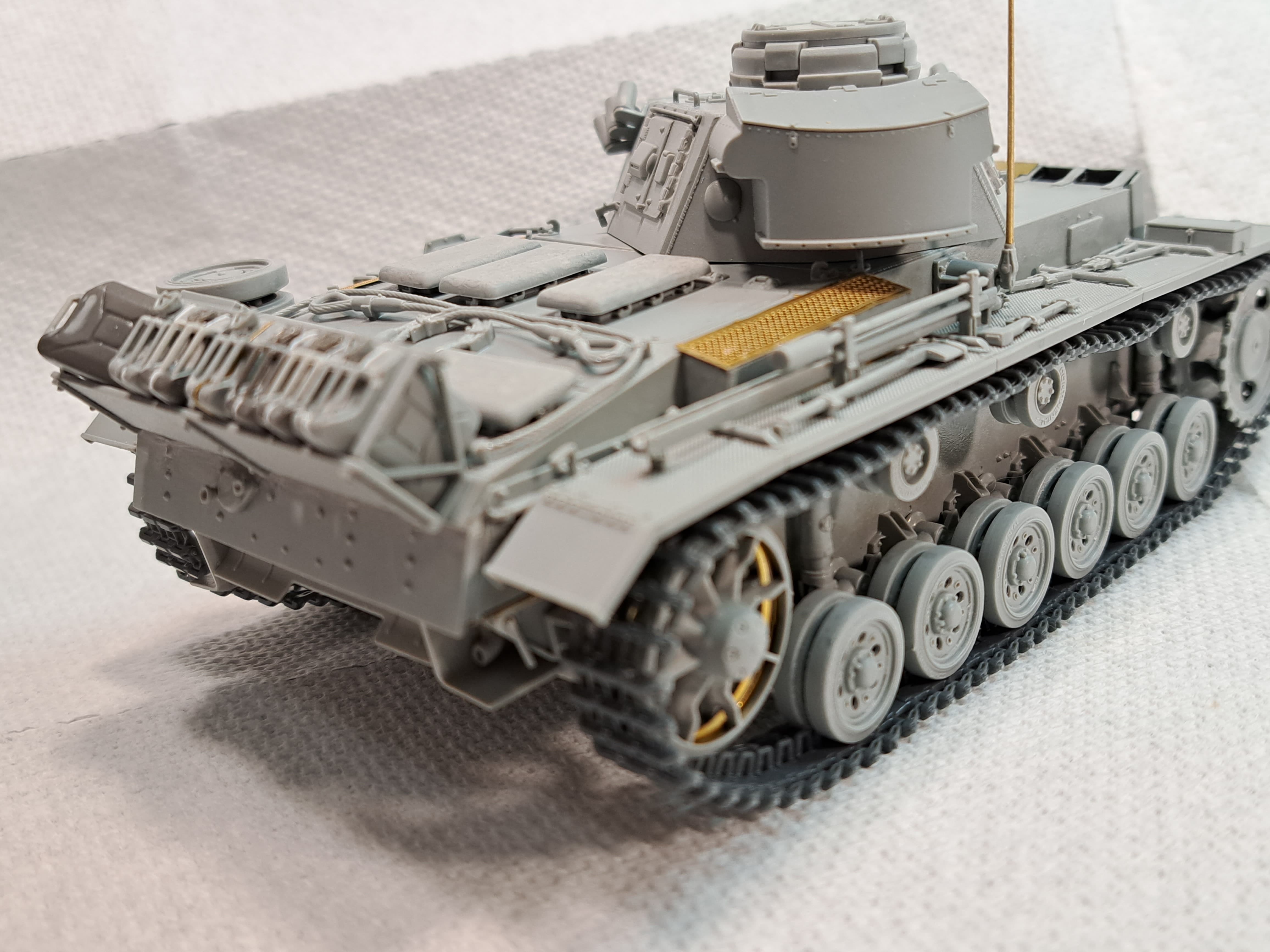

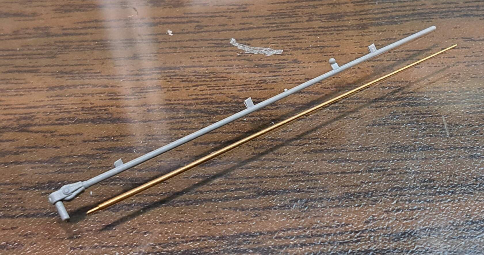

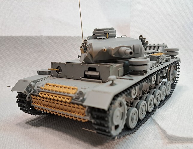

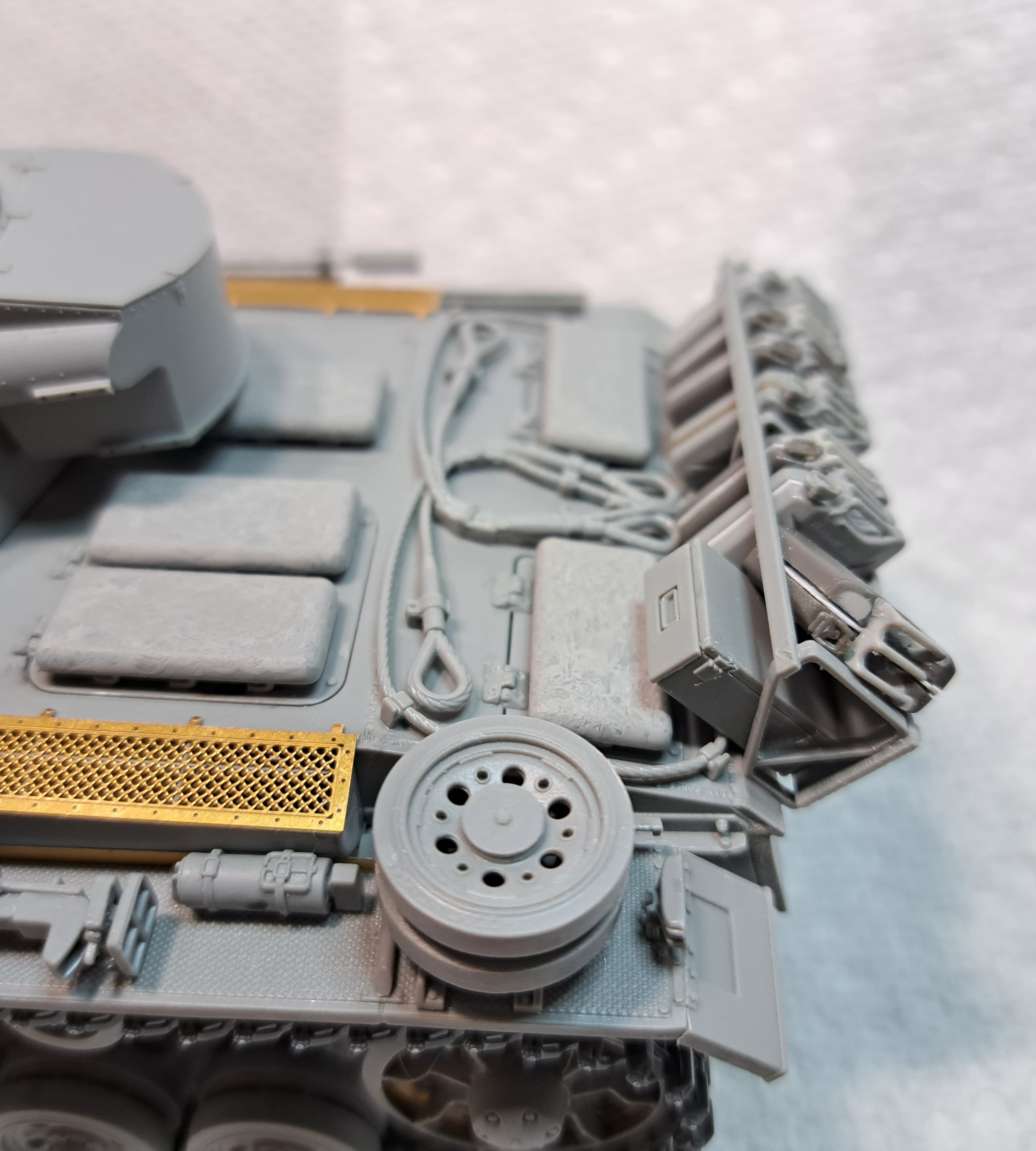

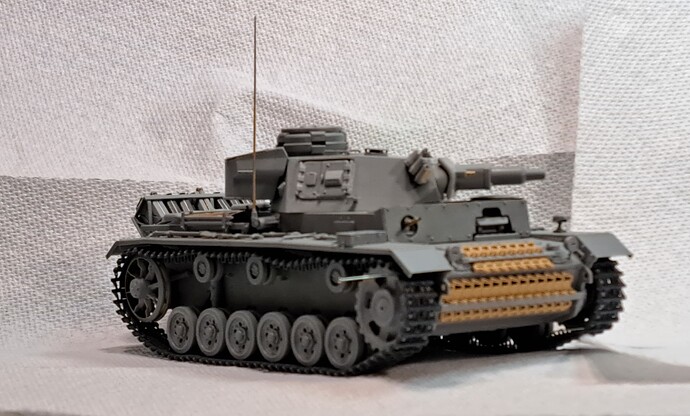

Time to add antenna:). The kit antenna is impressive. I saved it for a lesser project.

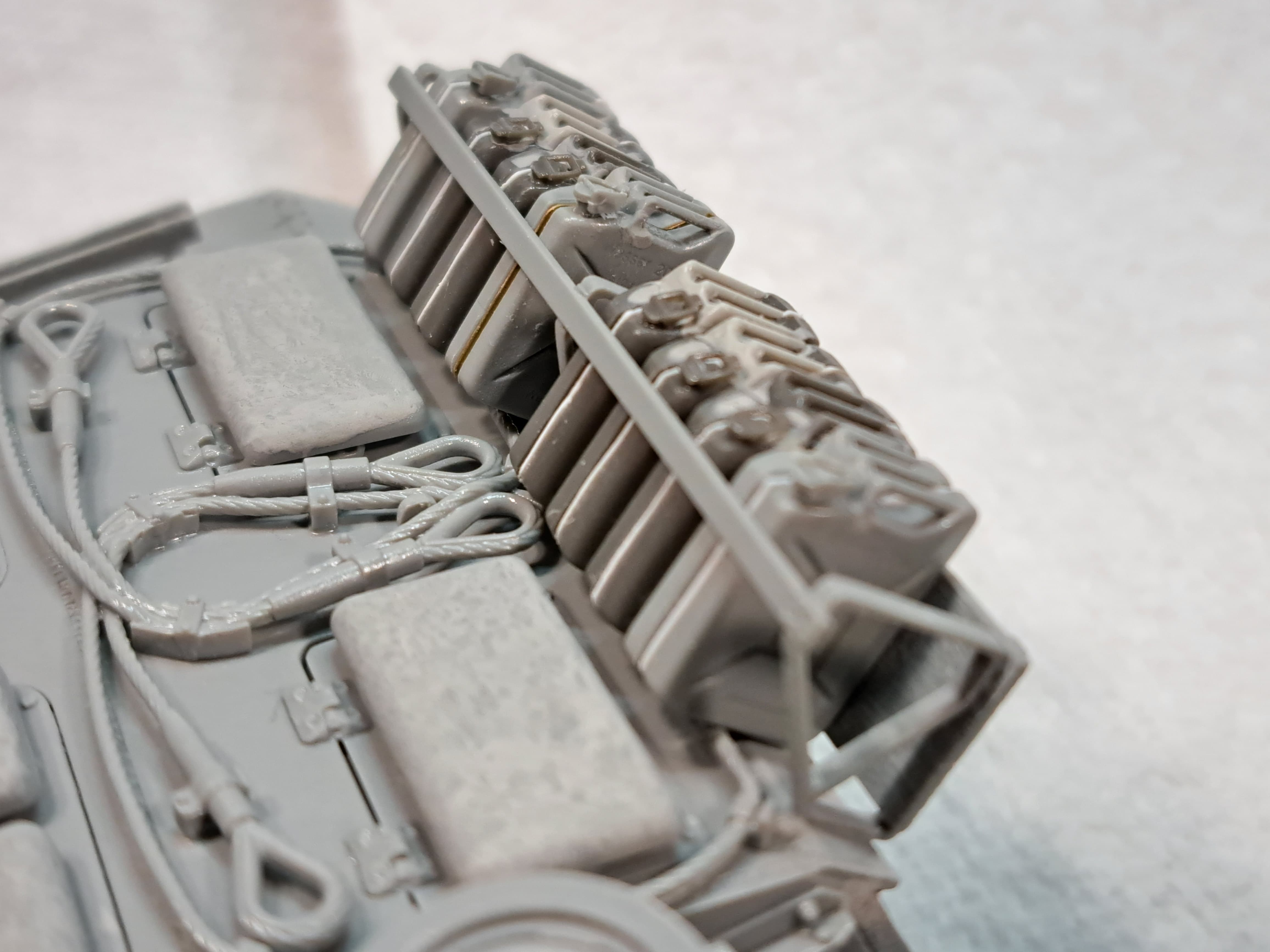

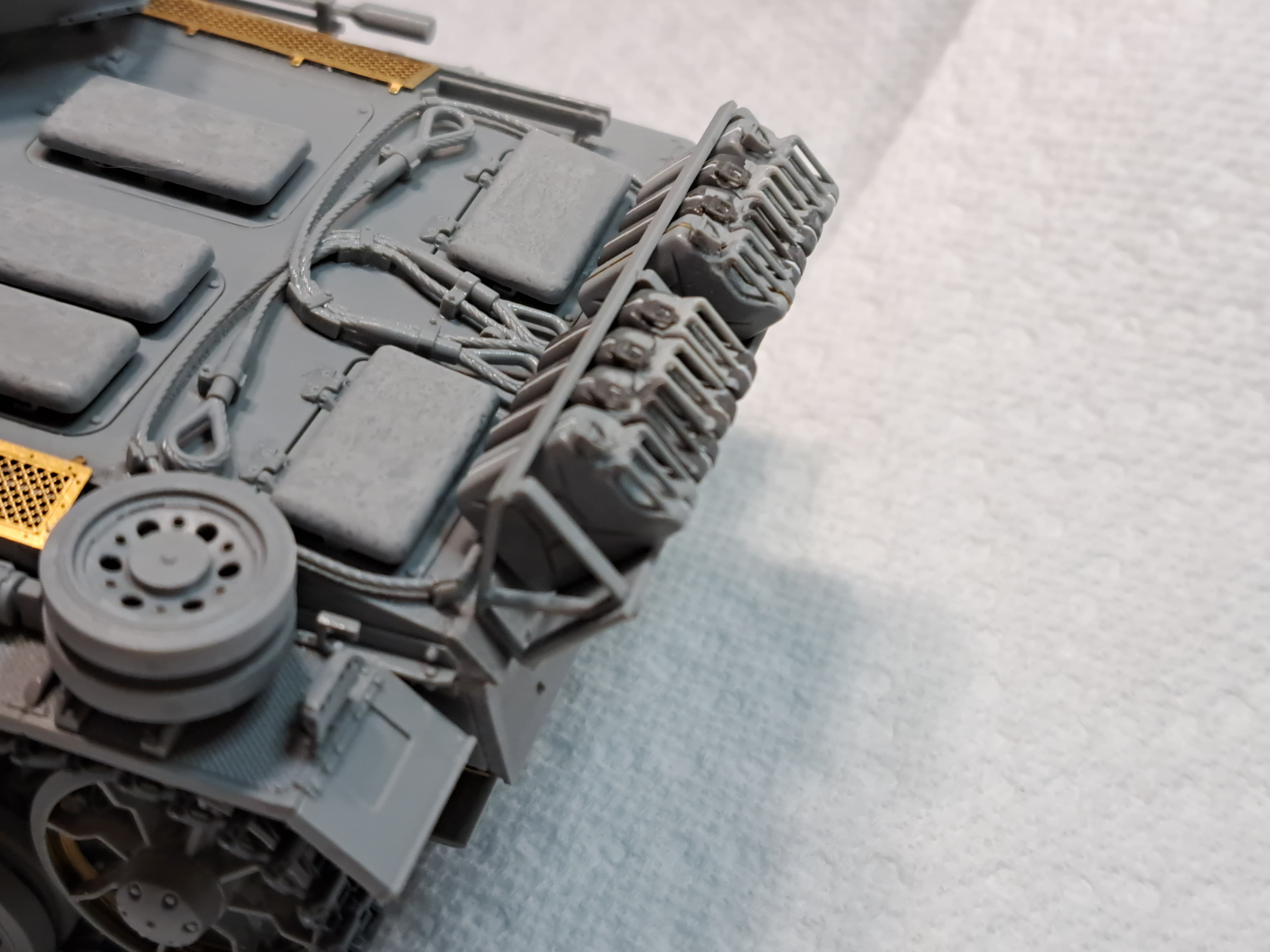

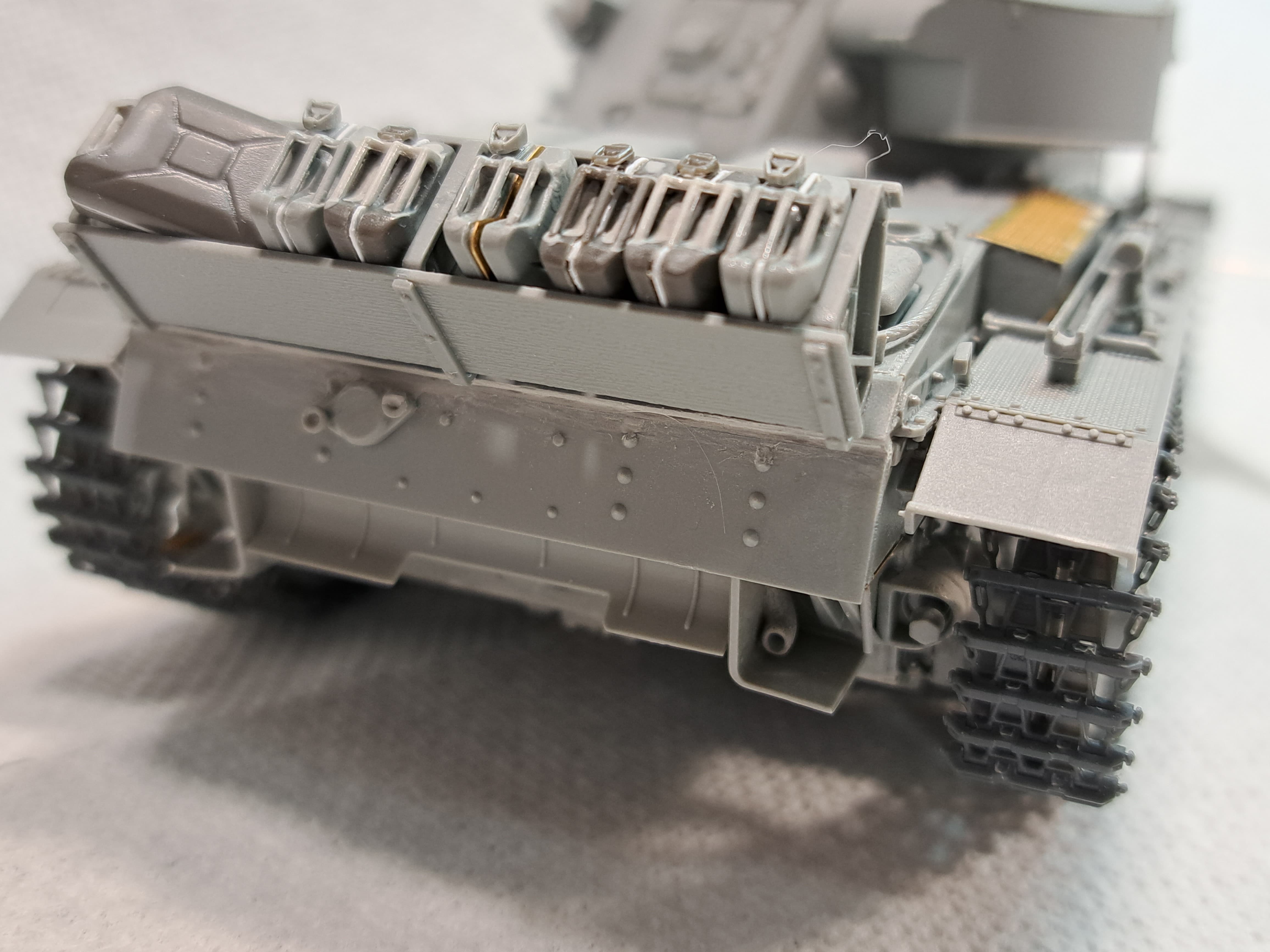

Added spare hollow tooth tracks left over from an RFM Stug III G early. Added extra several Italeri jerry cans to round out Dragon cans on rear stowage rack.
Alternative stowage with box in place of jerry can.

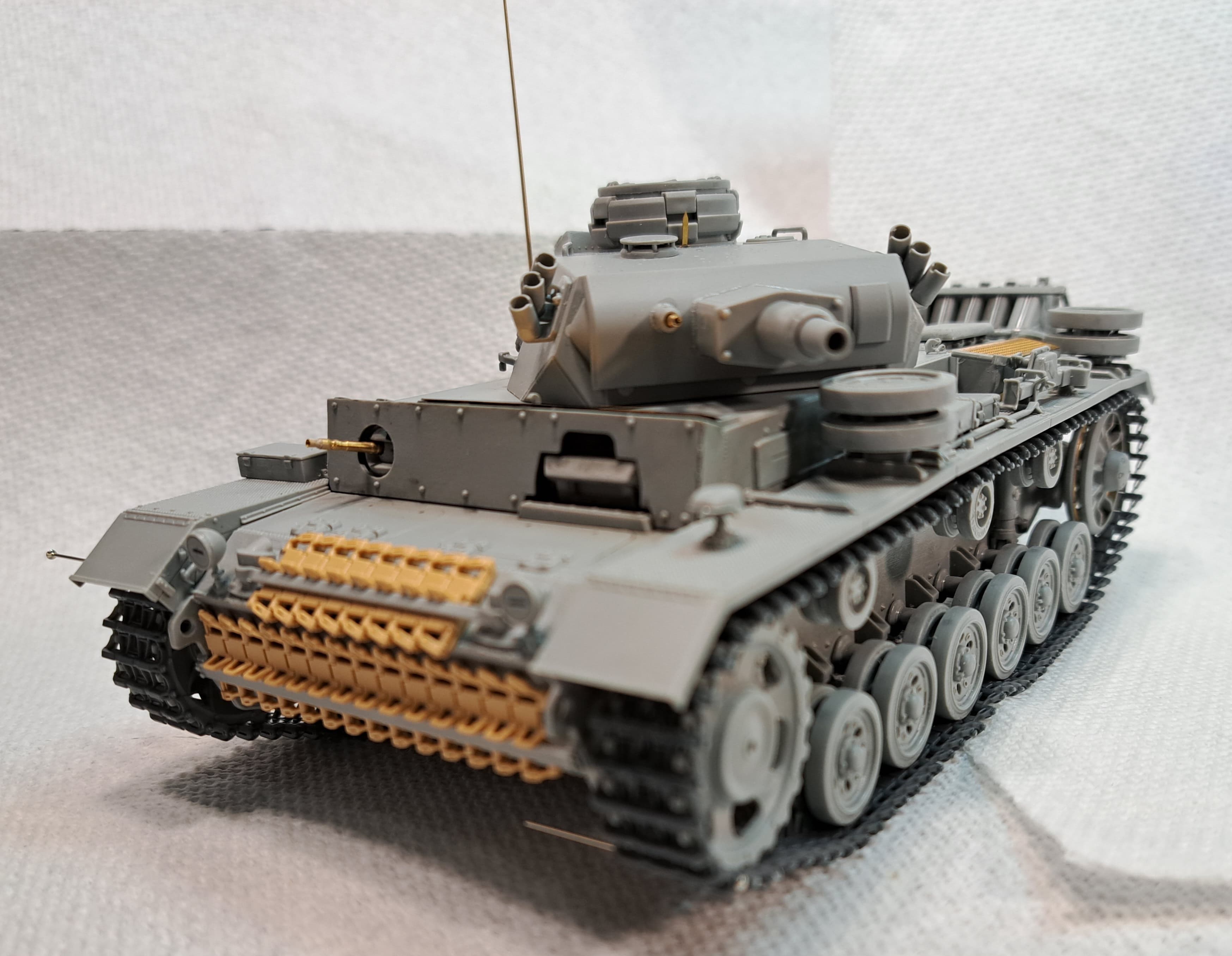

Best points: Crisp molding, excellent details, excellent fit of major components, some accessories included.
Worst points: Punch marks on Turret face, terrible instructions, one PE part referenced not included, overall mediocre engineering, punch mark covered link & length tracks. High Premium price for a rehash watered down kit from ~15 years ago.
Would I buy this $80 Dragon kit again? NO :-1: :-1: :-1: I’d pass on buying another copy at $50.
Would I recommend this kit? Overall, recommended as I think most will like the level of detail, accept the unfun build experience with good grace, tolerant Dragon’s lousy instruction sheet and be happy with the end result.
Rating 7.5 out of 10 for Neo #5
With Magic Tracks, good PE sheet and coherent instructions this kit would easily be 9 out of 10. Dragon seems to usually find a way to compromise their best kits.
Personal Bias - Happier with the Tamiya Pz III N build at ~27 to 28 hours than this Dragon at ~36 hours. I don’t feel like there’s much benefit to the extra 9 hours of build time. The Tamiya kit was far more enjoyable and fun to build. Adding details to Tamiya’s Pz III proved oddly satisfying in a way the far more out of the box Dragon kit did not.

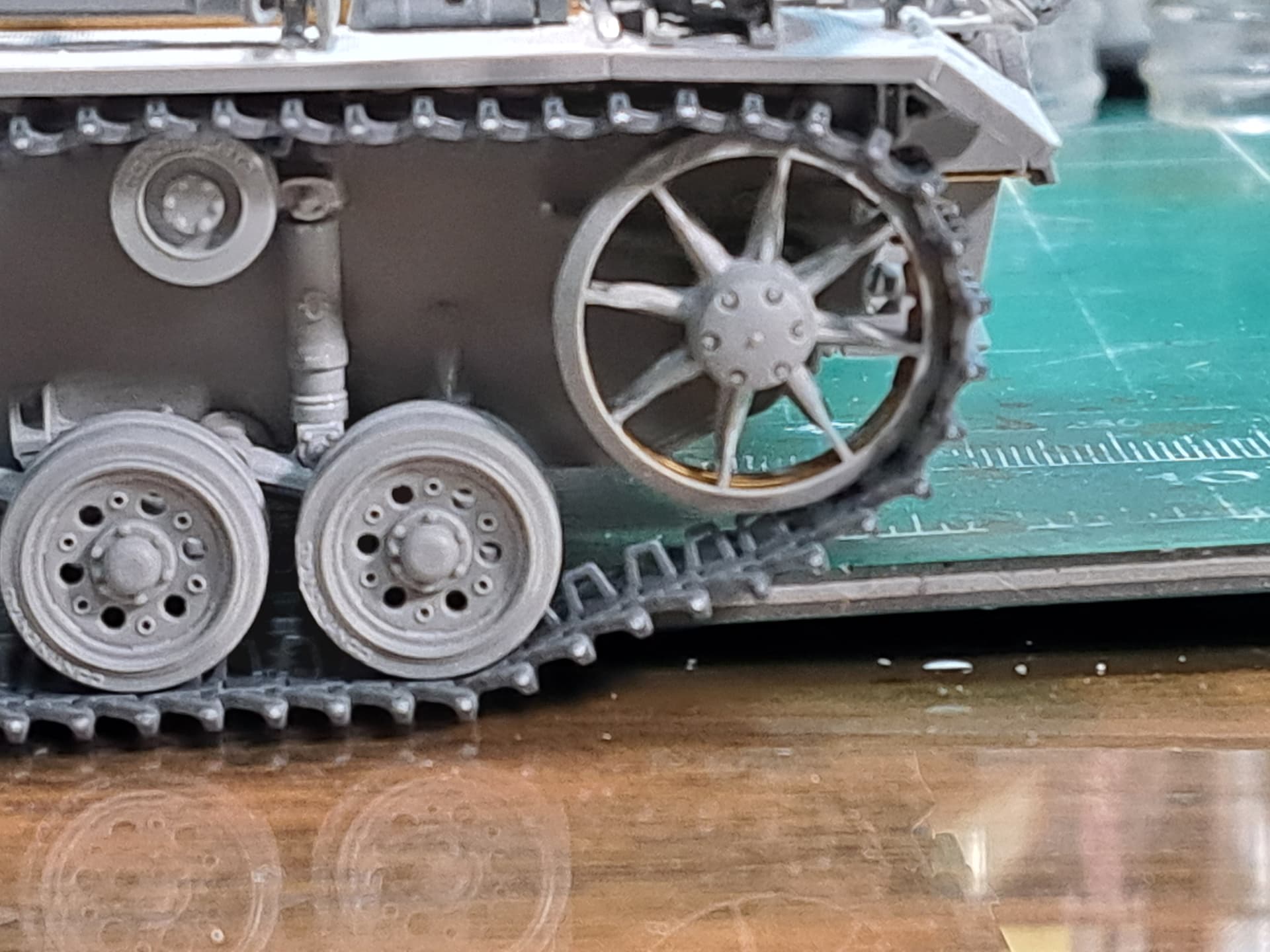

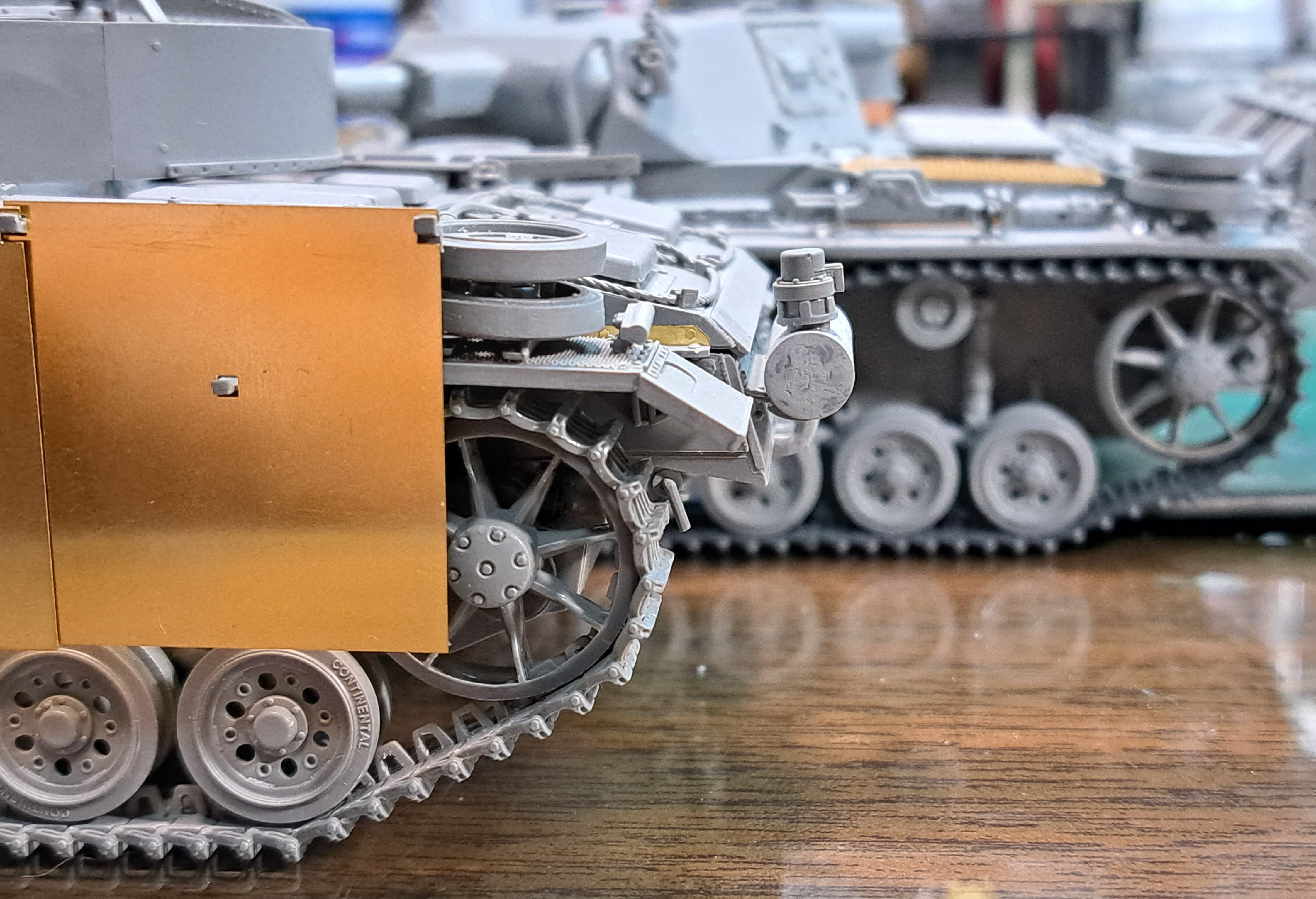

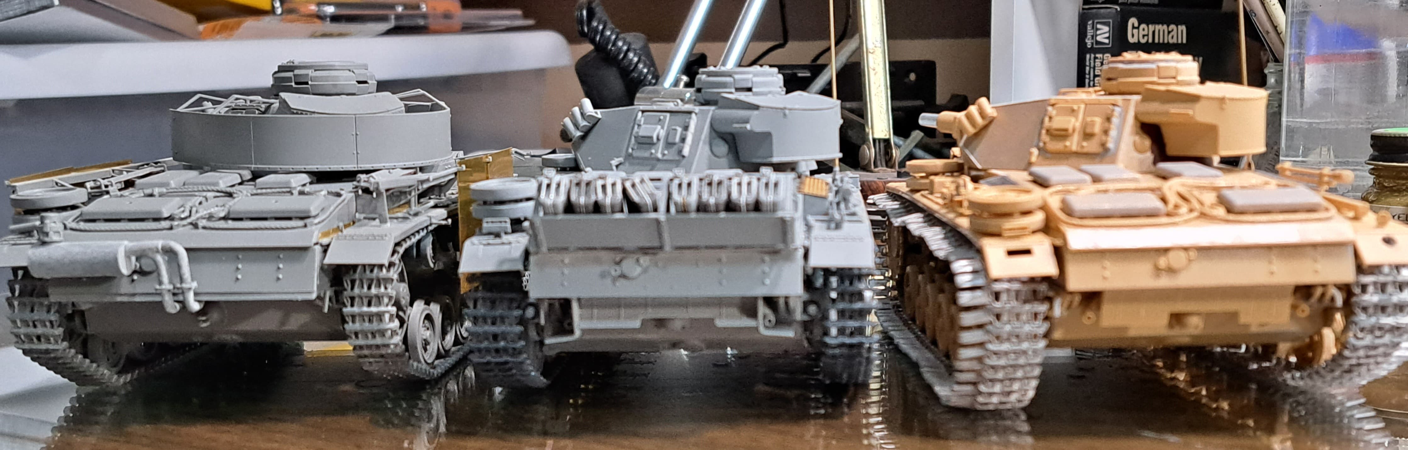

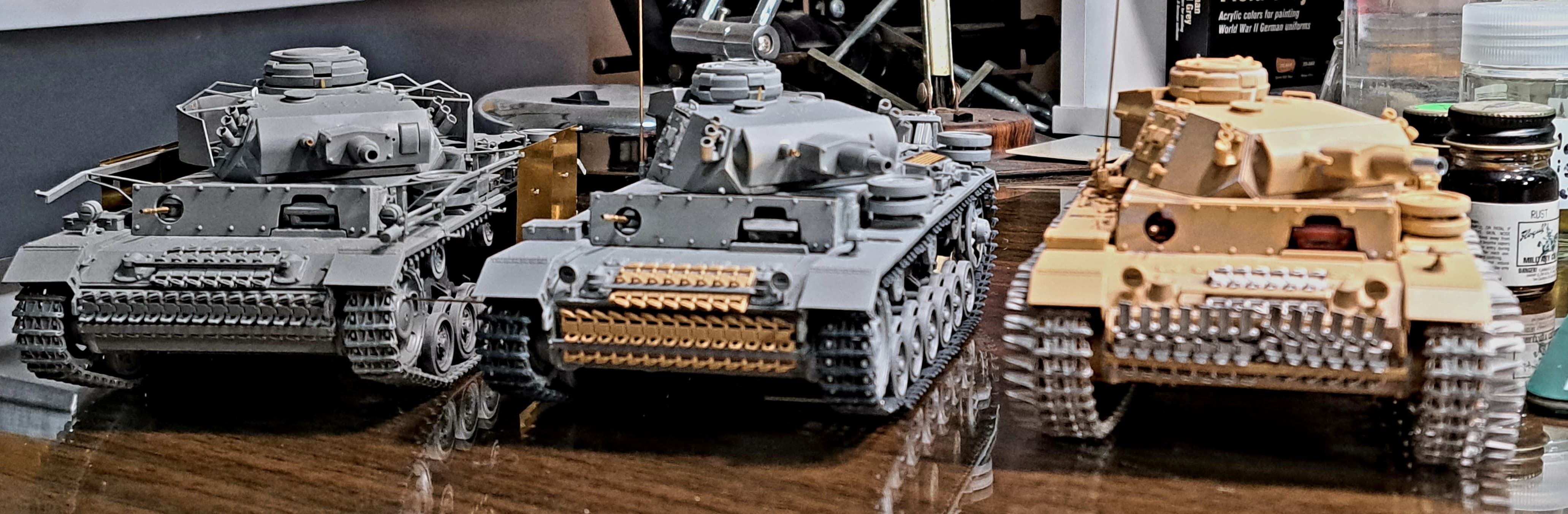

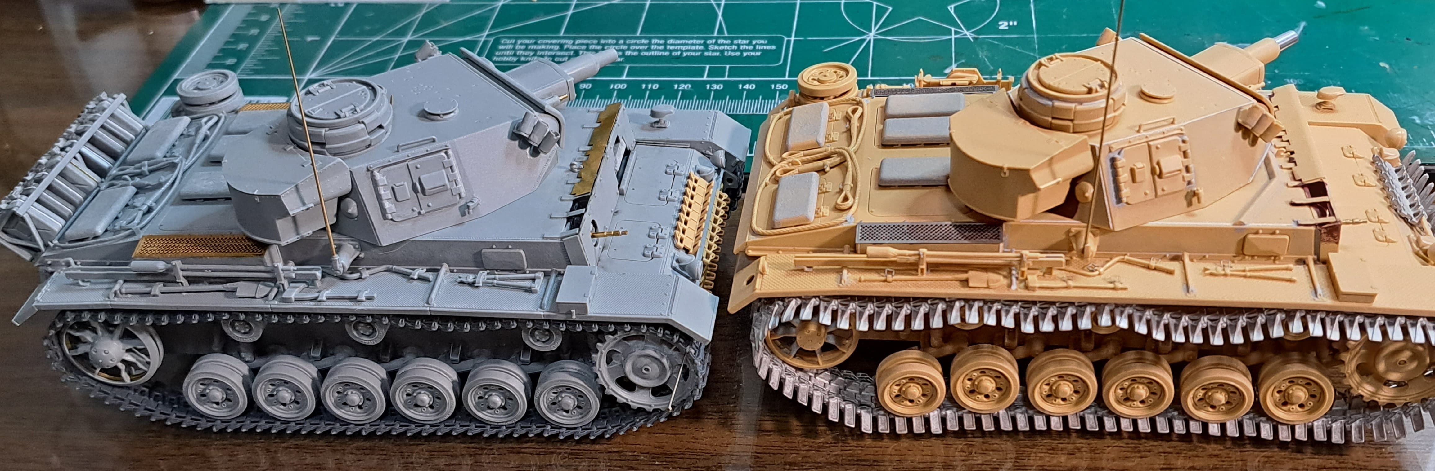

From what I gathered on Missing Lynx in the Pz III thread mentioned above, one of the noticeably wrong areas for Takom is the space between the last road wheel and idler. Looking at track links looks like ~3 full links of space on the Takom kit (skirt PE)shown below.
The Dragon kit which is regarded and checked as more dimensionally accurate looks like 3.5 track links
Looking at the models side by side, to me doesn’t seem like that big of a deal. I’m sure there are other visual differences but to me this was the most glaring that once noticed stands out.

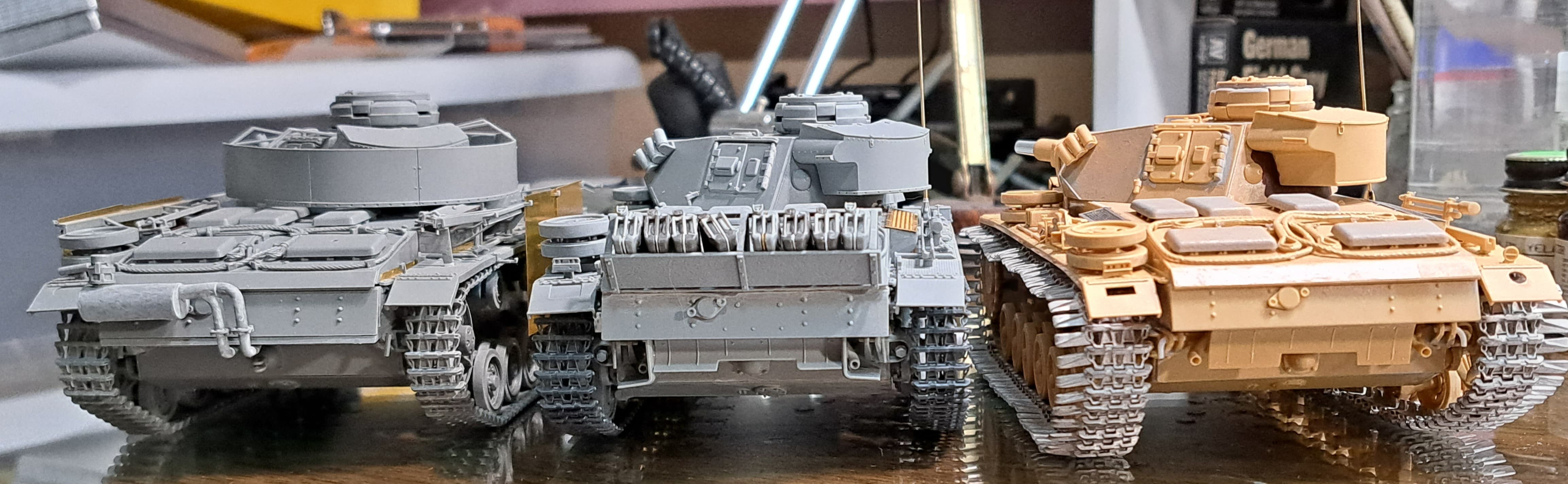

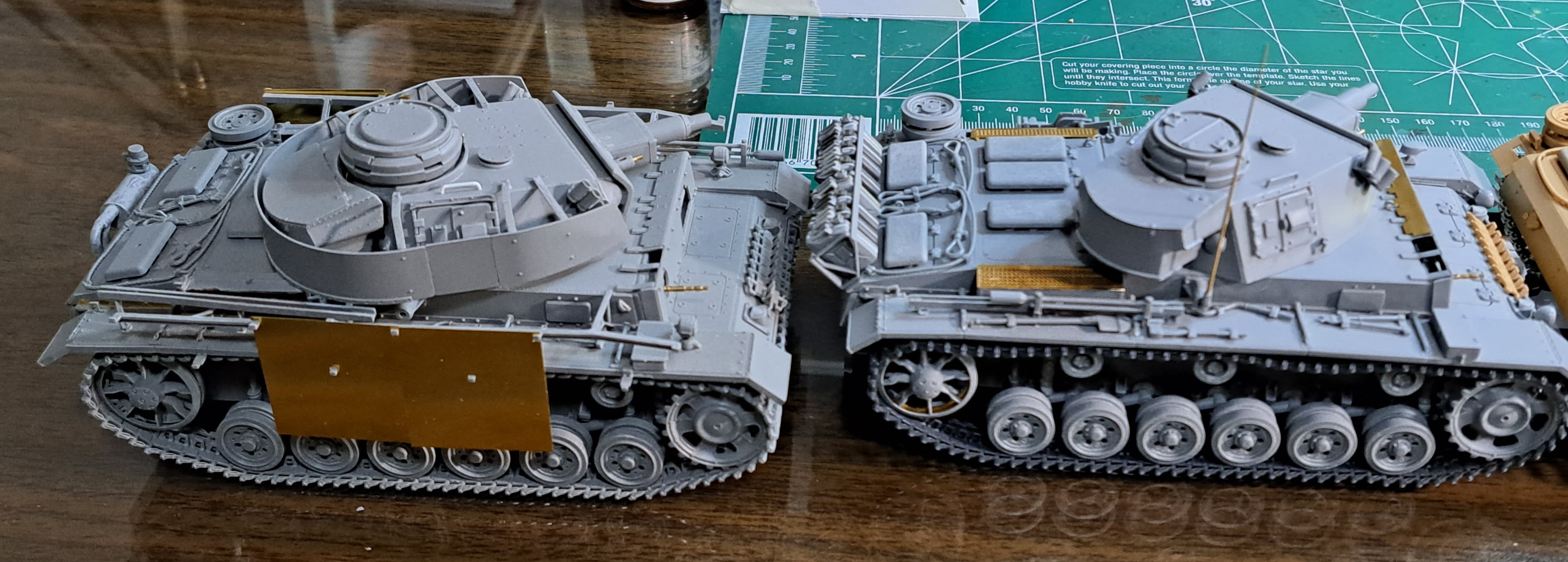

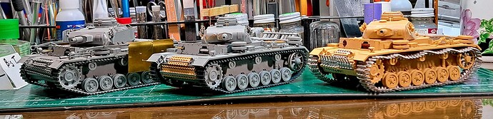

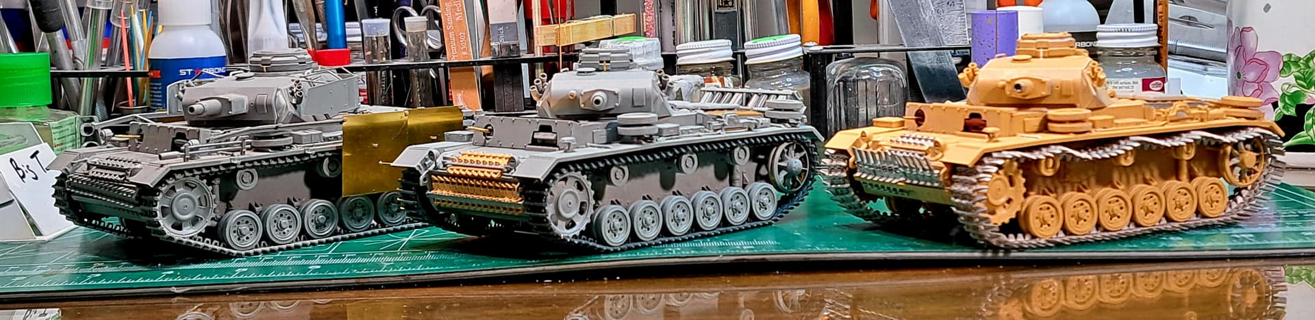

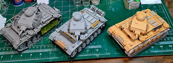

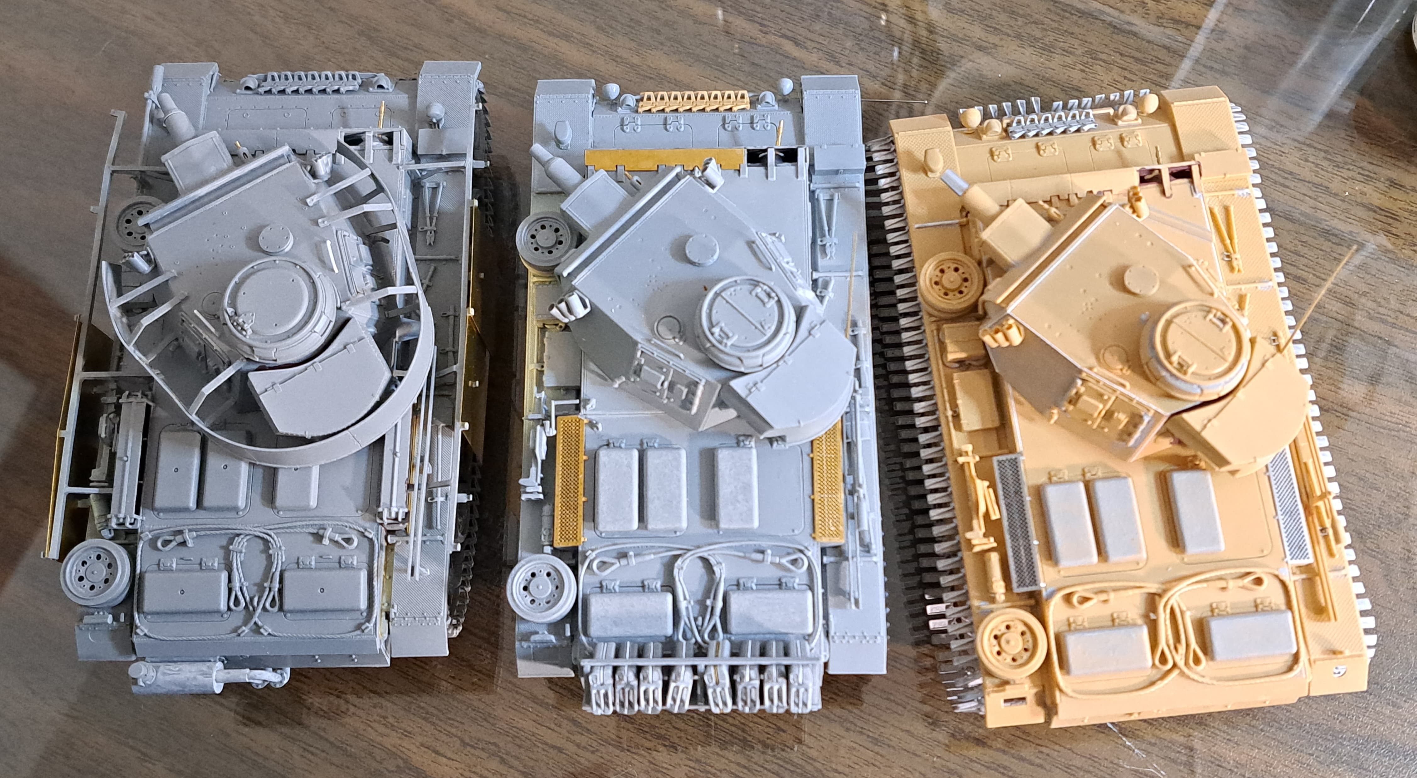

My three stooges…Takom left, Dragon middle and Tamiya right.

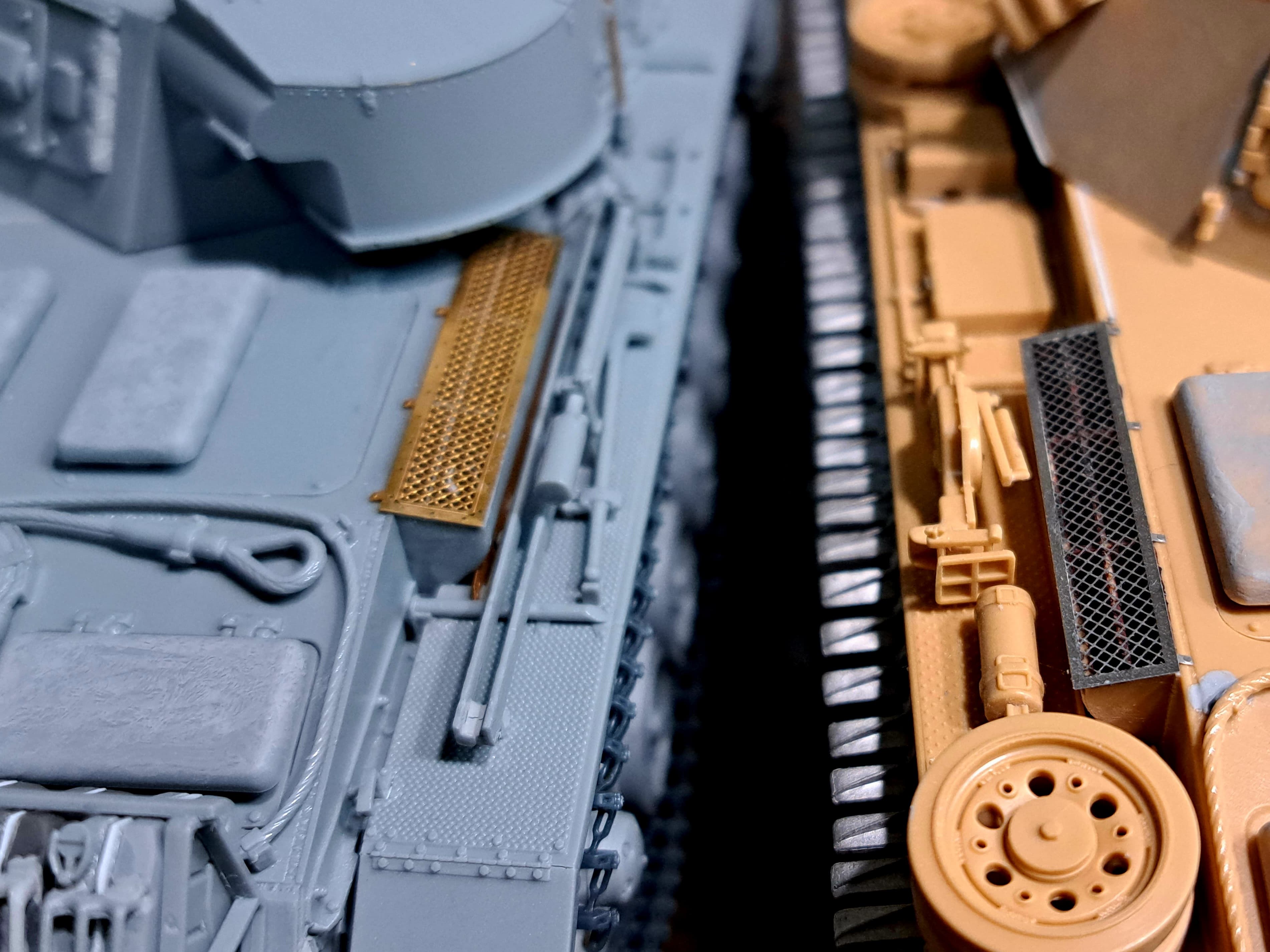

Specific comparison, Dragon’s PE screen rocks compared to the Tamiya PE screens.
Takom then Dragon
I like the Takom PE skirts. I’d pick up the kit for skirts if cheap enough.
Dragon then Tamiya
For me its really between these two. I’d rather build the Tamiya again out of the three so it wins in my book.

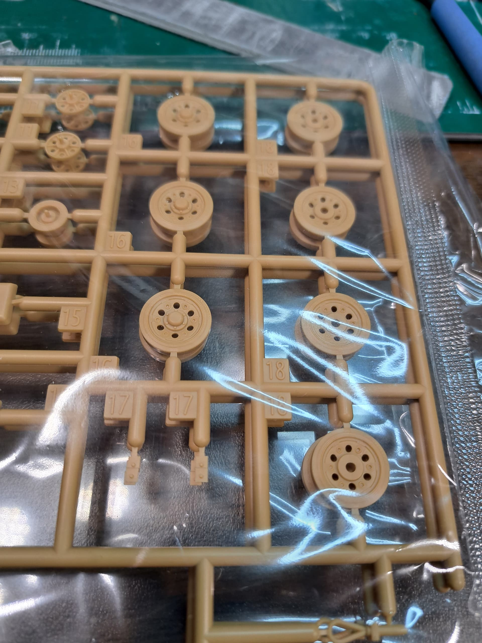

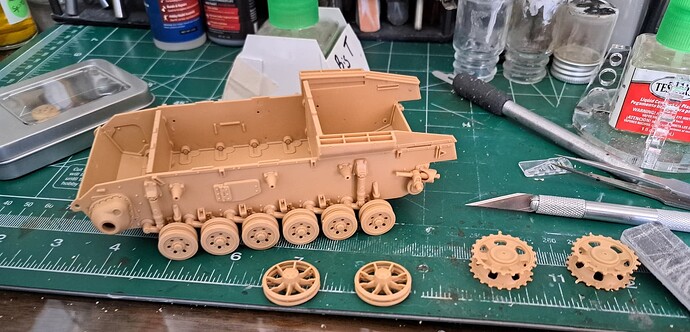

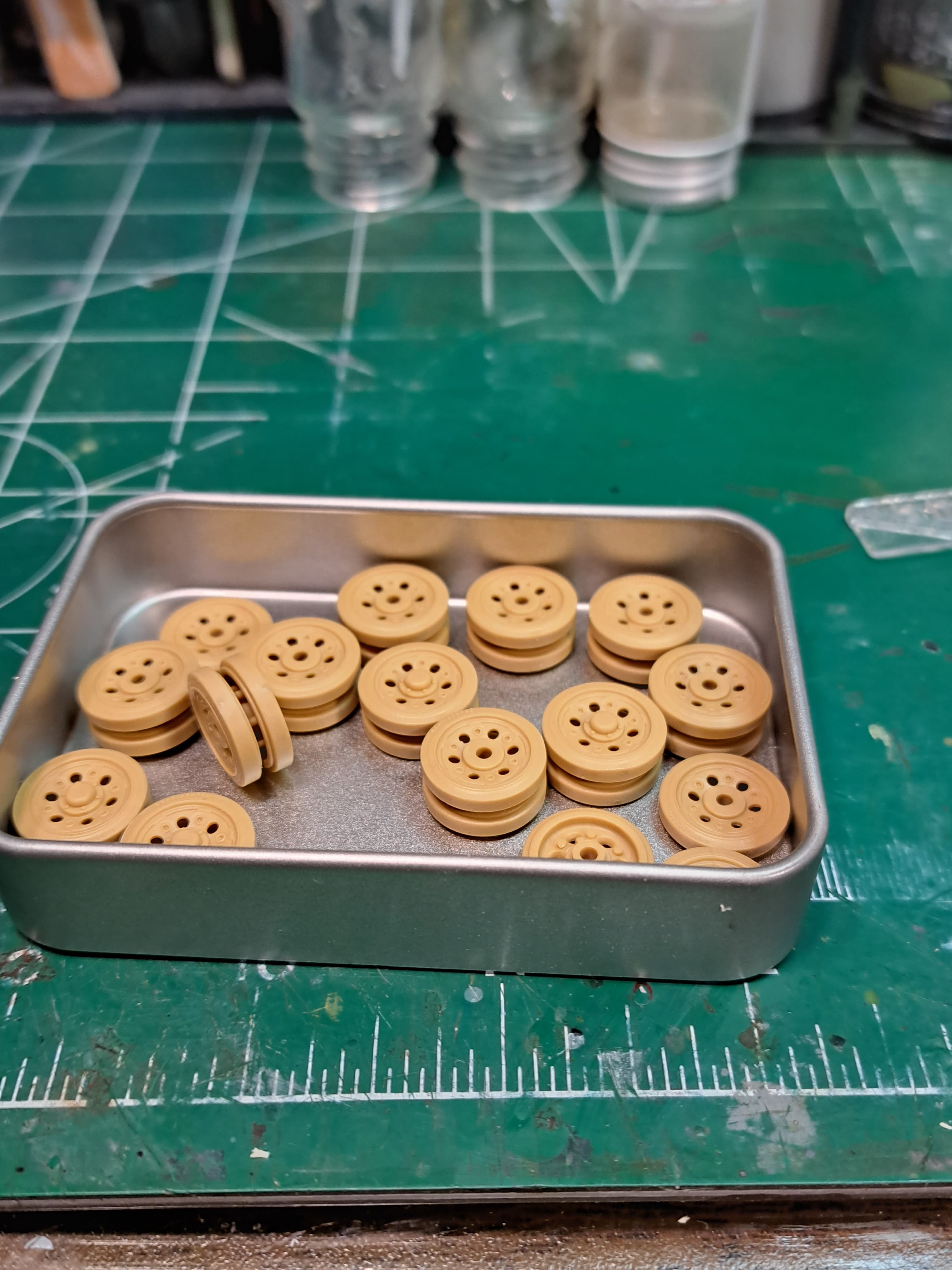

Wanted share kicked off the Academy Pz III Ausf J this evening and started with cleaning up the road wheels because I loathe cleaning up road wheels and like that wrapped ASAP.
Really cool that Academy only needed two attachment gates where most others use four. The wheels are very well engineered with NO mold seam on tires. Pretty shocked Academy pulled that off!
Cleaning road wheels took over five hours on the Dragon Pz III Ausf N. These road wheels were cleaned to the same standard in 45 minutes for the Academy kit.:astonished: :hushed: :open_mouth: :flushed:
I’d budgeted ~ one hour to fiddle with the kit expecting road wheel clean up to roll over into tomorrow. Instead I had time left over.

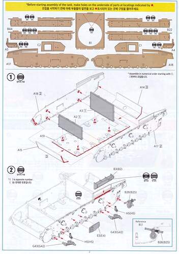

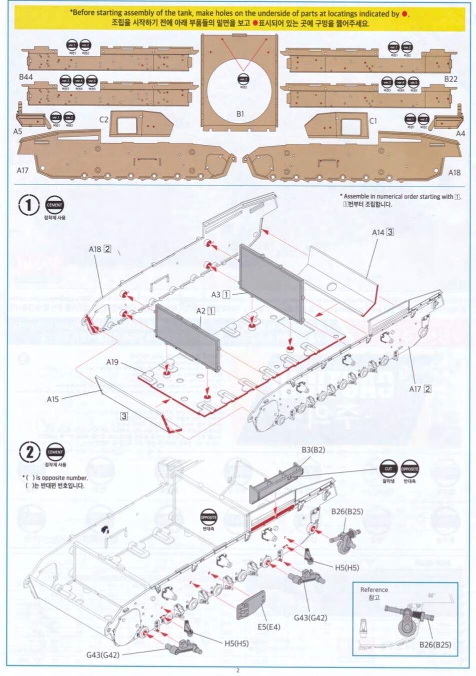

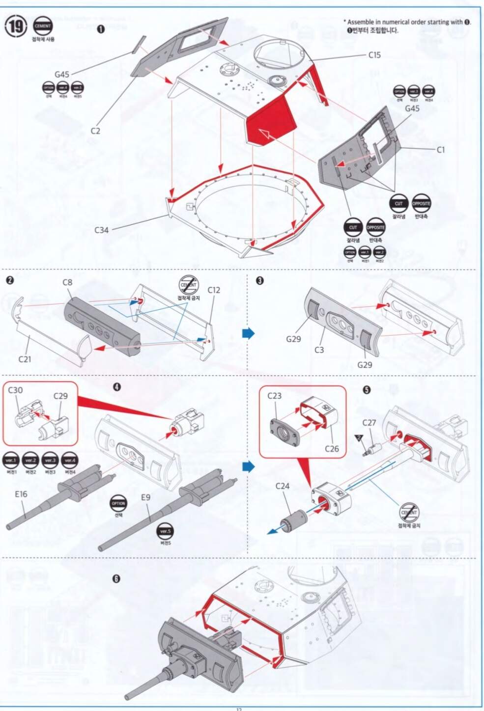

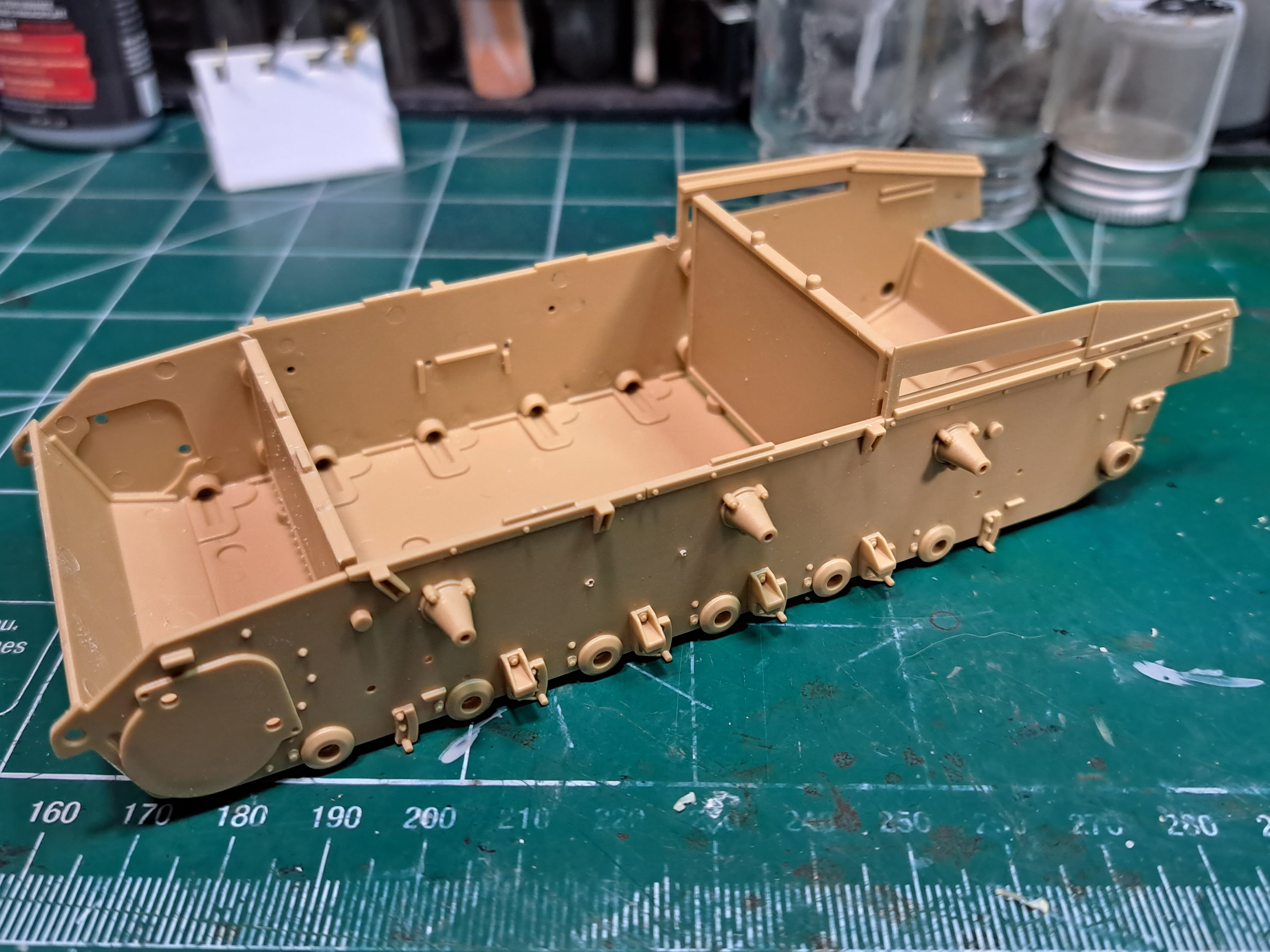

Step 1 - Lower Hull Box - 22 minutes
Academy even suggests the best assembly sequence! Quality instructions? That’s definitely something I’ve NEVER seen in a Dragon kit. A++ Academy. Holes to be drilled out are called for before construction starts in defacto step 0.
The lower hull literally Rolexed together with minimal clean up. Fit was perfect :smiling_face_with_three_hearts: :revolving_hearts:
Will fill the two 1/2 punch marks visible on the inside face of the hull sides at the bow next session.
